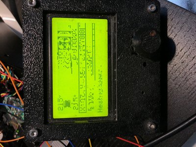

The REPRAP_DISCOUNT_FULL_GRAPHIC_SMART_CONTROLLER I have for the display is a bit garbled, it still works but it's a tad annoying.

Garbled screen:
- Garbled screen.

I did solve the garbled display issue, it was a timer issue that I failed to implement when I was creating the Einsy configuration files in Marlin.

You said you were able to fix the garbled issue with the REPRAP_DISCOUNT_FULL_GRAPHIC_SMART_CONTROLLER. How did you do this, I have the same issue. I'm pretty new to marlin and am having a few issues with the Einsy board. I can't find a place with good documentation on setting it up and taking advantage of its features.

NVM, I got the screen working thanks to the files you posted. Thanks for that. Now I just need to get the end stops working with the trinamic smarts.
