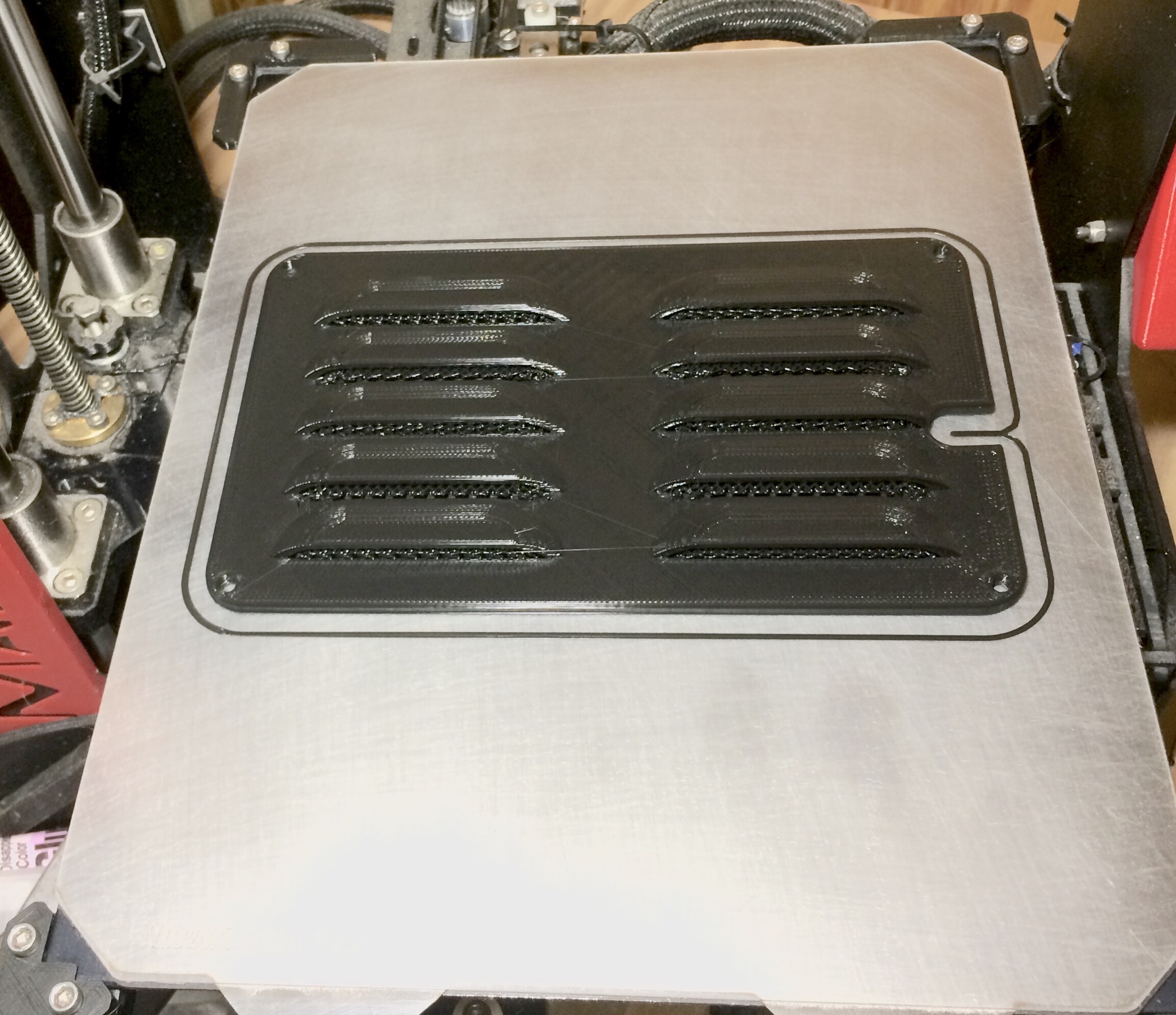

Here is the beginning of a larger print. I stopped it here to pull it up and see if everything was sticking well. It was.
I started the print again and let it run. This was a large plate, perfect for testing the bed as it was intended.
I normally use blue tape over the stock glass bed and have had great success. Although a large print with a lot of build surface contact like this would have me struggling to remove it. I also leave the bed on the printer when removing prints, so all that effort would probably knock my bed out of level.
When this print was done and cooled, I simply lifted the flexible plate off the magnetic base, give it a light bend and off it came! I had printed the new small bed clips on the PEX and they released fine, but a large print like this really shows how effortless print removal should be.

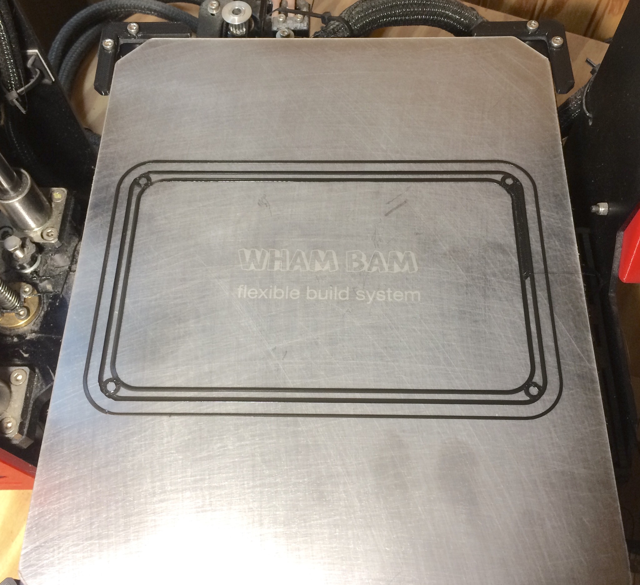

So, there is another placeI deviated a bit from the instructions. I did rub the PEX with the included steel wool, but I wanted more filament grip. So I changed to a plastic scuffing pad.
I used a maroon 3M Scotchbrite pad like these. They are about a 600 grit. It performs about like 00 or maybe 000 steel wool.
https://www.amazon.com/dp/B0002SQYF0/re ... UTF8&psc=1
They make and Ultra Fine as well. They are about an 800 grit. It performs very closely to 0000 steel wool.
https://www.amazon.com/dp/B00MBPTH56/re ... UTF8&psc=1
I love these pads. No steel bits breaking off everywhere and they are embedded with silicon carbide grit, so you get very efficient and consistent cutting action.
Also, about the bed heating, Steel is great heat conductor vs. glass, which is an insulator. I think the Wham Bam bed is superior in speed and dispersal of heat to the stock bed.
As a beta test, this was a success. Other than switch to a plastic vs. steel wool that is the only change I made. The printed clips are not necessary, but they sure are nice to have.
The install was simple. The parts were well made. The instructional video was clear. The flexible bed performs just as it was supposed to. Good job Peter and Wham Bam!
I will update this thread over time so I can report on how it does over the long term, but I feel good about it and have no plans to reinstall the glass. This steel sheet does make me think about installing a leveling probe though, but that is for another thread!

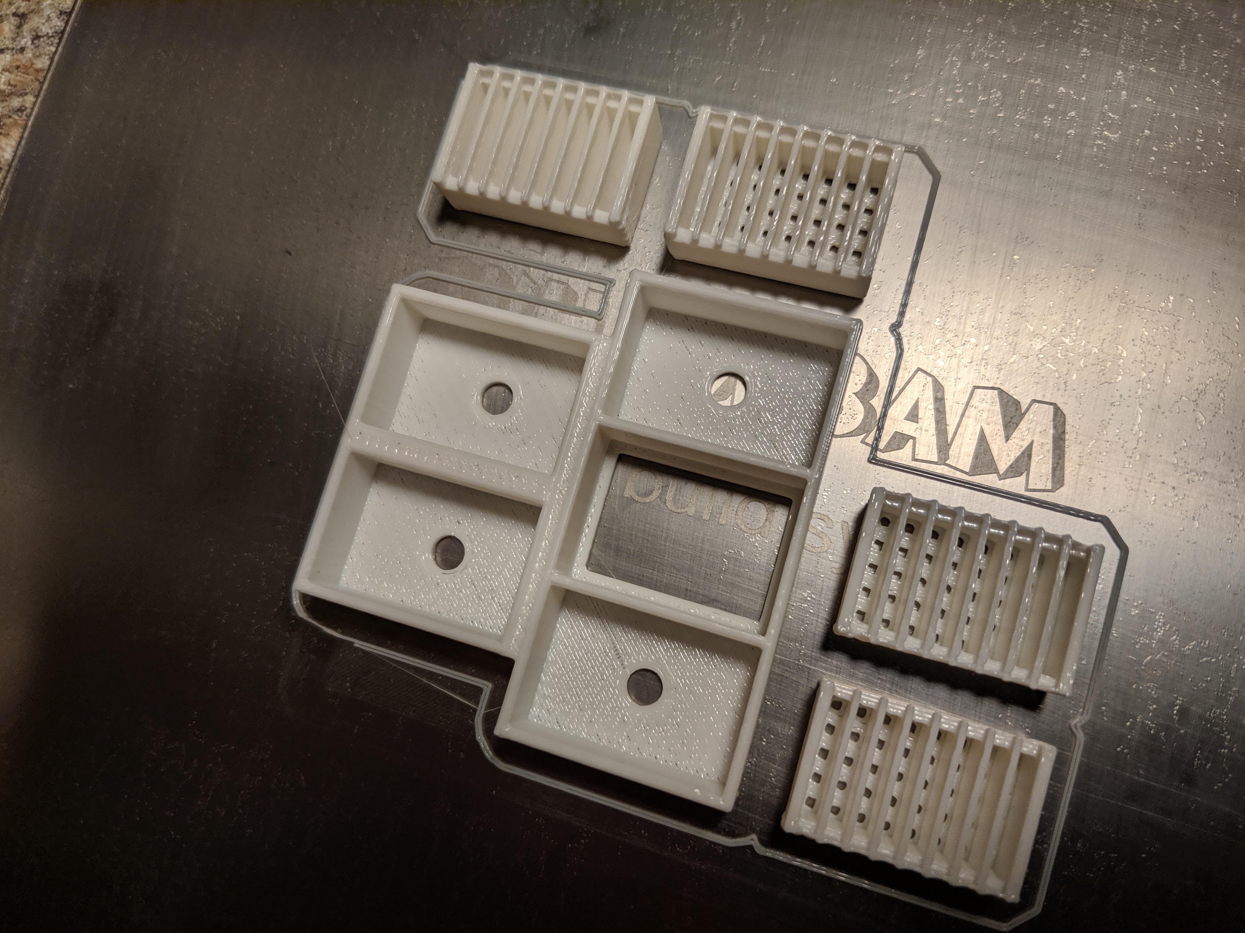

The picture is mid second layer of my next print of a breadboard for ESP8266 modules. I've never tried to print this design before, but there is a LOT of fine detail in the first layer the way I printed this top down. It is very easy for such fine details to not stick to the bed, but with white eSun PLA and a bed temp of 70C the first layer stuck completely. The designer of this model suggested to print it top up with supports, but I think I'll be able to do it upside down without supports because of that ability to get a perfect highly detailed first layer.
I've tried other surfaces before PEI and some of them were OK for a while, but quickly stopped working. If the Wham Ban PEX surface holds up this is going to be really good. The suggestion I'd have for them is to make available a Garolite version of their top surface so I can use it with filaments that need that.

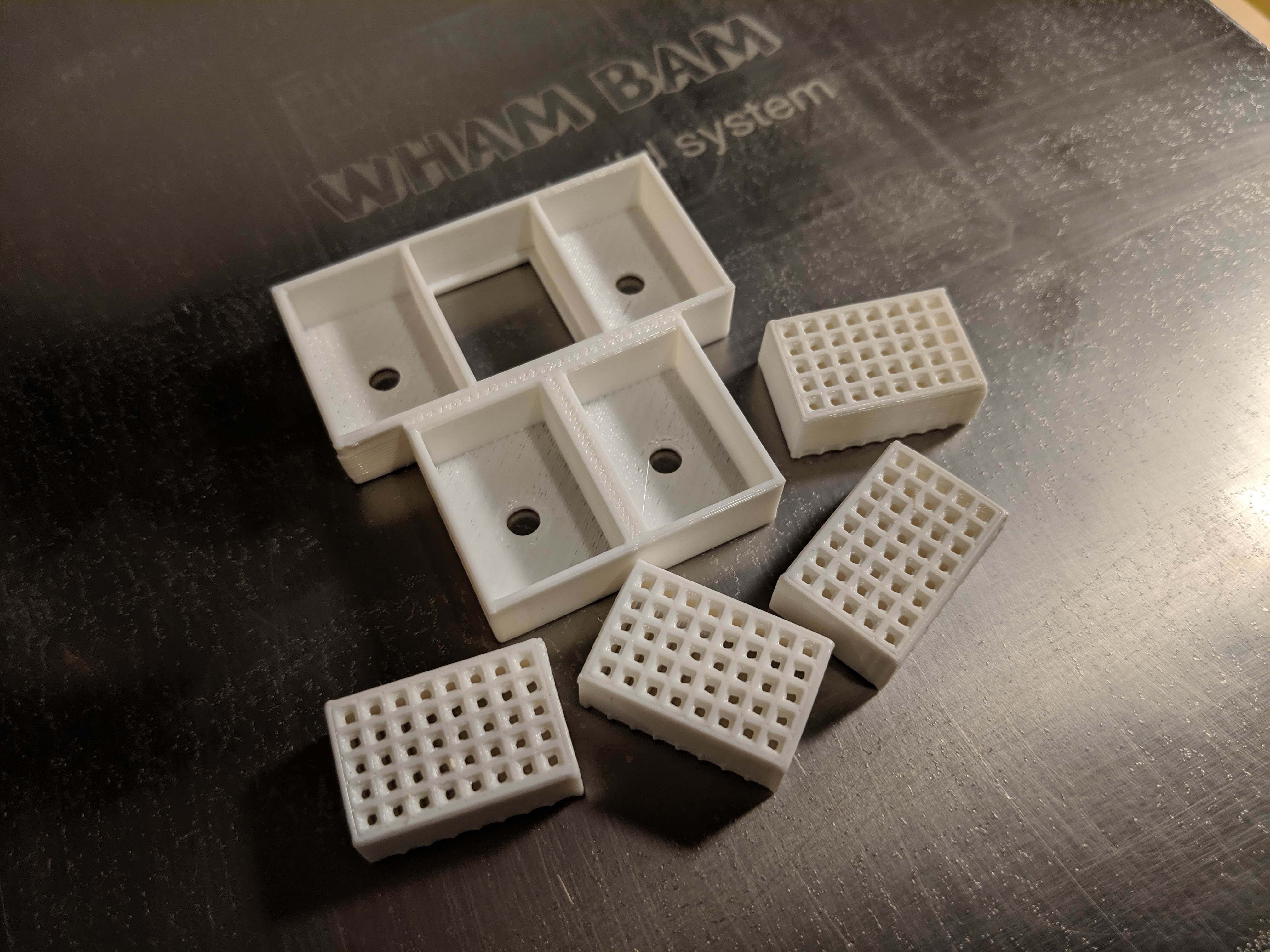

Update: I added a picture of the result. Once the bed cooled down I flexed it and the pieces popped off. I'm VERY impressed with the quality of the top holes and the fact that none of them came off while the first layer was printing. I've actually had problems with this filament in the past, but this came out perfect.
