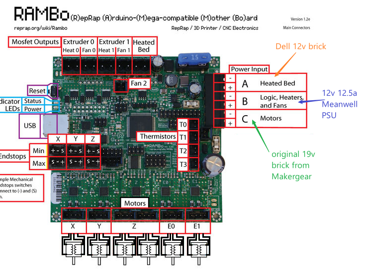

In order to use 12v V6 hotend that I already bought while keeping steppers performance. I can power RAMBo like this, right?

Seems reasonable. Having two separate 12 V supplies may seem excessive, but isolating the logic from the platform heater's killer current is a Good Idea™.
Not running that current through the RAMBo is even better, which is what you're accomplishing with the external MOSFET switch. Good work!
When the time for an overhaul arrives, replace the hot end's 12 V cartridge heater with a 24 V version and be done with it.
