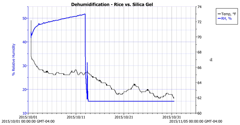

Here's an experiment to see how well rice works as a filament dehumidifier (clicky for more dots):
I put 200 g of rice in a bowl inside a small safe (about 1 ft³) with a gasketed door. During the next 11 days, the humidity rose toward the ambient 52 to 54 %RH maintained by the basement dehumidifier. Afterward, the rice still weighed exactly 200 g, so it hadn't absorbed or released any water vapor.
When I replaced the rice with a bag of silica gel, the humidity abruptly dropped below the data logger's 15% lower limit. The spike just after the drop shows where I opened the door to check the humidity indicator telltale.
Conclusion: rice may fill your tummy and break up clumps in your salt shaker, but it won't do anything for your filament.
