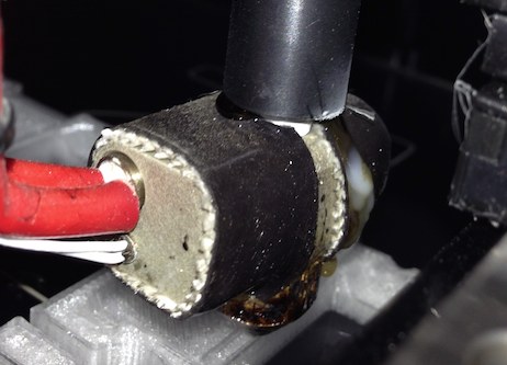

After five rolls of PETG, the V3b Hotend looks unhappy, there is plastic passing through the thread. Temperature is set to 250 °C all the time. Anyone having the same issues?

Post by Jules » Sat Oct 10, 2015 4:45 pm
Yeah, you might want to replace that hotend now. ;)
(If you print a lot of PETG, you might want to consider upgrading to the V4 nozzle.)

Post by jimc » Mon Oct 12, 2015 12:33 am
yeah its just leaking out past the threads. that is the purpose for the thread tape you see on there. you wont be disappointed with the v4 and it really is the best way to go but you can probably just get away with disassembling that one, doing a good cleaning, inspect for cracks or melted threads in the peek. if all is good then teflon tape the crap out of it and reassemble.

Post by Matt_Sharkey » Fri Nov 20, 2015 1:46 am
yeah I had the leaky hotend on my last cleaning, was really confused how it got there, but boy did it.
in fact, PETg has a tendency to go everywhere you don't want it to. It reminds me of super-fluid helium, climbing the walls of the beaker that holds it.
