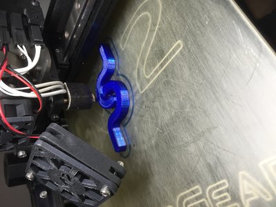

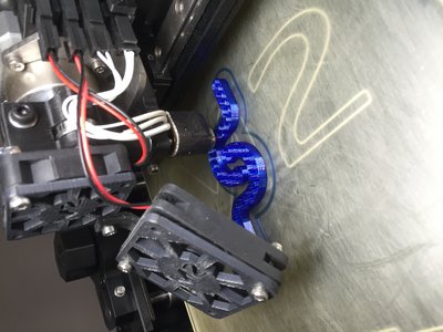

I just printed my first few prints in PETG with your settings, wonderful!
so far so good. using eSun PETG blue
Super! (Those look great!)
