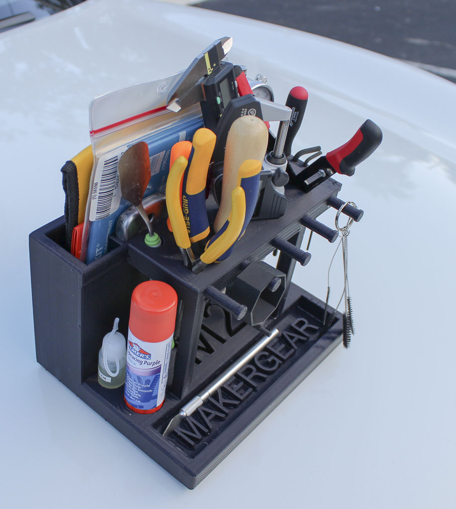

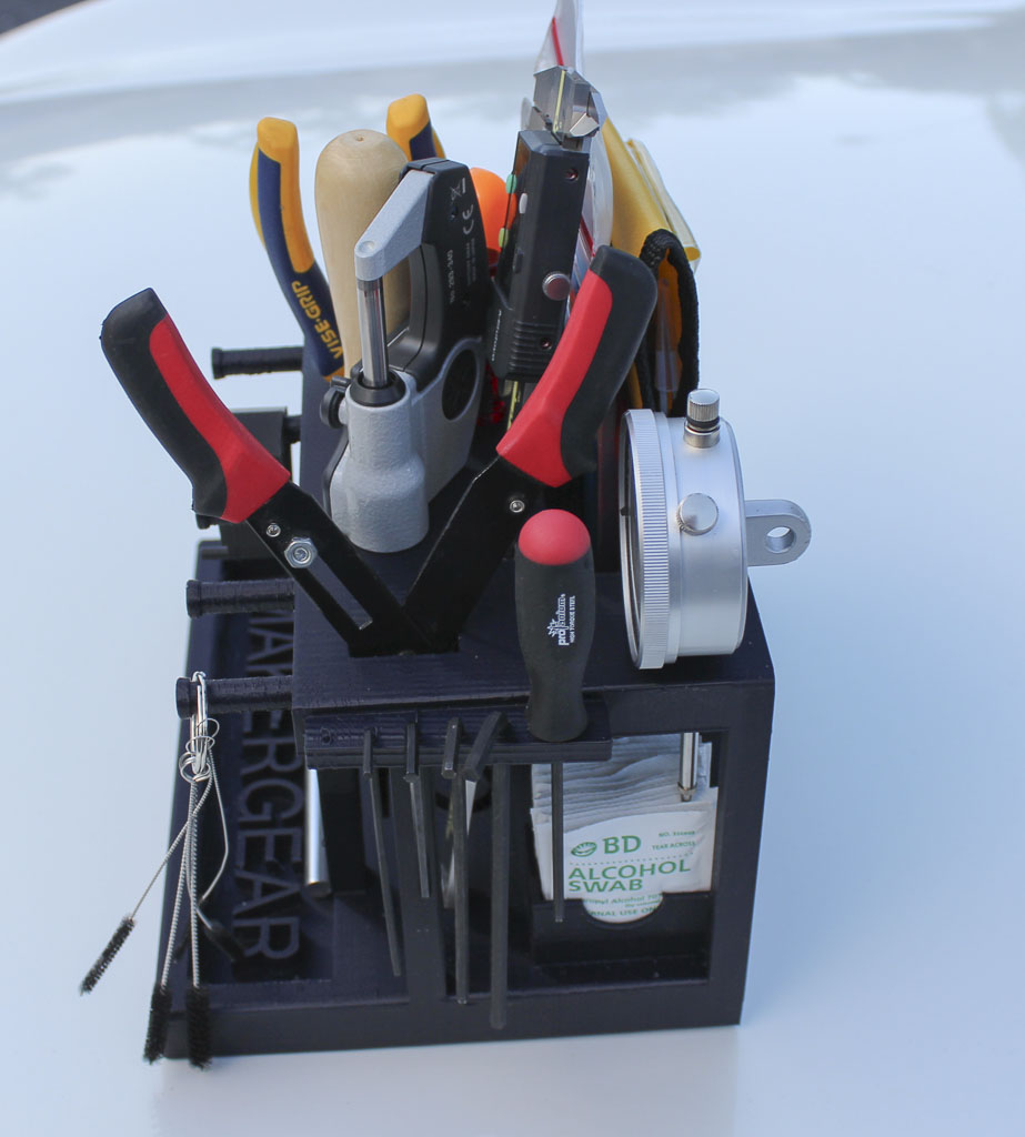

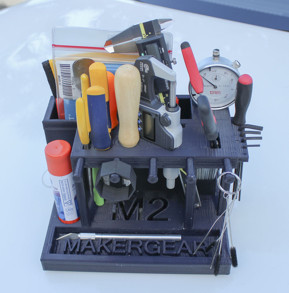

Success!
This thing holds the following:
- Complete set of metric feeler gauges
- Complete set of standard feeler gauges
- Complete set of miniature files
- Razor blade scraper
- 5 spare razor blades
- Alcohol pads
- long needle nose
- standard needle nose
- spatula
- small screwdriver
- wire cutter
- countersink
- dial micrometer
- micrometer
- digital calipers
- wire brush set
- Z stop
- set of allens that came with M2
- canola oil dispenser
- Elmers glue stick
- razor knife
+ room for odds and ends in the back pocket and the front tray!
Really cleaned up the area around my printer at a tremendous cost! :)
Stats from Octoprint. Printed at 50% in-fill Medium PLA with supports
Front View
Right Side
Left Side
I'll probably never print anything this big again, but had to try it at least once. :)
The only issue I had was a couple of loose strands and something kind of weird that I can only describe as "ghosting". Anyone see that before? Its like it did the feet and there were concentric circles in one direction. Not really extruding out but kind of like "ghosts" of the actual extruded foot. Noticed this ghosting in the area of the letters as well. Didn't take a picture but will try to later.
I'll try to add a timelapse to the post later on.
jdacal
Re: Going to run out of filament near end of print!
Post by jsc » Tue Aug 19, 2014 2:40 am
Reduce X/Y acceleration down to 1000 or 800 to reduce ghosting.
Search for "M201" in the M2 tips thread: viewtopic.php?f=3&t=12
jdacal
Posts: 466
Location: Florida
Post by jdacal » Tue Aug 19, 2014 5:12 am
jsc wrote:Reduce X/Y acceleration down to 1000 or 800 to reduce ghosting.
Thanks, I found it in the S3D start code settings. X was set at 1200 brought it down to 1000.
