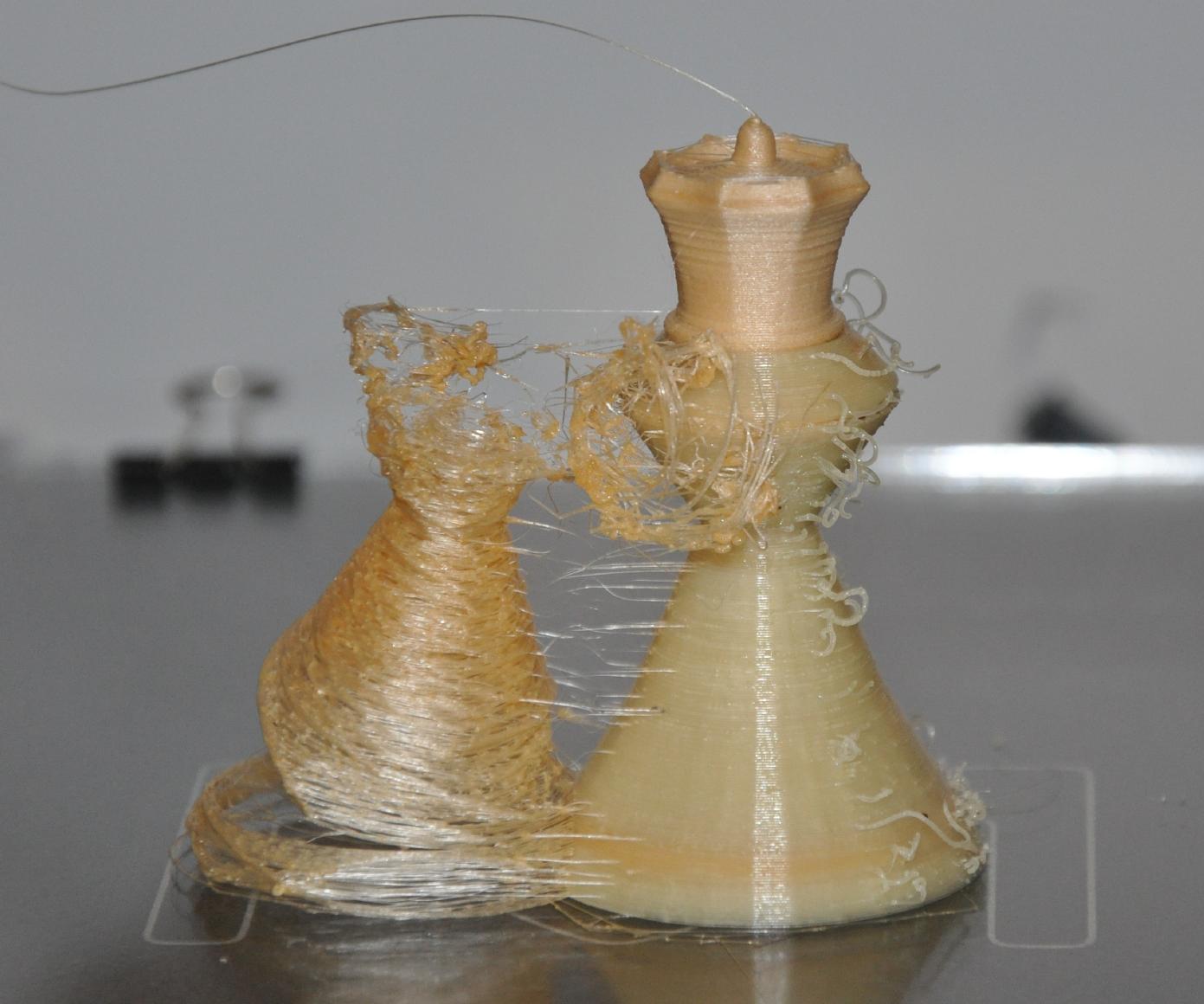

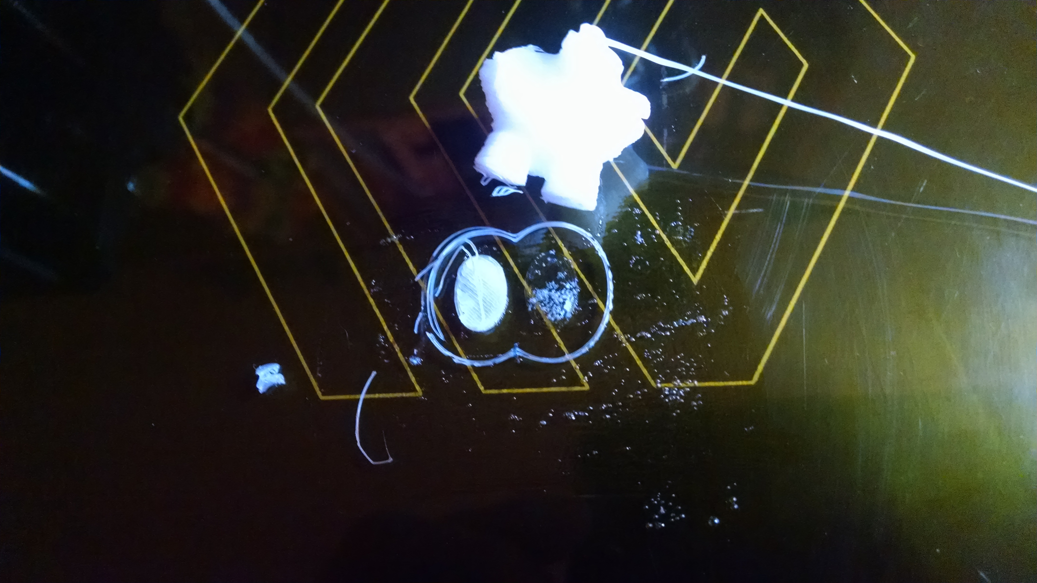

Here is the part after printing. The PVA has certainly done its job as an ooze shield!
How stringy is wood filament?? So stringy that it created an entire replica of the support structure off to the left. . .

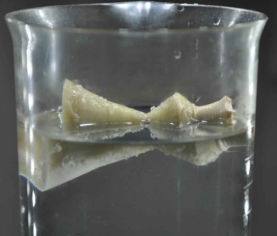

Soaking off the PVA in a beaker of water.
Soaking it up. . .
I have not cleaned up the print yet; will post a picture later. One issue with wood filament is that it gets wet when you soak it. Maybe not the best thing to use with PVA, in retrospect.

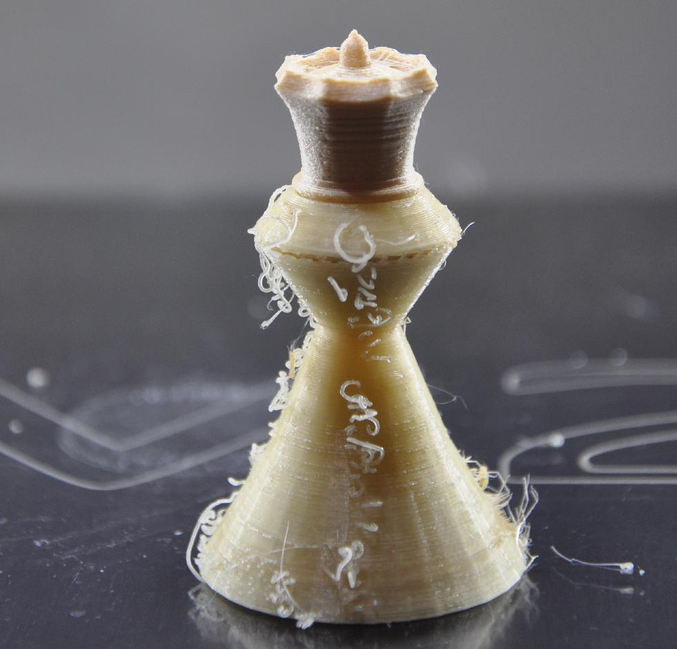

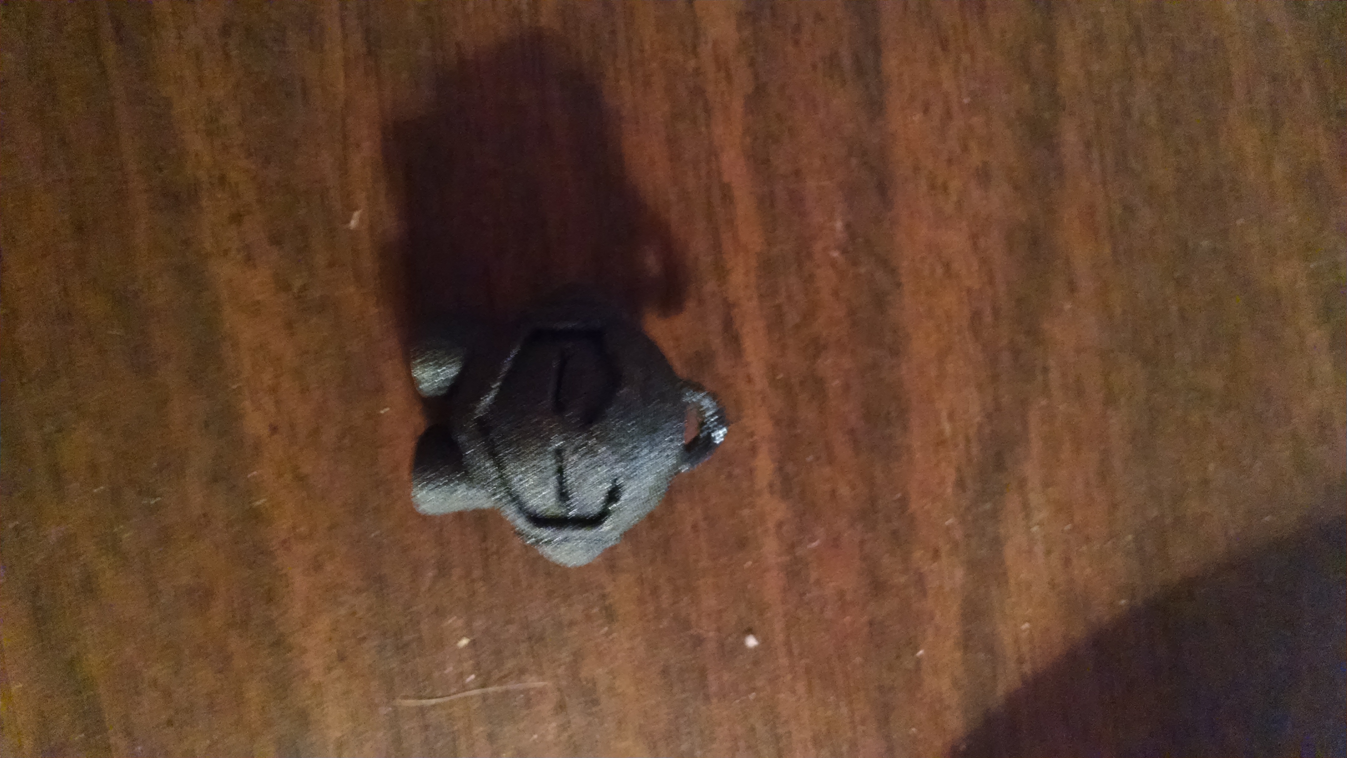

(edit:) The PVA completely dissolved overnight, left nothing but a white residue at the bottom of the beaker. If I had been a bit more patient, I could have avoided cracking my print. The finished print (see photo) is clearly missing the material that oozed out while the extruder was inactive. Possibly I could make up for that with extra restart distance, but it seems to take a long time to get back to a normal flow rate. I guess the lesson here is don't do dual extrusion with drippy filaments.
Finished piece. Quality suffers greatly from the amount of wood filament lost to oozing.

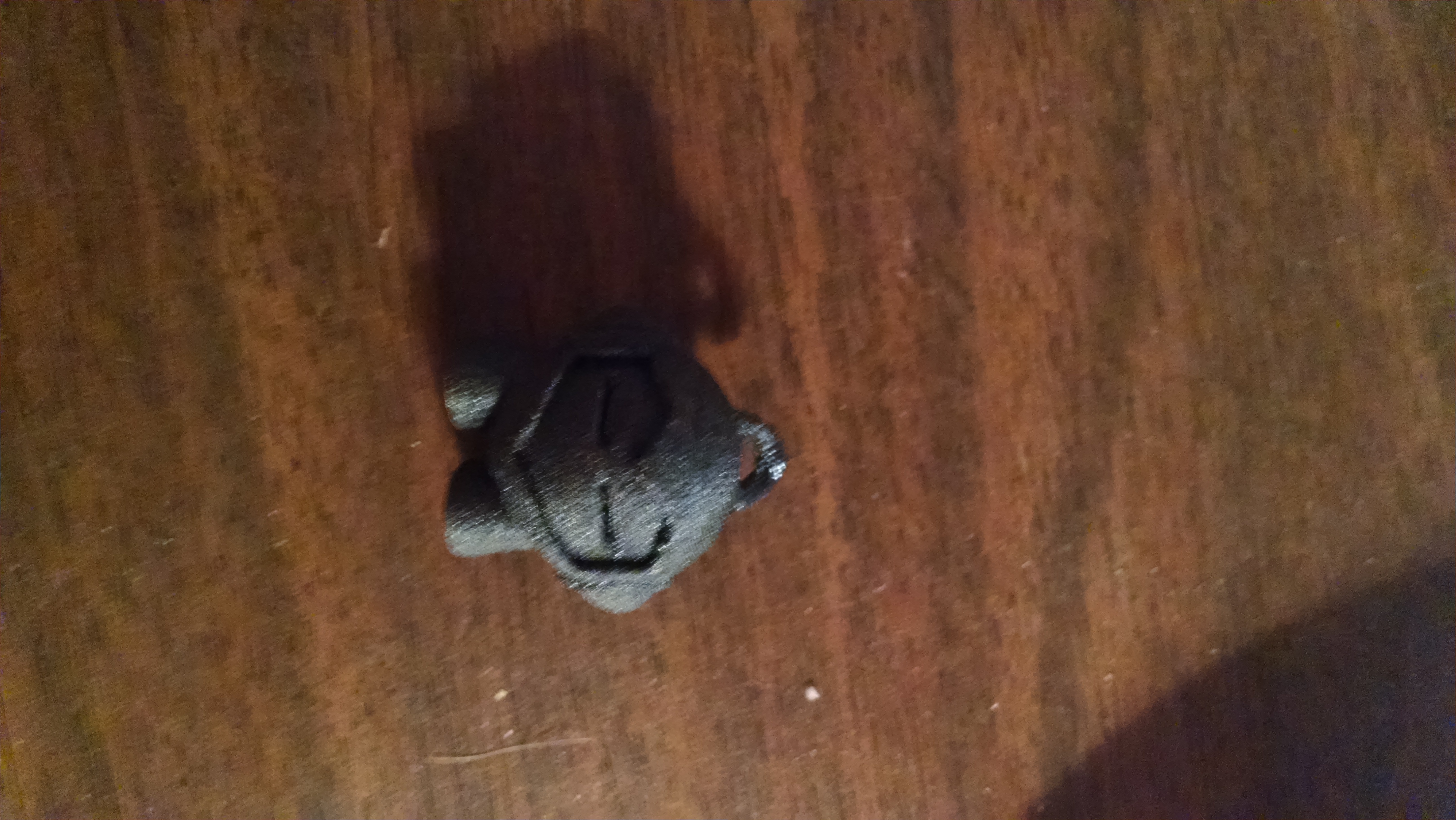

CF ePA requires substantial drying, and I didn't do that with this sample. It was foamy but printed well once I found the right bed treatment. The end piece is very stiff, I like this stuff more than the regular ePA, but we'll see how much more expensive it is.

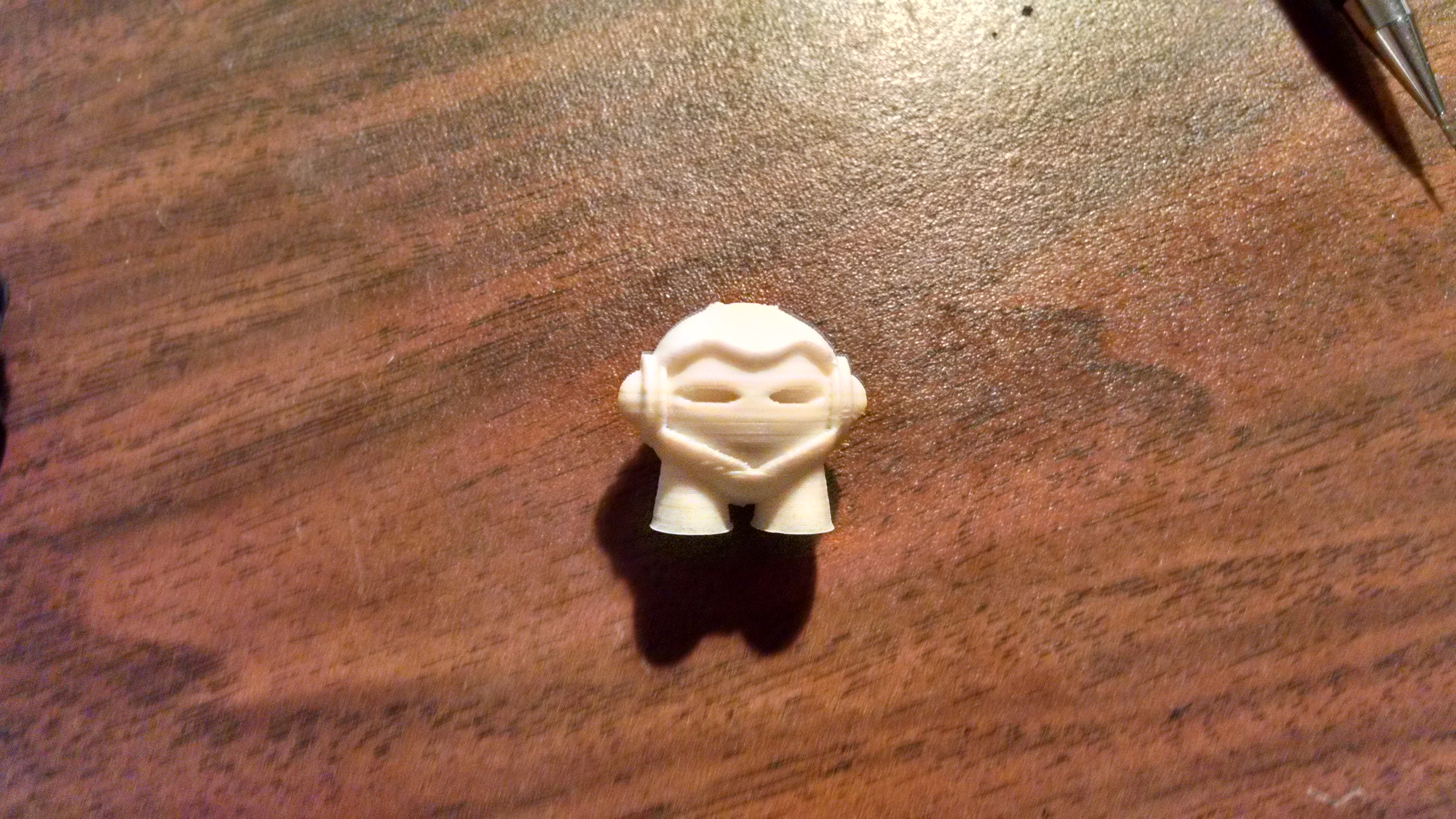

Filament was manually swapped during the print. The glow is muted but visible. The Hatchbox is brittle but printed ok.
This is a bottle prop from Fallout 4.

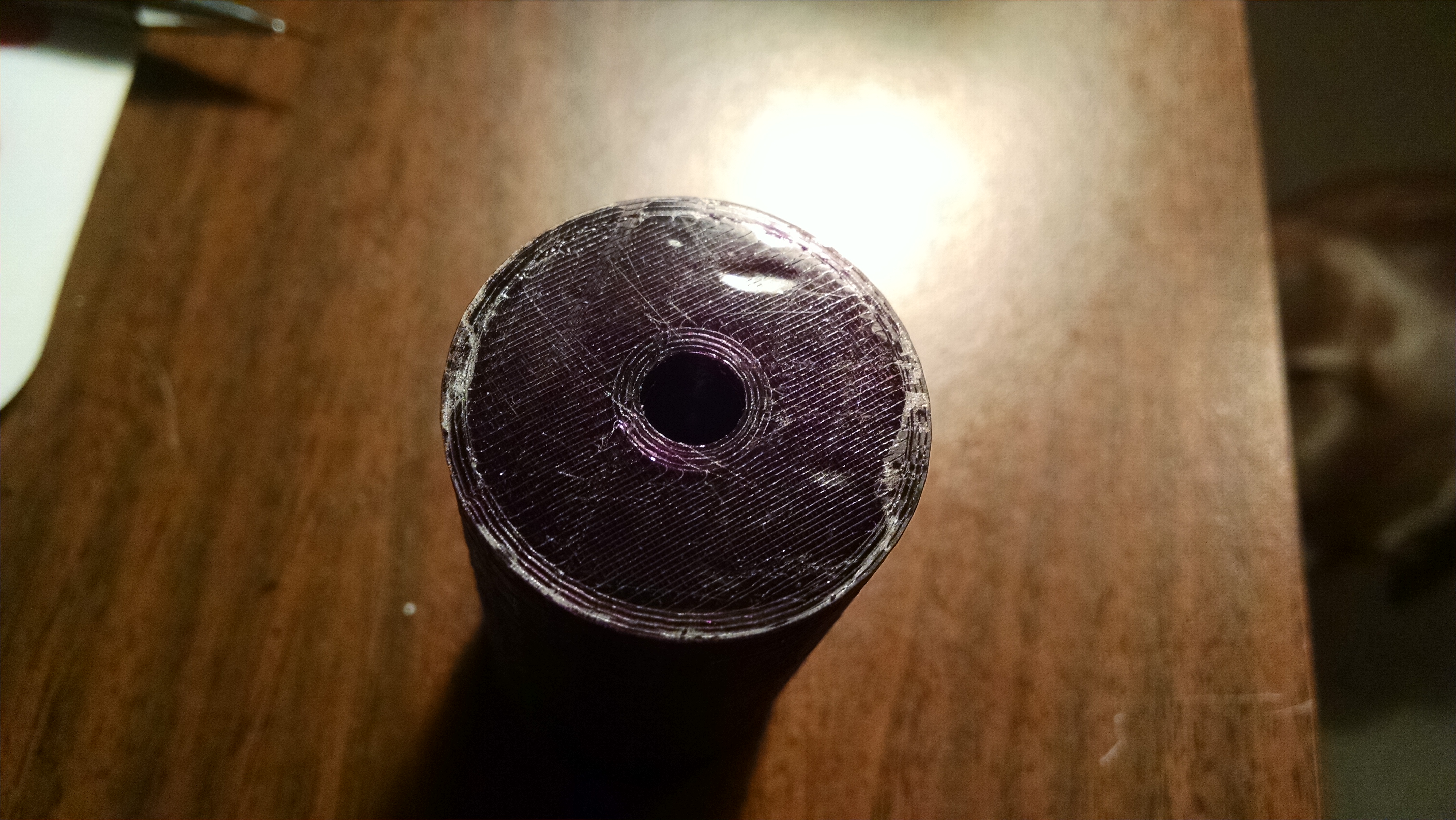

I did not have the best luck with this stuff. I will try again with a higher temperature, as I had delamination between layers. I also had a really weird thing happen, as you can see from the picture. I got bubbles in my Kapton tape beneath the part, which caused dimples in the part. I popped the bubbles with a knife, and the tape sealed pretty well, but what the hell caused that? The ABS slurry was quite dry and not that thick. The bubbles only appeared directly beneath the part.

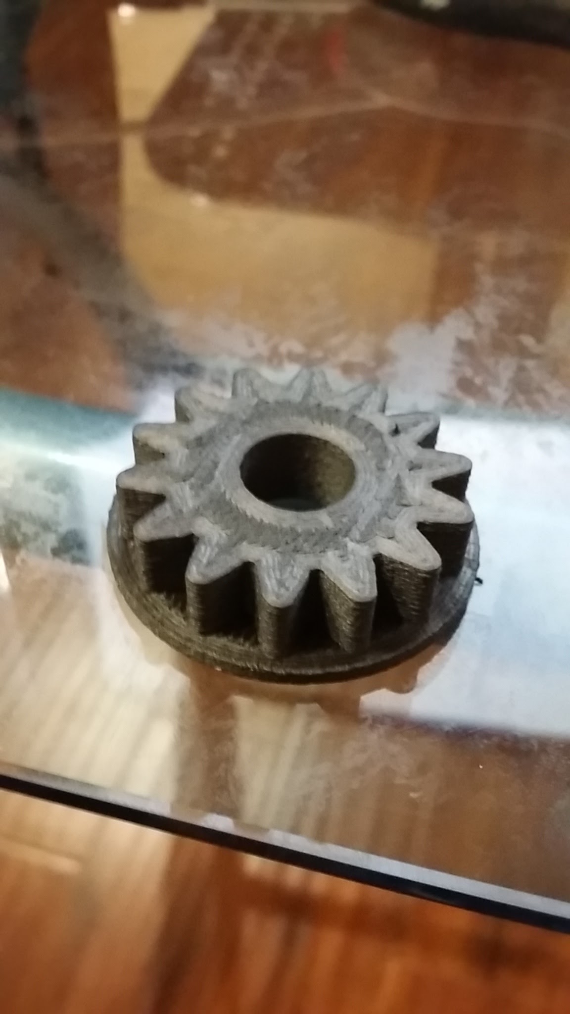

Filament name: CF Nylon
Filament vendor: 3DXTech
Hotend used: V4 PTFE
Nozzle diameter: 0.35mm Steel
Layer height: 0.2mm
Printing temperature: 260C / Bed=45C
Other information: Print on glue stick.
Great stuff! Very stable, little/no warping, does give off an odor, very tough and strong.
