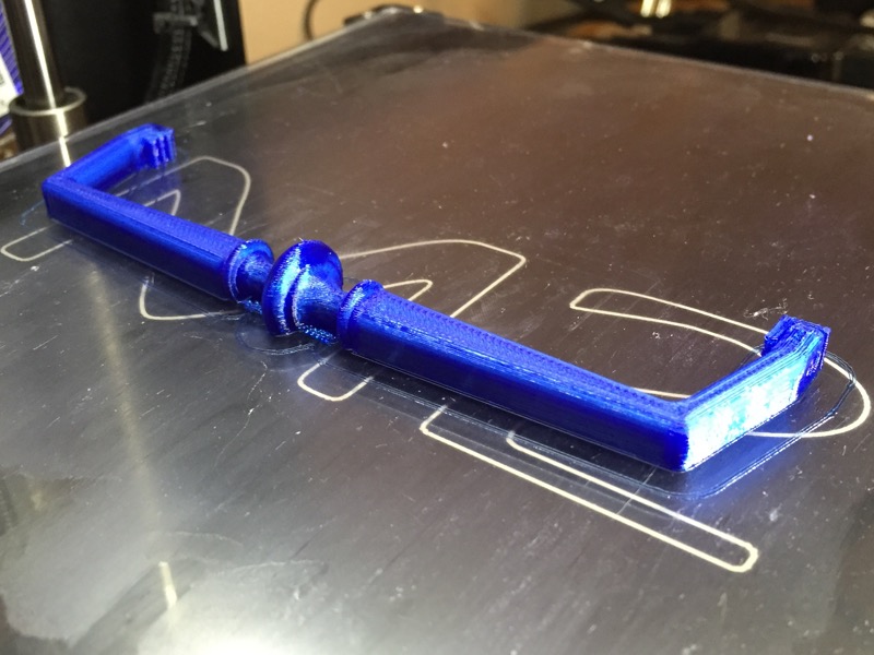

first PETG print
The drawer pulls I printed in PLA tended to snap at the stress points after a while, so I decided to finally unpack my PETG roll and try it instead of redesigning the part. Went back through this thread for some insight on temps, and chose 250/100. Bed adhesion was good, but next time I might try 255 as I got a few missed perimeter threads around the inside corner in the upper left, where the thread didn't adhere and cut the corner. Looks very nice, printed beautifully, and hopefully will be tougher than PLA.
- drawerpull.jpg (110.97 KiB) Viewed 14406 times
