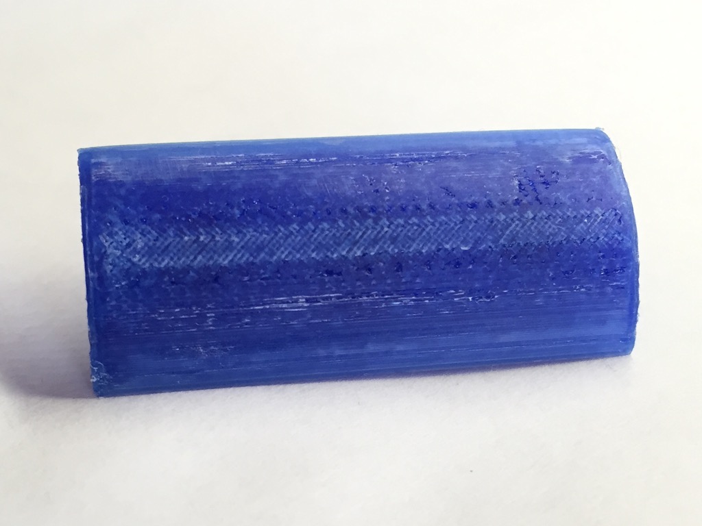

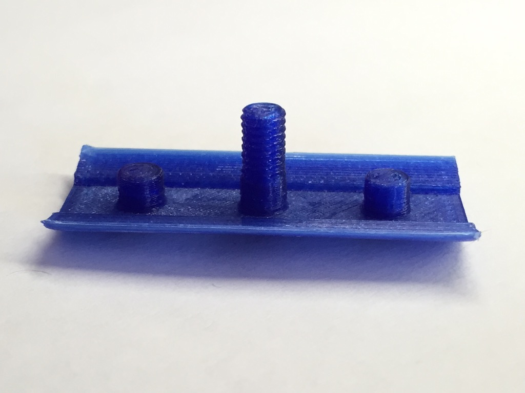

Thanks. I think I'm getting the hang of it. Slowing the print down helps a lot for tricky prints.
Here's my latest attempt. A tricky print as the curved top side must be printed bed down fully supported. Curved side was sanded; sadly, I don't think PETG sands any nicer than PLA.
