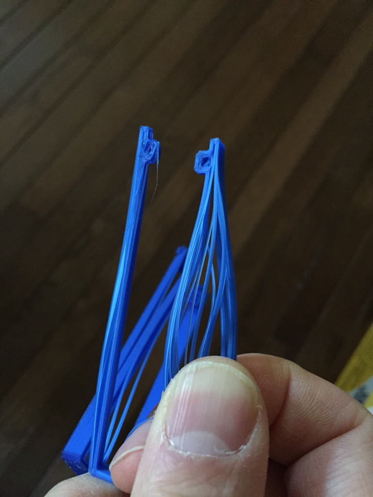

I've started running into some PETG layer bonding issues. I saw a wall crack as it was printing and stopped the print. When I took it off, I could separate each strand by hand, like a hank of hair. The only change is my new super powerful fan and shroud. So maybe PETG doesn't care for tons of cooling. I'll try it without the fan.

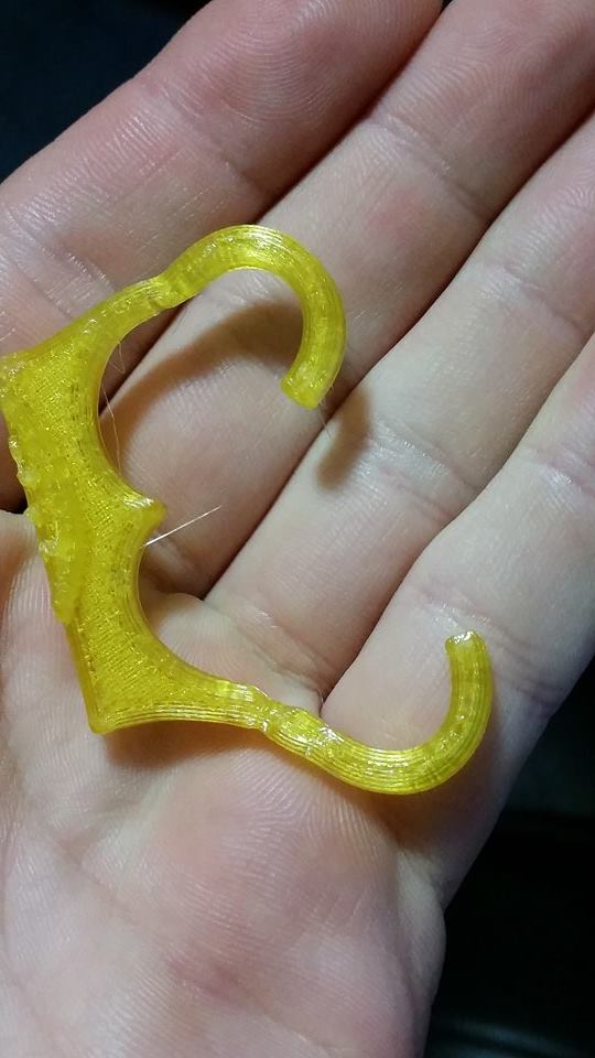

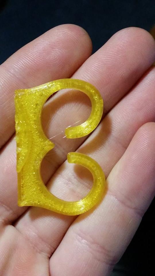

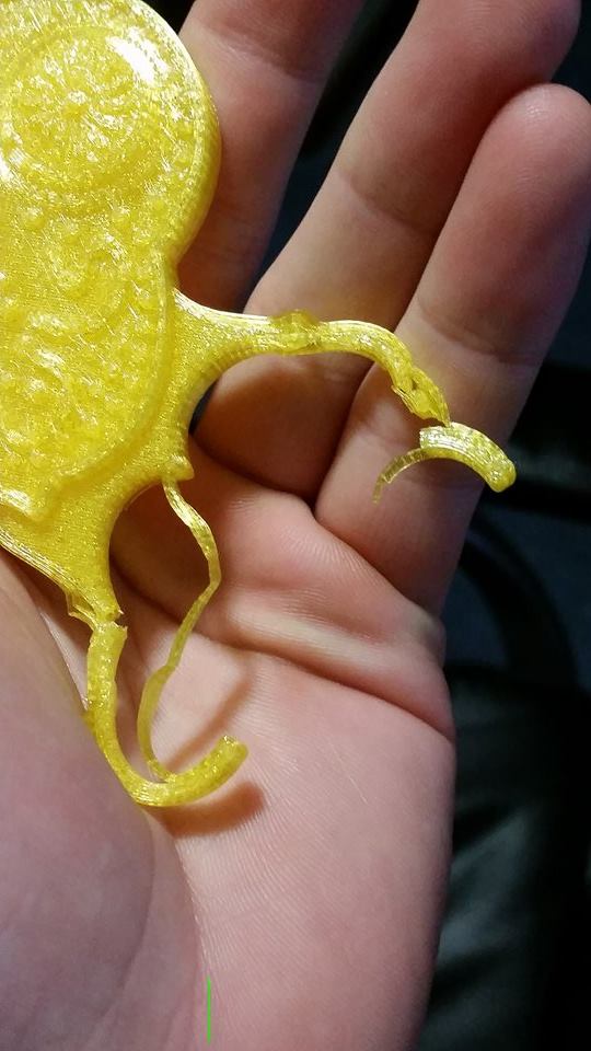

Extruder calibrated at .40mm, no change in filament diameter, no fan running, pinrint at 255°C, adhesion problem between walls.
Increased extrusion multiplier 10%, that problem goes away.
The first picture is how it should look, second picture is with lower multiplier (after putting a load on it), last picture with 10% multiplier increase (after putting a load on it).
So maybe I need to adjust my multiplier for a wider thread (extrusion diameter).
