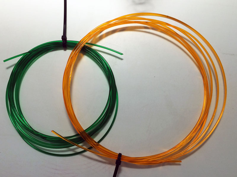

sneak peek at the green and orange. the green is a little brighter than how it appears in the pic
