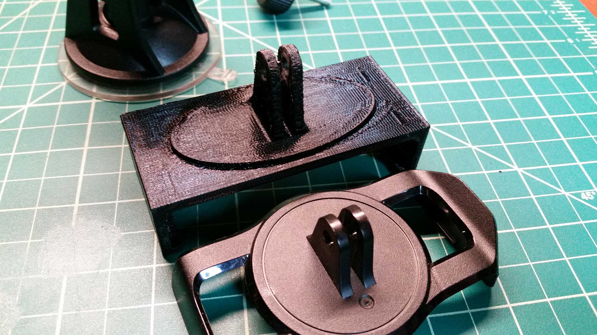

I was in a similar situation a month ago when I wanted to design a replacement GPS bracket to hold my phone instead of the GPS unit. It's held up in 95F (35C) outdoor temperature inside my black vehicle in full sun. I didn't measure the internal temp (yetDeCav wrote:I'm working on a part that would live in a car's glove compartment.
I read that glove compartments can get as hot as 66c.
Do you guys think PETG can survive for an entire summer in a glove compartment without warping?
Printed in eSun solid black PETG:

That sounds very reassuring!Hugs wrote:I was in a similar situation a month ago when I wanted to design a replacement GPS bracket to hold my phone instead of the GPS unit. It's held up in 95F (35C) outdoor temperature inside my black vehicle in full sun. I didn't measure the internal temp (yetDeCav wrote:I'm working on a part that would live in a car's glove compartment.
Do you guys think PETG can survive for an entire summer in a glove compartment without warping?) but I'm sure it gets up to 150F (66C) inside and the part shows no signs of degradation.
