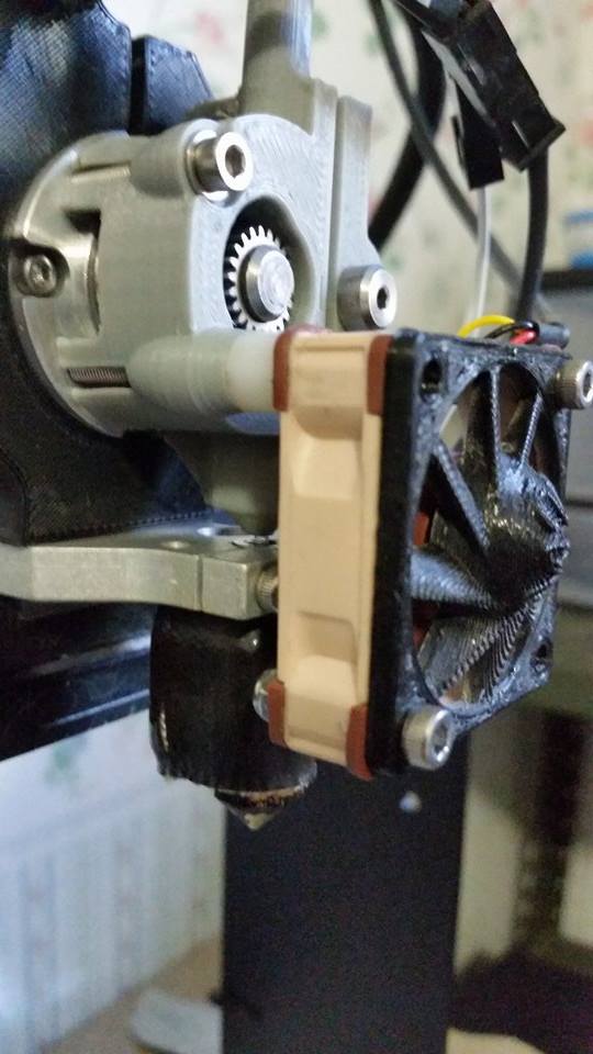

Rsilvers, do you have a photo of your fan configuration?
After reading about heat creep with PETG, I decided to move my main fan lower. It seems that having the fan closer to the hot end would help with that.
I was just curious about how yours are set up.

Post by jsc » Thu May 07, 2015 3:08 pm

Post by jereywolf » Thu May 07, 2015 3:37 pm
Wow, that's pretty wicked.
