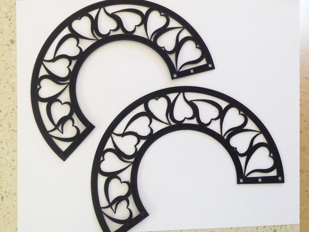

Same file printed in PLA at the top and PETG at the bottom. I deliberately chose one that did not run in linear patterns to force the nozzle to jump around to test my settings. No stringing worth mentioning. You can't even see the pattern on it unless you hold it up in the sun. My question is, are the little occasional edge boogers normal to PETG and ABS because of build up on the nozzle? (There weren't very many, but it does add that bit of extra cleanup, and if it's one of my settings, I'd like to fix it before saving the profile.)
The other question relates to overhangs....they are a bit sloppy at the top. (You can't see it on the photo - too small.) The little tags on that file have a fairly stiff overhang - not quite 45°, so i printed it without support. Would hitting it with more fan help that out the way it does with PLA? Or was I running too much fan (60%)?

The boogers are generally due to nozzle buildup. Are you running an increased infill extrusion width? The build up seems to mostly happen during infill, and increasing it (but not too much) seems to help there.

jsc wrote:The boogers are generally due to nozzle buildup. Are you running an increased infill extrusion width? The build up seems to mostly happen during infill, and increasing it (but not too much) seems to help there.
I found that running the fan full blast completely destroys layer adhesion, so I've been leaving it off.
Had to go back and check, but yes, I had infill width at 120%. Should I lower that or raise it a bit?

nothing wrong with 120. thats fine. its just when people go and set it to 170-200% or something like that. petg is sticky so any strings or overextrusion loves collecting on the nozzle. it tends to get these little micro fine hairs during jumps. this collects on the nozzle as well. a little more retraction and bump the temp down 5 deg at a time. as jin said, infill can be a contributor to the nozzle boogers. i found that if the infill does not go down nice and perfect and its broken or jagged then the parts sticking up end up on the nozzle. adding a little extra infill width usually cures this with s3d. just dont add too much. 120-140% is good. petg is a great material but its not as forgiving as pla. that window where it prints really nice is much smaller so you gotta dial it in really well.
Re: esun petg
Post by Jules » Tue May 26, 2015 11:46 pm
Thanks Jim and Jin! :D (I'll try 130% as a compromise.)
