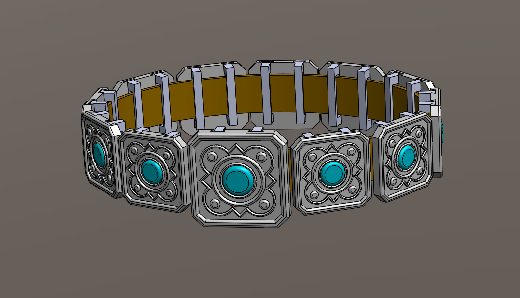

I did get a few of the applicator bottles and tried to use it like that, but the pieces I was trying to glue were not both completely flat. Actually one surface was printed flat on the bed and the other was printed over support.
When I used the glue straight from the bottle it didn't have enough contact to bond the pieces.
I don't have a good photo of the print, but here is my model. There are two tabs that slide into the back of each pendant. The slot in the pendant had to print over support, so it didn't leave a clean flat surface.
I just found the Weld On "medium body" stuff in a tube. I really liked using a thick ABS/acetone mix when I printed mainly with ABS.
