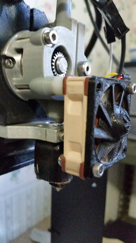

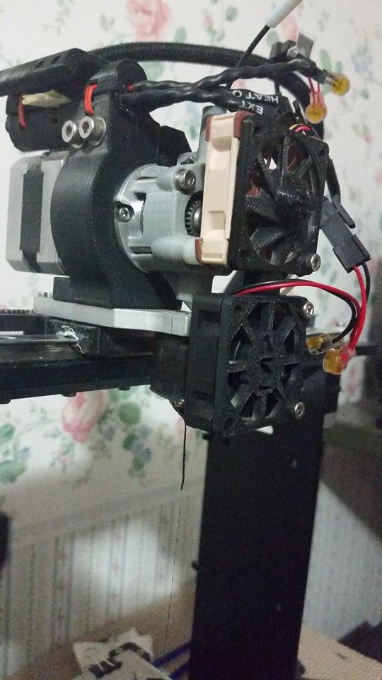

I was having quite a bit of trouble with PETG and jamming and finally narrowed down my problem.
Now that I changed from one fan to two, I'm printing with no problems. :)
OLD SETUP
NEW SETUP
Re: esun petg
Post by jimc » Fri Jul 03, 2015 4:32 am
hmmm yeah i think jin said those noctura fans dont move much air. thats a damn nice fan guard on the top though! :mrgreen:
