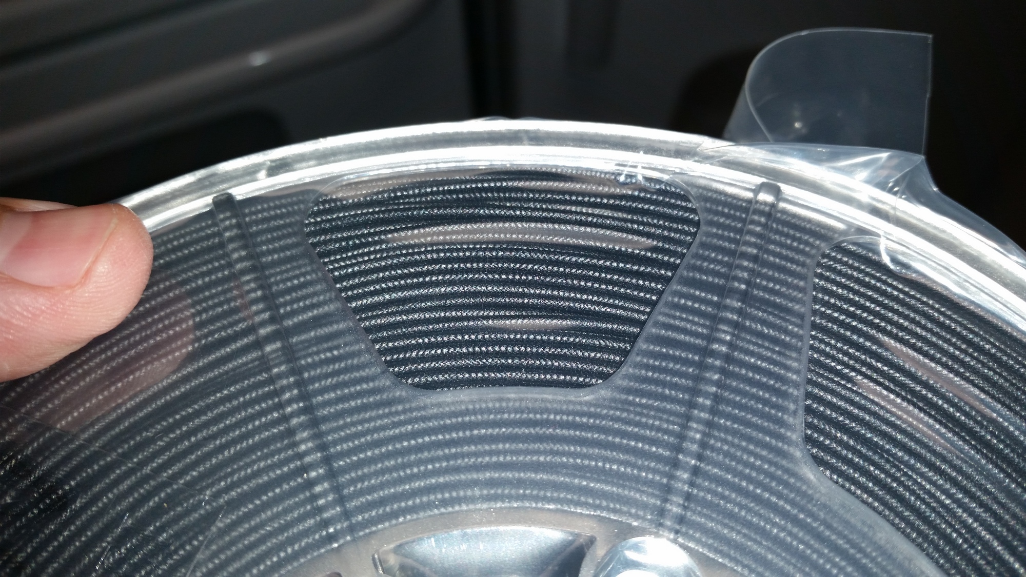

On another topic, I got 5 rolls of esun PETG in the last week and I noticed that 3 out of 5 of them was very textured. I think it was Tim that got a roll like that but no other mentions since then. I haven't opened the 3 textured ones yet (solid black, solid white and translucent blue) to measure the filament diameter. They don't look overly bumpy/deformed, just very textured. Anyone have the same thing happen? If so any problems with it or is it fairly normal?
textured esun solid black petg
(923.51 KiB) Downloaded 188 times
Re: esun petg
Post by jimc » Thu Jul 23, 2015 4:17 am
nope the textured surface is normal. other than a couple rolls in i think the first batch months ago, all my rolls are textured. even my sample i got a maker faire last sept has the same texture. many companies put a texture on to decrease friction through a bowden or feed tube.
Re: esun petg
Post by Jules » Thu Jul 23, 2015 4:29 am
Yep! My opaque PETG is textured. The translucent is smooth.

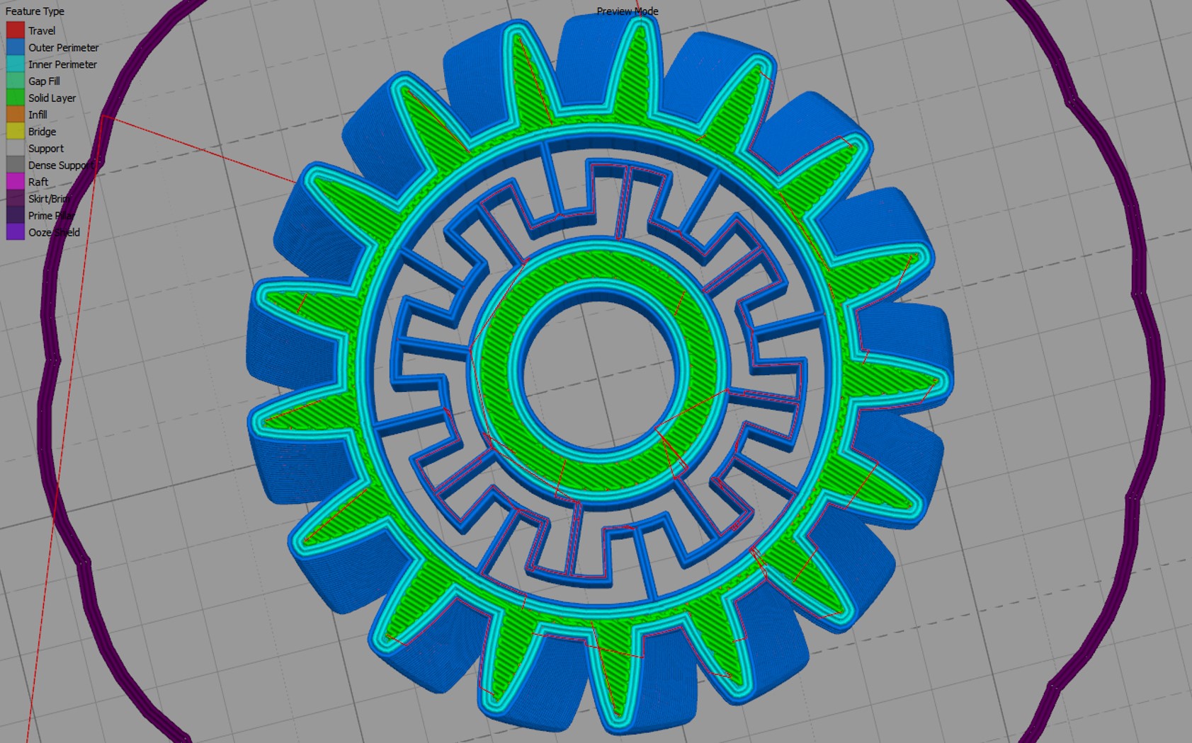

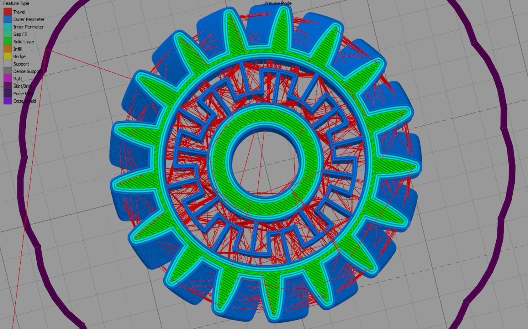

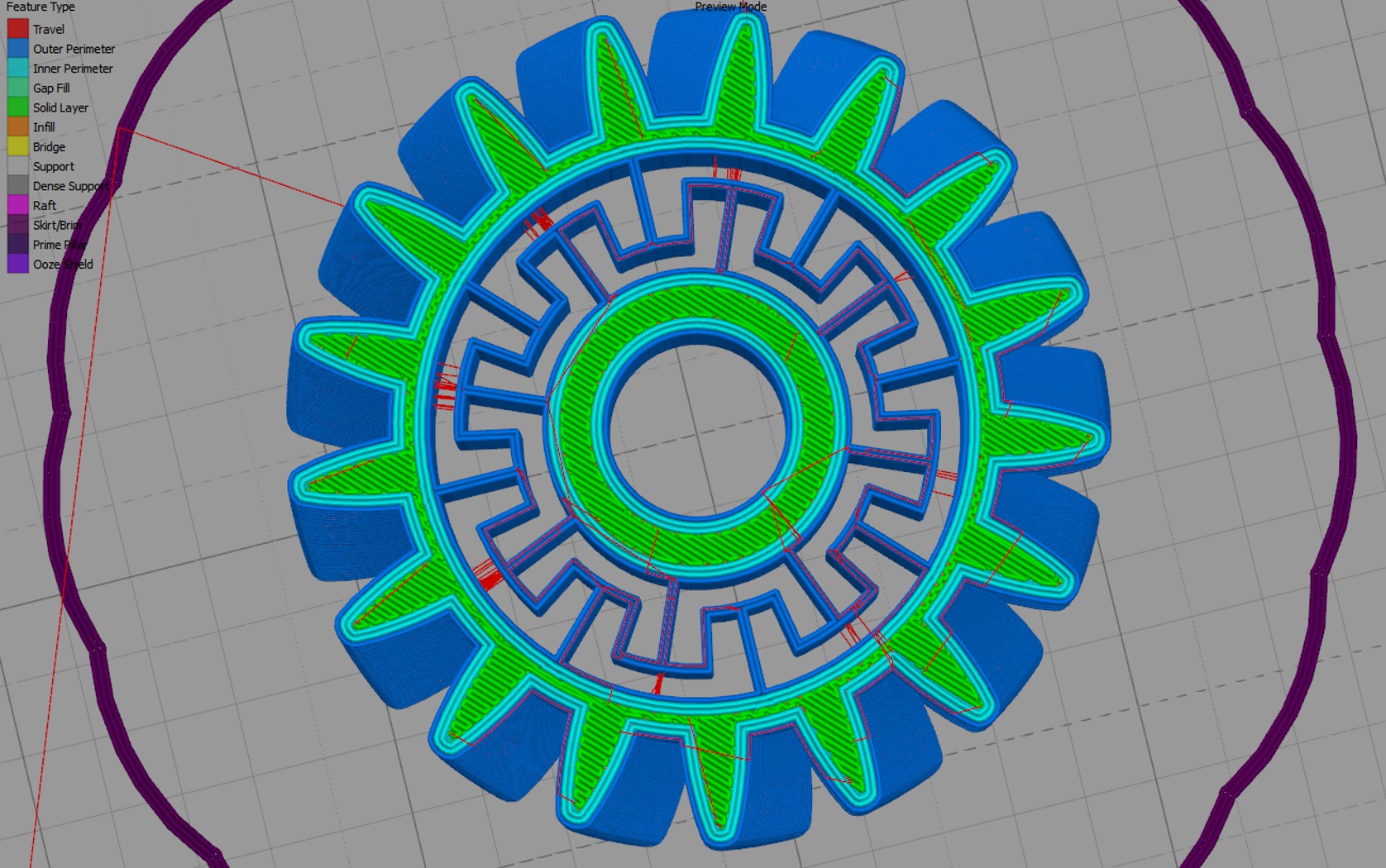

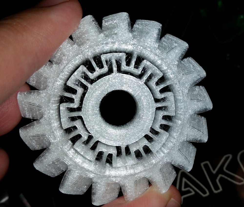

Simplify3D "Avoid Crossing Outline" and PETG; anyone use that feature? My PETG prints are looking good, however I do get very thin strings (essentially inconsequential from a usability standpoint) where the nozzle crosses the outline. Anyone use "avoid crossing outline" to get rid of the thin strings? Is it as effective as it theoretically should be?
Clear PETG print lots of strings
Avoid crossing not checkmarked
(441.76 KiB) Downloaded 147 times
Avoid crossing factor of 10
(374.95 KiB) Downloaded 147 times
Avoid crossing factor of 100
(374.42 KiB) Downloaded 147 times
Re: esun petg
Post by jimc » Fri Jul 24, 2015 2:36 am
i have not tried that feature yet. petg will always have those micro fine hairs. just because its so sticky. when your part is done printing you can make a quick pass over it with a heat gun or the flame from a lighter. makes the hairs disappear.
grifftech
Posts: 13
Joined: Fri Jun 19, 2015 4:39 am
Re: esun petg
Post by grifftech » Fri Jul 24, 2015 2:39 am
The problem I run into with all those hairs is the hot end slowly picks them up and over time it ends up screwing up the print
