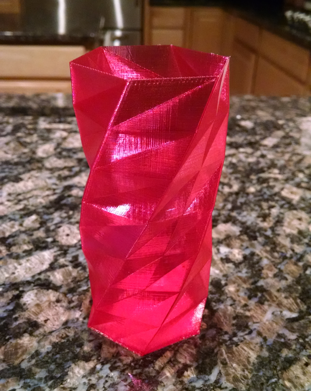

My vase stayed stuck to the bed (hairspray, and the bed at 70C as I mentioned before). But it popped off so easily I wouldn't say that it was firmly attached by any measure. I will also bump up the bed temperature to 80C for the next print. I noticed before that with my PET+, running the fan would cool down the bed and the piece would make alarming popping noises as it started to shrink and detach from the bed. I got into the habit of printing the PET+ without the fan running at all. The petg is obviously a lot better in that respect, but it's not totally immune from warping and shrinkage. I hope that just getting the right bed temperature will do the trick.

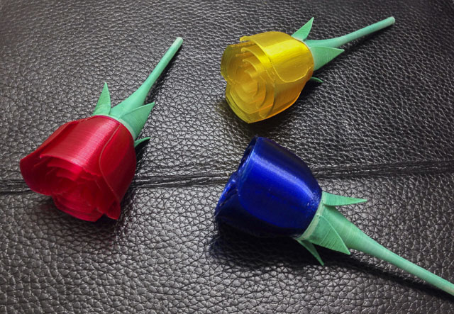

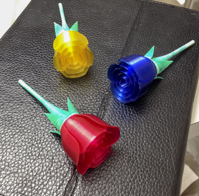

Here's three colors I did. Printed fine, no problems at all. Any flaws are in my settings.
Kind of telling I guess is that the stems are ABS. You can compare on the blue flower the stem to the rose and see a big difference in how clean the layers went down with the same settings.
.2mm layer height, 245 nozzle (24v printer), 110 Bed, no fan
