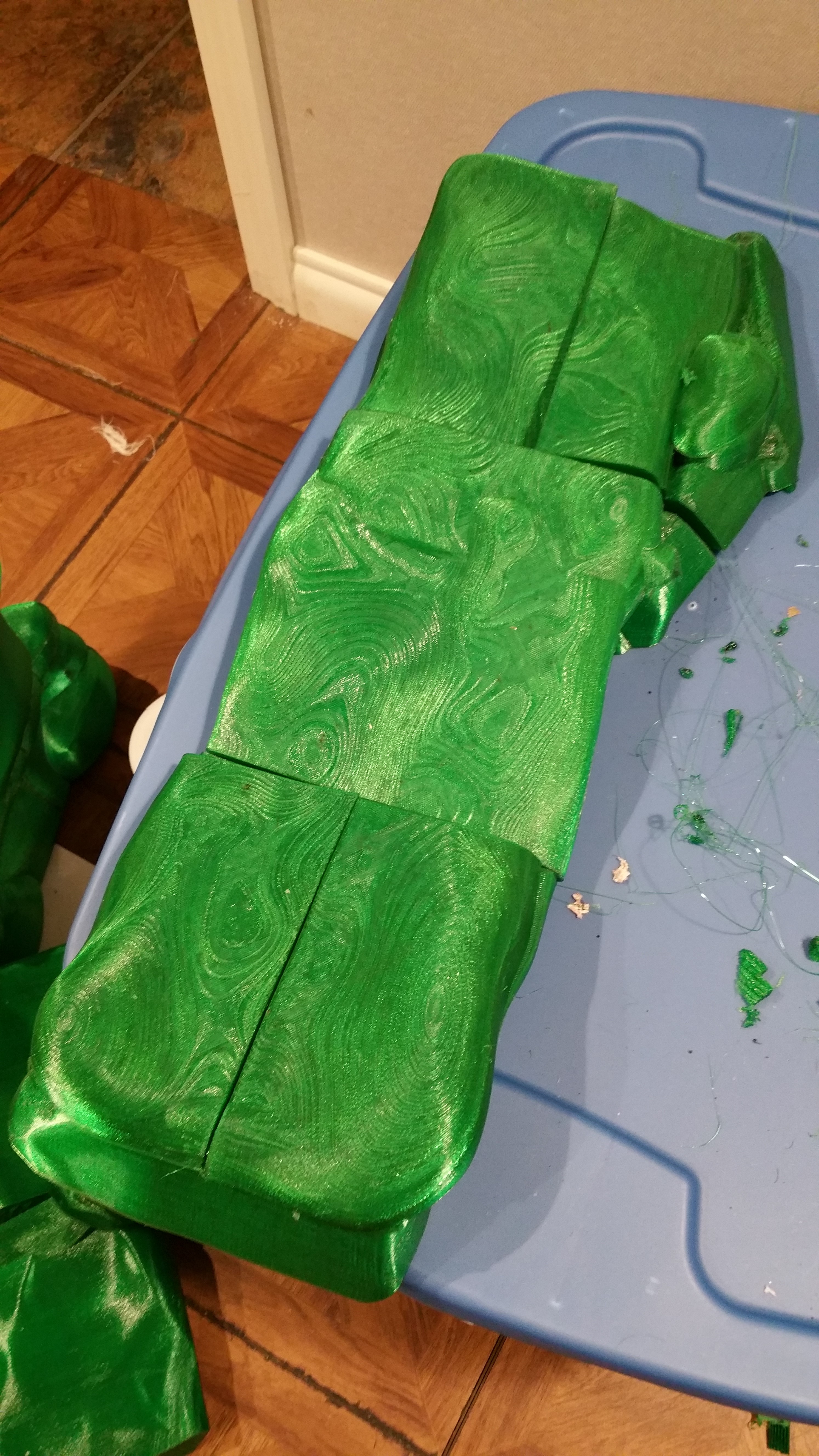

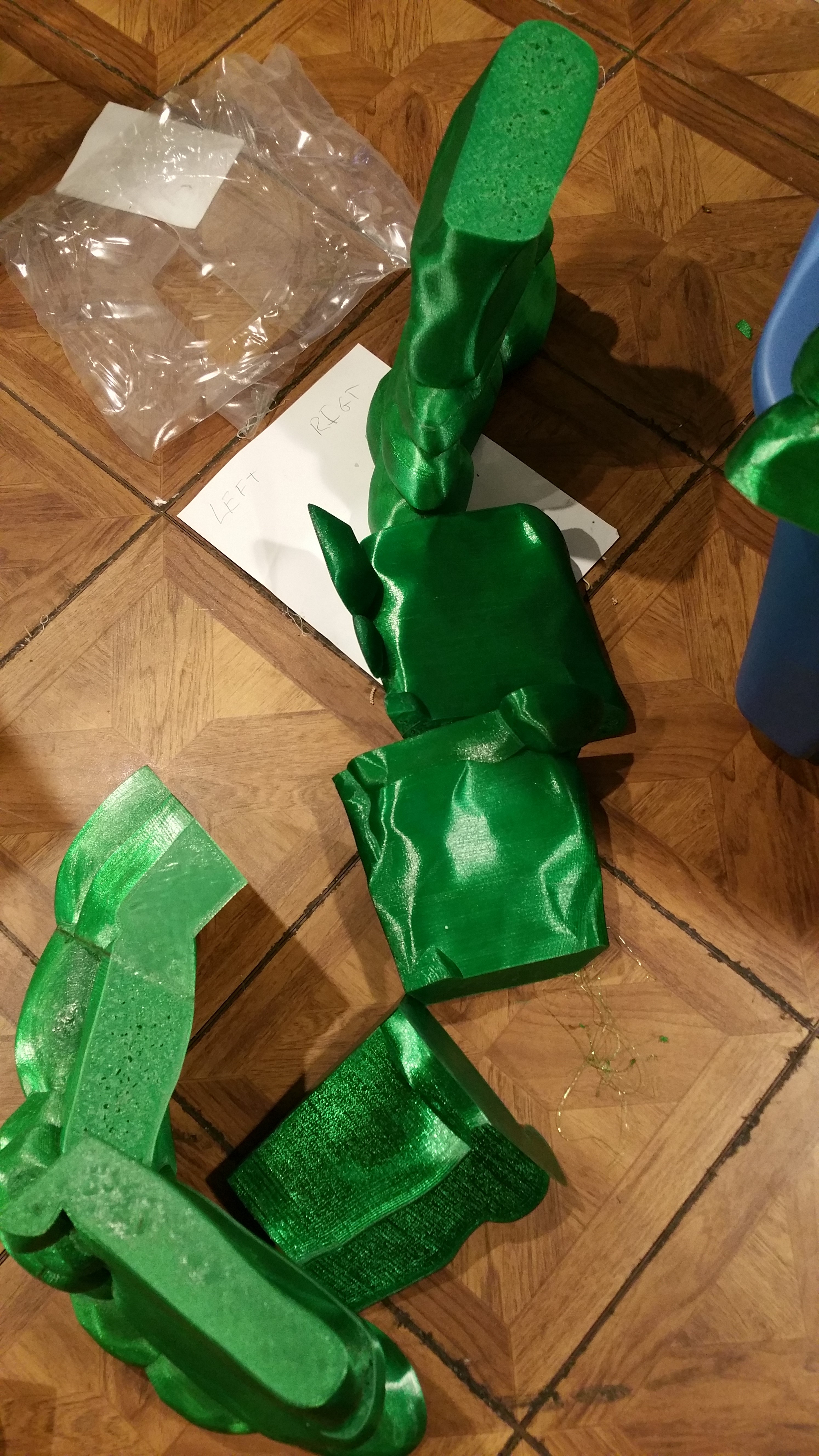

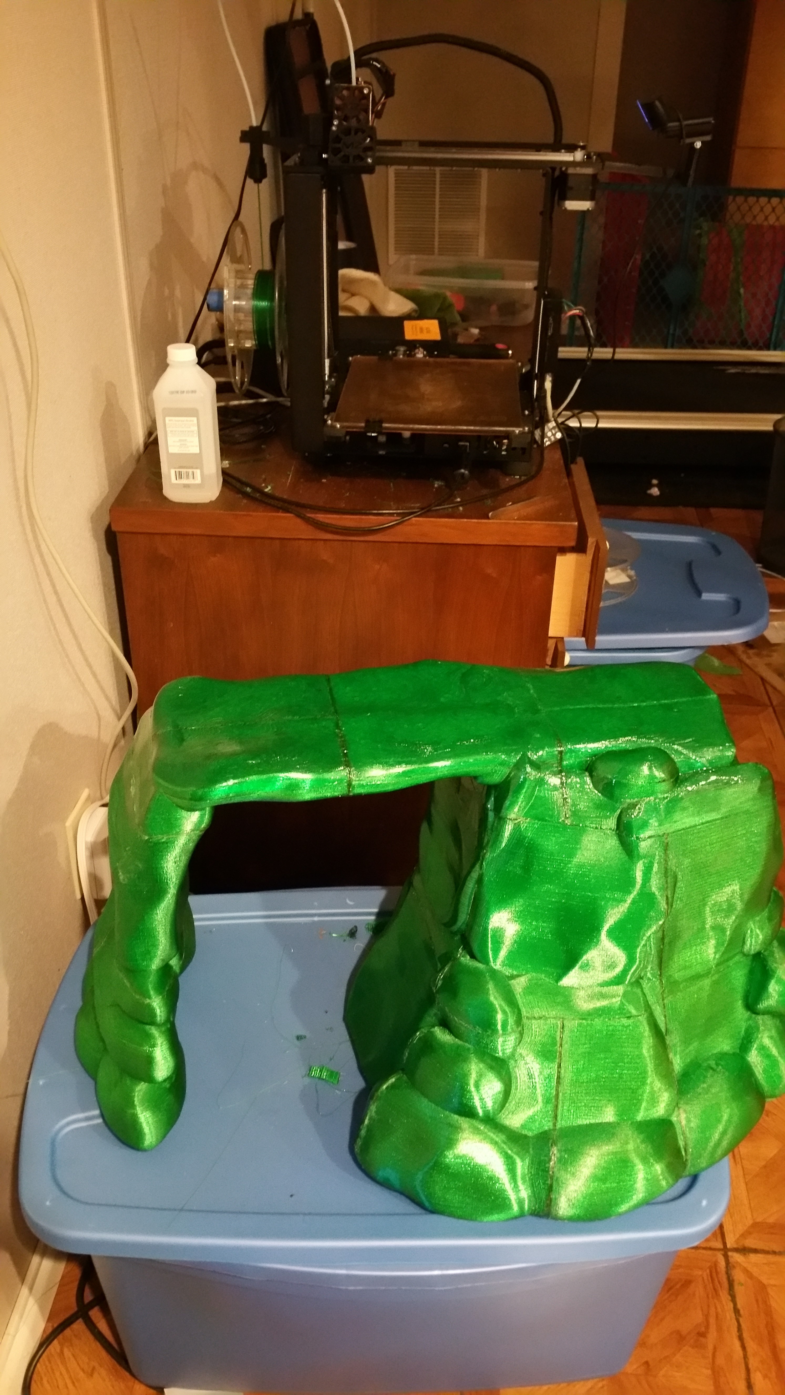

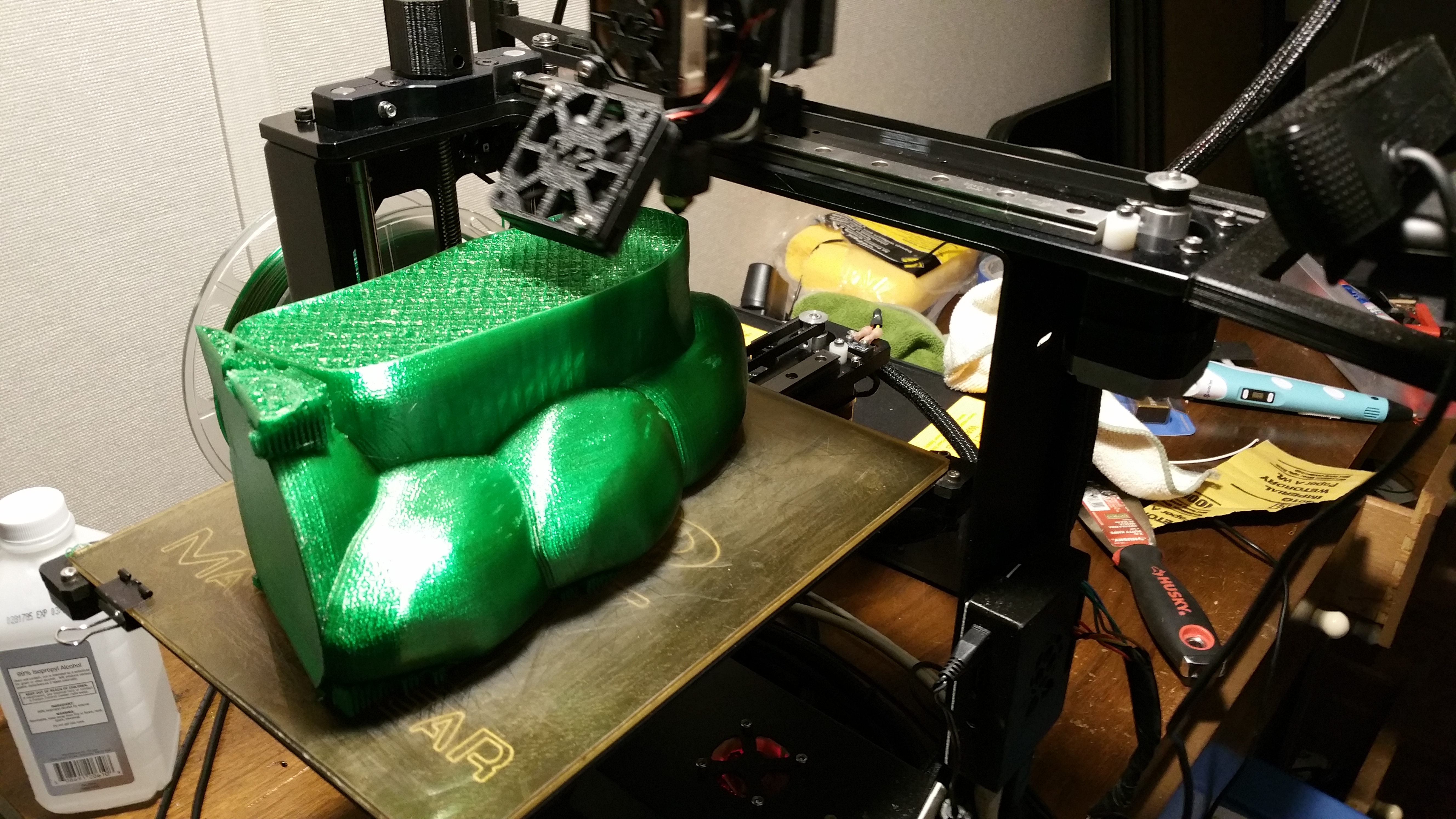

Thanks to the information in the thread. I got a good hang of printing eSun PETG -- and was able to print this giant thing. It's a perch/cave for my bearded dragon. I took a picture holding it just for scale. It was printed in 22 different sections. Glued together using weld-16 and welded with a soldering gun set at 550F -- also used my 3D printing pen in the welding process some. The top is coated with the XTC-3D, I didn't do the whole thing that way to give the dragon some texture to grab onto. The entire print took 4 rolls of green eSun PETG filament. 200 hours of print time, I had a spread sheet with all print times and weight estimates from S3D, which were pretty much spot on -- weight should be scaled at 1.2g/cm^3 not the 1.25 standard used for PLA and ABS. Time estimates from S3D were within 2-5%. This was printed with 10% infill -- which is tricky with PETG to get good top layers as it doesn't bridge well, so doing 6 top layers and keeping the fan on during the print works well. Also slowed the print down significantly for the top solid layers -- had to do multiple processes in S3D to accomplish that. Other settings -- 3 perimeter layers, 200% over extrusion for infill, infill using the crossing pattern rsilvers put together in one of his profiles (great idea). 4 Bottom layers -- some prints were done with a big skirt -- and I cam up with a trick for tall supports -- I created a square 20x20x1mm -- and I'd place it under tall supports in S3D, this way tall supports have a good base to stand on. There was very little support material used though, I'd say less than 2% of the filament used was support material, I don't like to use it and I wanted to get the best finish look possible, so I sliced up the model in such a way to avoid having supports. Other note, the print was done in a 200 hours straight, I stacked the prints in such an order as to (a) use the filament most efficiently, and (b) use time most efficiently, so that I'd be able to switch to the next print with no time in between, so my M2 was running for 200 hours straight.
Here is one of the pieces in action on the M2

Here are a bunch of top pieces -- jigsaw puzzle
(2.99 MiB) Downloaded 161 times
Here are a bunch of bottom and other vertical sections
(2.85 MiB) Downloaded 161 times
This is the cave next to the printer -- note the scale
