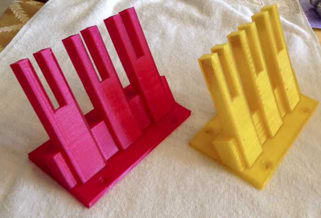

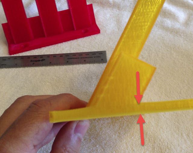

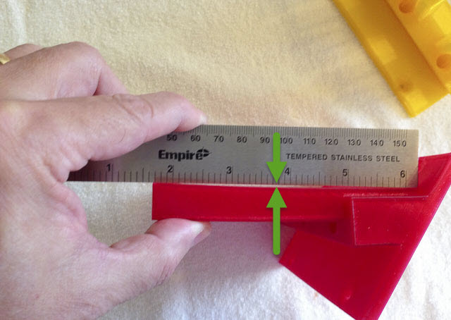

Ok, I re-printed my airbrush holder in two different colors. There was no issues with layers coming apart or layers warping. However there was some warping of the overall piece as indicated by the arrows below. That being said, I took no precautions in controlling air currents or temperature around the printer. So I can't say if stabilizing those would provide more ideal results. In this case the part is still very useable but not arrow straight as the PLA version I first printed was. Gotta love the colors though!
Overall view of both pieces.
Issue #1 was that the this long piece warped. While the individual layers stayed intact. There was an overall curvature of the piece. This particular piece prints at the angle shown in the first picture. I did not have this gap on a PLA version I printed it was super straight.
2014-11-24 16.48.40_1.jpg (46.07 KiB) Viewed 14299 times
This is the other issue I noticed. As the layer gets closer to the main body of the piece there seems to be a thickening of the area. Not sure what would cause that?
2014-11-24 16.53.46_1.jpg (54.82 KiB) Viewed 14299 times

Post by jimc » Tue Nov 25, 2014 2:15 am
that last pic is a new one, lol. never seen anything like that. so is the bottom of that part still completely flat? you should try one without any fan to see if it comes out different. what temp do you have the bed at and adhesive method?

jimc wrote:that last pic is a new one, lol. never seen anything like that. so is the bottom of that part still completely flat? you should try one without any fan to see if it comes out different. what temp do you have the bed at and adhesive method?
Yes, bottom is completely flat. Didn't use a fan on these.

Post by jdacal » Tue Nov 25, 2014 2:55 am
I'm thinking might be a little bit of an optical illusion due to the angled piece. Will try to get some measurements on it.

Post by jimc » Tue Nov 25, 2014 2:59 am
yeah it is interesting. i cant see how your nozzle would even go over that without breaking something or skipping steps. on another note....got a good view it looks like of the outside of your house! :lol:
