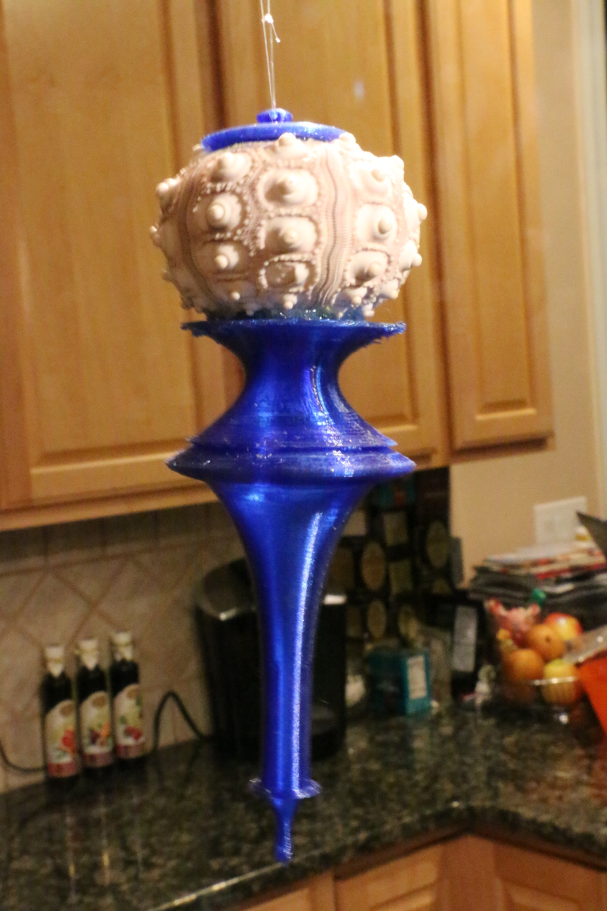

Some woodturners make Christmas tree ornaments out of sea urchins and I saw some last year and bought some shells. My wife has been asking about printing some ornaments. So just for kicks I designed upper and lower finials for one of the urchin shells and gave it a shot and printed them with the new PETG. Next time I'd make the stem a lot more slender, but this was a first guess.

cool steve. tall skinny objects are usually a little tough. how did the petg work out for you. hard to tell from the pic. looks pretty good though. maybe i see some fuzzies on the short section? prob from the overhang?

Post by sprior » Sun Nov 30, 2014 10:59 pm
It worked out pretty well. Most of the fuzziness was caused by support that got removed. The bigger bottom piece stuck to the bed very well the first time. The second smaller piece took 3 tries to get it to stick. I'm using an aluminum bed and glue stick.

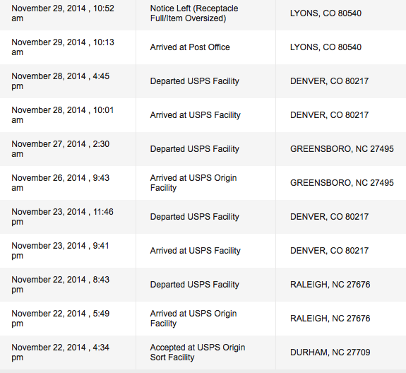

My blue and red went the long way around. Apparently Greensboro, NC is in between Denver and Lyons.
I hope to be able to pick it up tomorrow.
