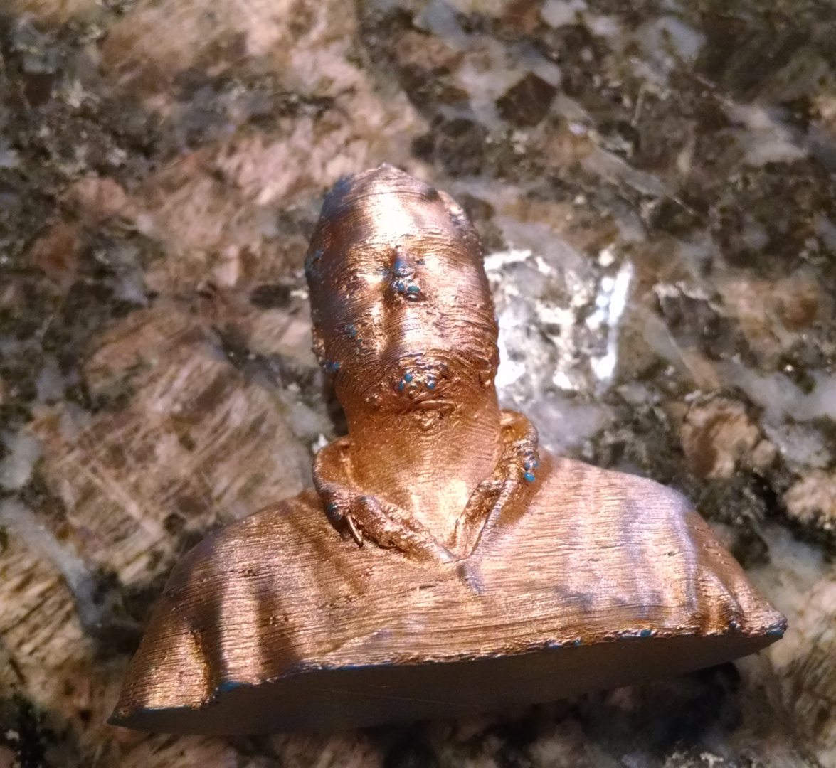

I started to play a little with Rub N Buff (http://www.amaco.com/shop/product-437-r ... ishes.html) which I already had for woodturning. It seems to stick well to the plastic and gives a decent metallic finish.

Re: Has anyone found a killer gold PLA filament?
Post by sprior » Sat Sep 20, 2014 1:03 am
Here's a sample. It's a pretty small statue (about 1 1/2" tall) and I printed it in blue PLA. Then when I got the idea of the Rub N Buff I figured what the heck. You can see some blue peeking through. If I were doing this over I'd use black PLA so it would look more normal in spots. I could also give it another coat of gold, but it was so small I was getting in the cracks with a Q tip.

I should mention that Rub N Buff is what antique picture frame restorers use, so it generally comes on those kinds of colors.
