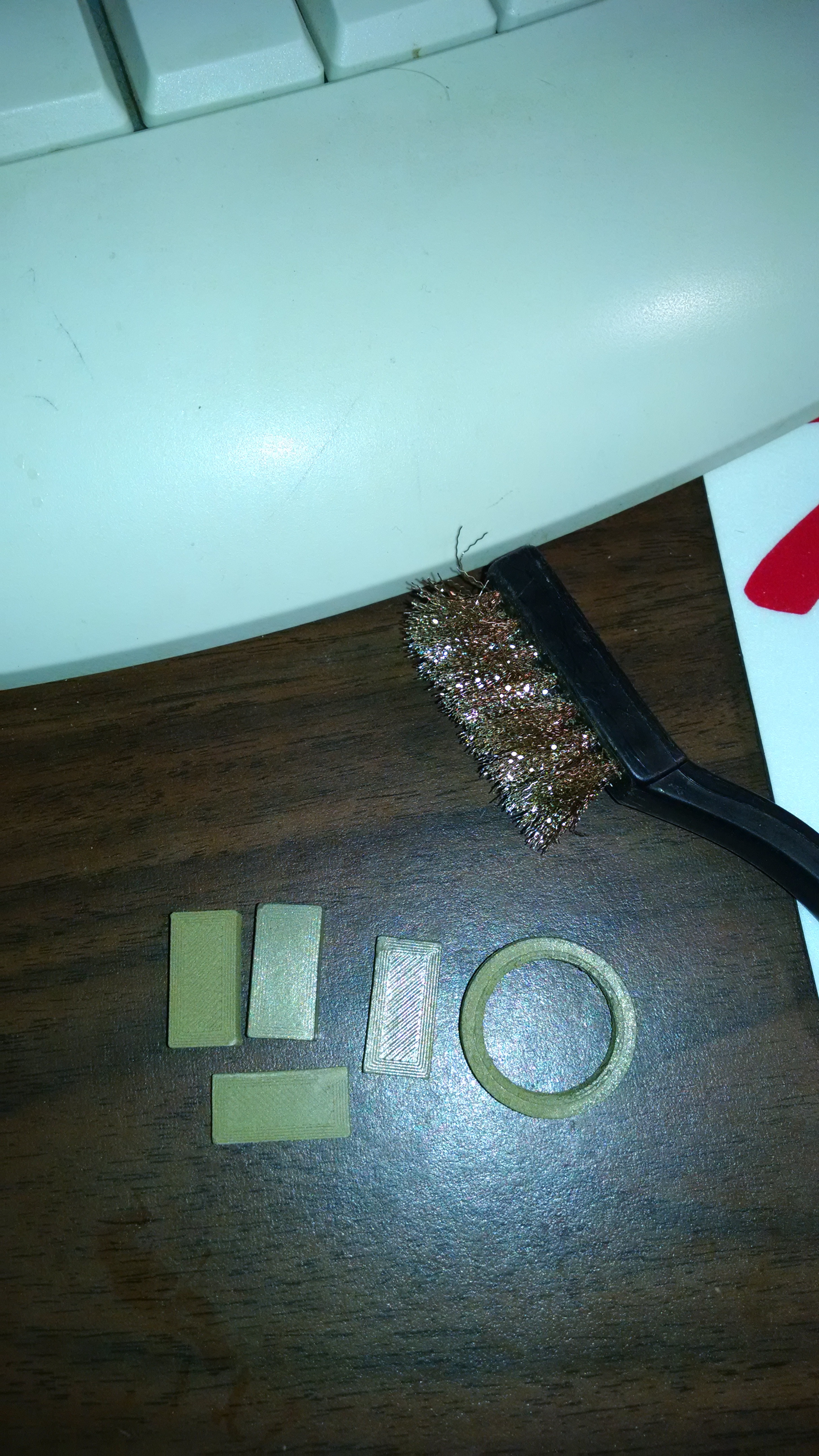

Filament name: Brassfill
Filament vendor: ColorFabb
Hotend used: V4 PTFE
Nozzle diameter: 0.35mm Stainless Steel
All settings are the same as PLA.
This stuff is a little weird. As the extruder clears over free space, the filament is dense so it falls away from the nozzle and does not retain itself in a thread. You end up with a pile of poop on top of the Rambo case instead of a string hanging from the bed. (This might be because I print it on the high-side of PLA temperatures, though.)
It does print just like PLA, though. Printed objects are essentially very heavy, but quite brittle PLA.
Getting it to look like brass is the next step. I tried sanding, tumbling with brass .45 cases, scrubbing with Brasso, and a brass-bristled brush. The brush is most effective, as you can see from the photos.
Various tries at polishing. One block and the right half of the ring have been brushed.
