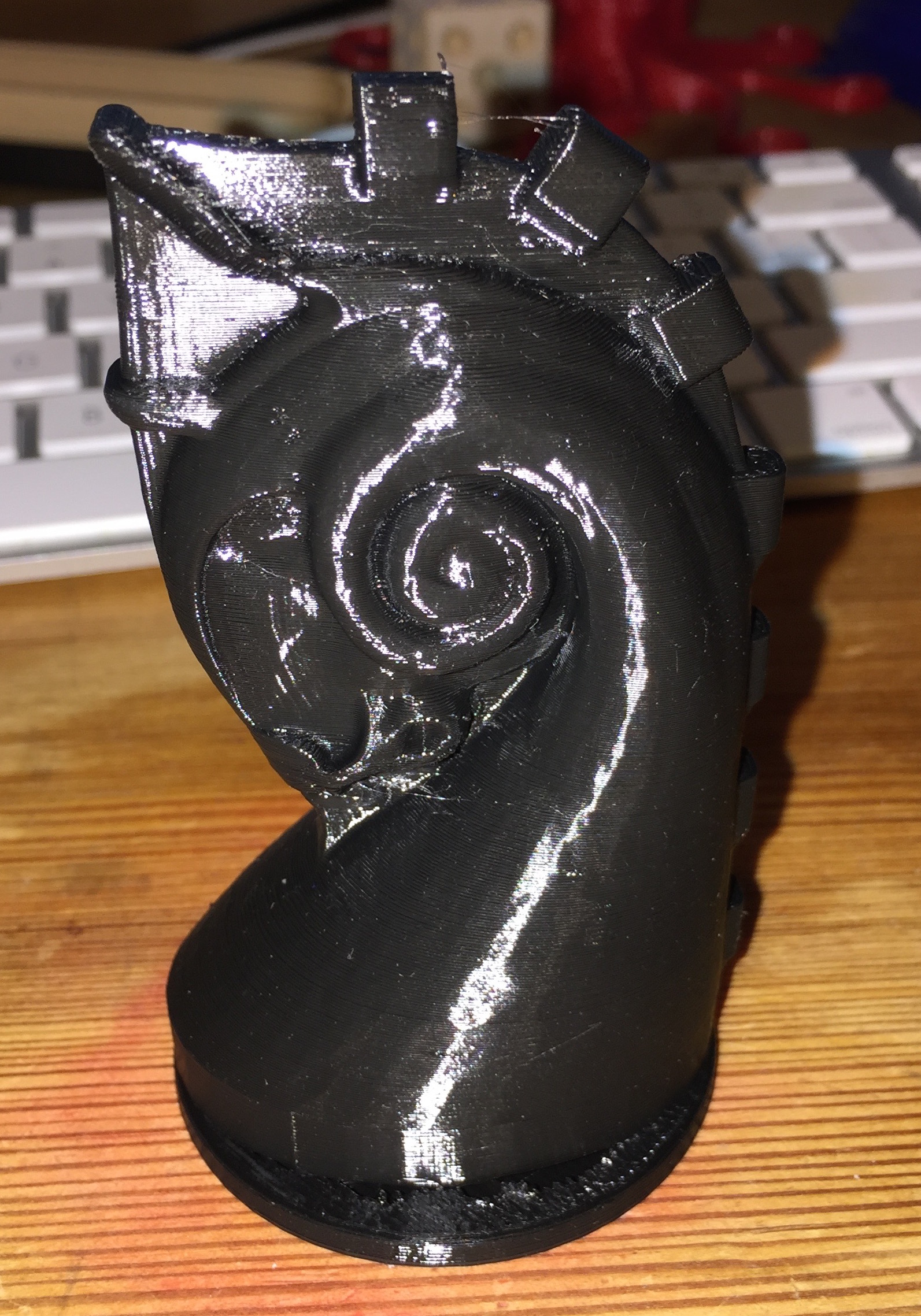

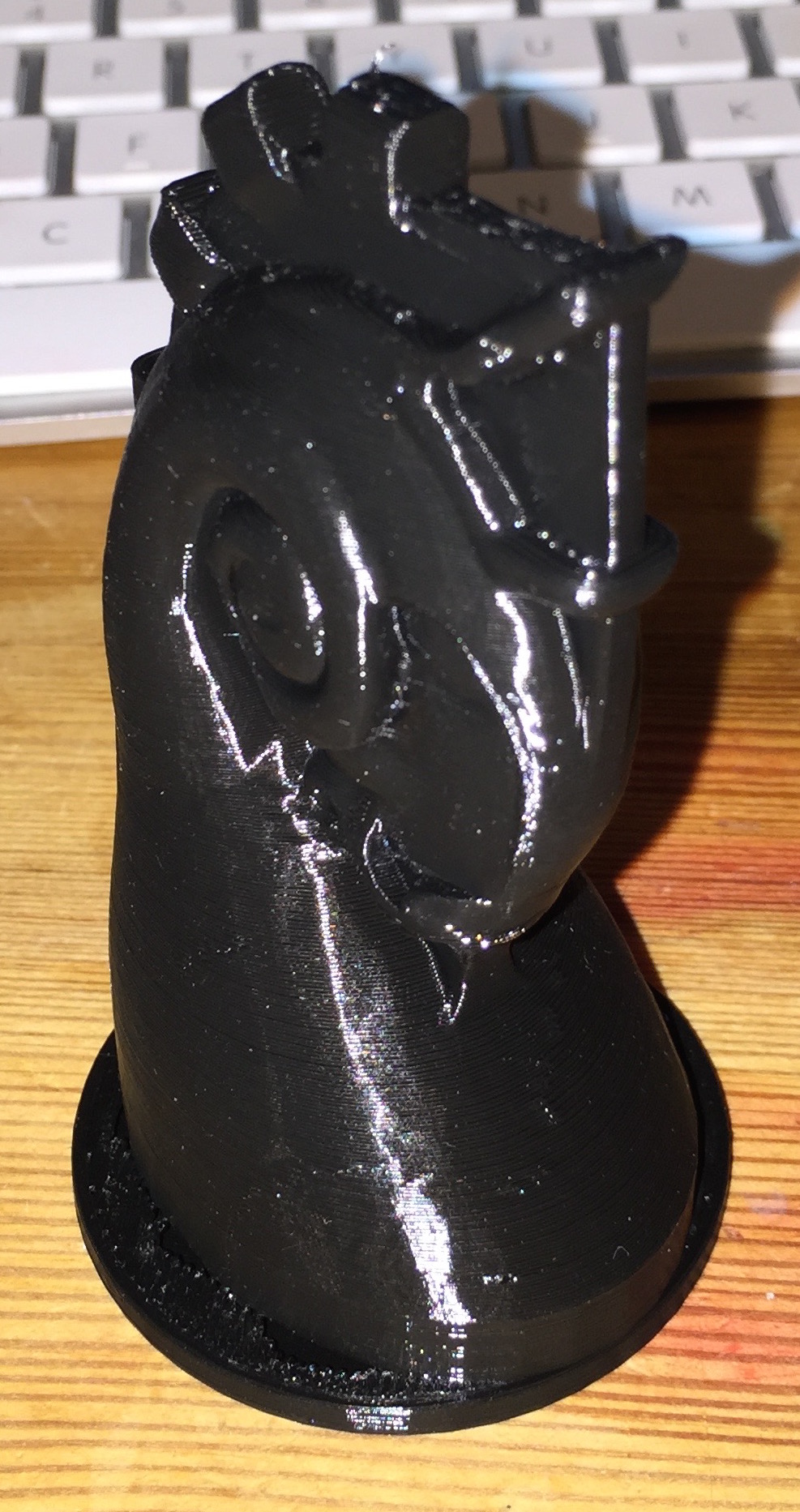

I bought some Semiflex. I'm using the basic PLA profile, but adjusting the Extrusion multiplier to 1.0, the retraction distance up to 1.5mm, the speed down to 1800/mm/min, and the temp at 205 (I have an E3Dv6). I've printed 3 objects and all of them have come out perfectly. No jamming and not too much stringing (if at all).
Just figured I'd share my results. Here are some pics:

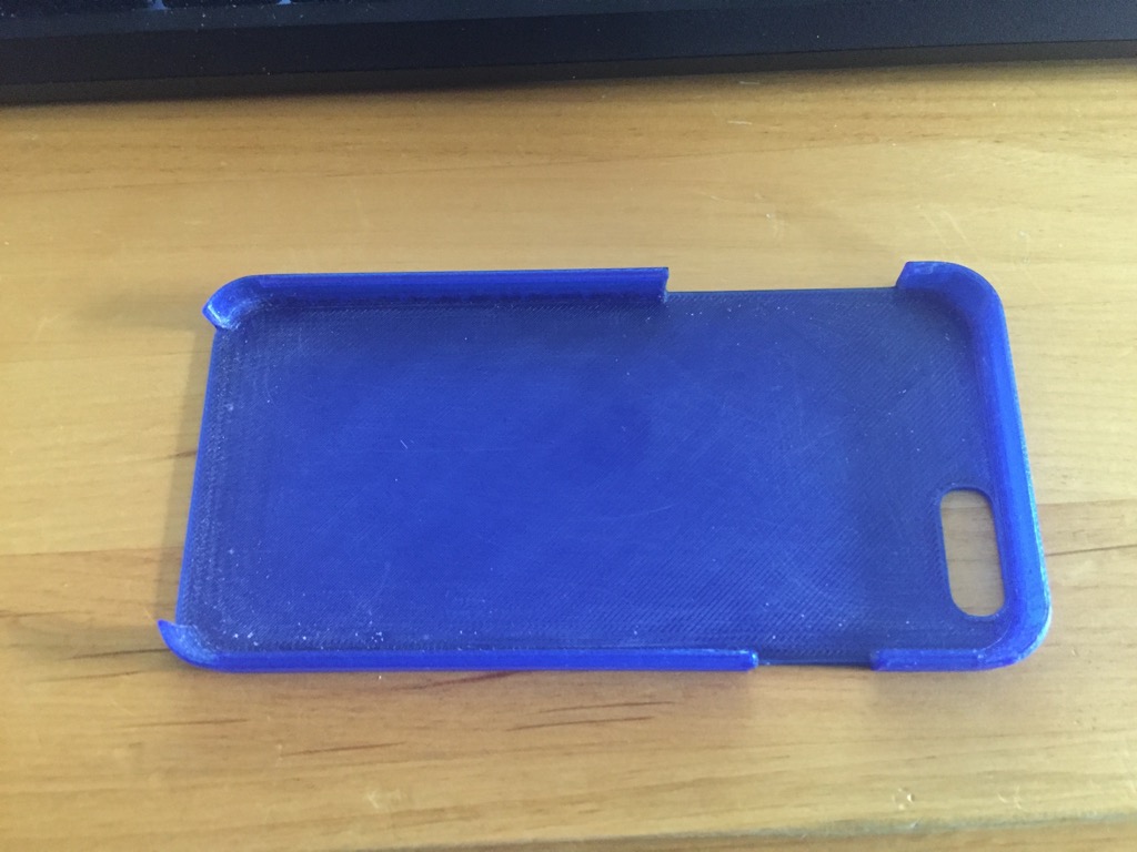

I printed an iPhone case in PETG. It's flexible enough that it goes on easily and stays snug. I'm not convinced ninja/semi-flex will do much for impact protection, but I'm not going to be running any tests.
I did consider printing a negative mold and using RTV silicone to make the case, but OpenSCAD threw an error when I tried to difference the STL and I don't know how else to do it.

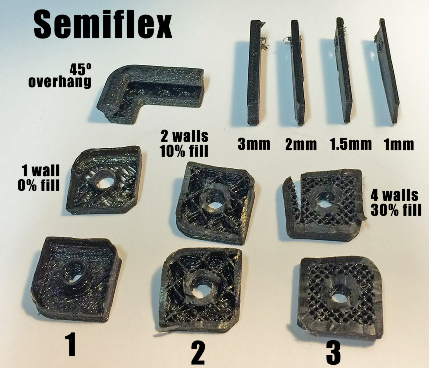

Been testing Semiflex. Wow, pretty cool stuff. Takes detail very well and it is tough as nails. Can go from hard as a Lego tire to soft and squeezy depending on how thick the walls and infill are. Think of tough things that can yield just a bit or twist like rubberized guards, bumpers, furniture feet, a rubberized tool handle, a cable tie, and the feet on your M2.
I printed these using Ninjaflex settings and it did great. I will add some retraction back in, this should handle it fine. Prints almost as well as PLA, but slower. I think I will try printing with a modified PLA setting next rather than the Ninjaflex settings, the same way LonV did.

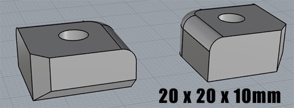

Picture one is the test block file.
- •I printed this at a few settings to see how it did, then cut it in half with an Xacto to check the inside. I printed at .20 and .25 layer heights and it did fine at 250ºC. I used blue tape on the bed. This stuff can actually warp and printed best with no fan at all. I did print a bit on glass and it looks fantastic and glossy, but had some corners lift, but I may have had the fan on. I do not recommend supports. They are hard to remove.
- •On the top left there is a part with 45º overhangs. It printed fine without support.
•On the top right are various thickness 10mm high x 40mm long with a 5mm hole in one end. The 1mm wall printed great. It would be near impossible to tear this in half with your hands. They can all be bent 180º and will flex back with no apparent damage. The stringing is from bad retraction settings, printing these too close together, and an attempt at using supports.
•Block 1- 0% fill with a single wall. I should have had 4 top layers rather than 2 and it would have done better. A bit soft for bridging, but it will get there with enough layers. Squishes, but readily springs back to shape. I cannot tear or delaminate this by hand, but it is deformable.
•Block 2- 10% fill with two wallls. OK, this got strong quick! Very resilient, hard but yielding, like a racquetball. Getting hard to cut in half!
•Block 3- 30% fill and 4 walls. You can twist this a bit, but you can only just barely compress it. VERY difficult to cut open with an exacto. You see that sliver I cut on top piece with a knife? I cannot tear it the rest of the way by hand.
- Radiused and chamfered block with a hole in it.
- testblock.jpg (33.23 KiB) Viewed 15544 times
- Test results
- semiflextest.jpg (195.89 KiB) Viewed 15544 times
