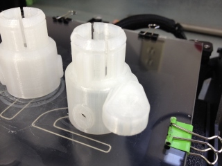

I use quite a bit of Taulman 645 for structural prototypes and once I heard about the 910, I ordered it. I received my roll of Taulman 910 last night and could not wait to try it. Simple truth, I like it a lot so far. A couple things I noticed right off:
1. Less bed adhesion problems due to less shrink. Elmer's glue stick works well. Zero edge lifting. The parts do not warp after removing from bed either. I have had 645 warp a bit after removal from bed.

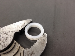

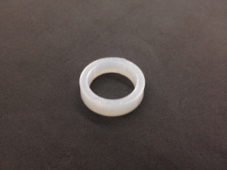

2. Parts are more accurate due to less shrink. With 645, I would have to adjust the I.D. of parts in CAD to hit a critical dimension, not with the 910. My test part showed OD and ID within .002in. of actual CAD.

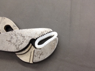

3. Stiffness - no question Taulman hit a home run here. This material is incredibly stiff, amazing difference compared to 645. And they are doing it without any fillers that would affect nozzle wear. I have always looked for a material that more closely mimics glass filled nylon and this 910 gets closer than any I have tried thus far.
4. Processes just like 645 after dialing in filament diameter and extrusion multiplier for 910.

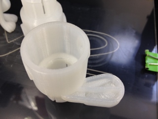

910 definitely has less warping than 645, at least with the parts I have built here. Support removal was easy using 2 dense support layers at 75%. As far as extrusion consistency, well it is Taulman, so it does vary
. I'm using 1.69 average filament diameter with the spool I have as it varies from 1.63 to 1.74. However, it looks like Taulman learned their lesson to not let it run over 1.8 or 1.85 as it then locks up in the filament guide. I had a couple of spools of 645 that were 1.83 to 1.89 and Taulman replaced those. Even with the filament diameter variances on this roll of 910, I have to say my initial tests are very positive for the parts I do. The part I just finished had critical I.D. dimensions of .745" (it ran at .743") and 1.130" (it ran at 1.126") without any changes to the CAD before creating the stl. With 618 or 645, I always have to adjust the CAD for critical I.D. diameters as it may run .01"-.012" undersize depending on the diameter. Wow is this stuff stiff, like injection molded, glass-filled nylon stiff. Me Likey.
