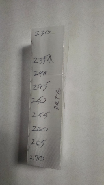

I used this method to print a multi-temp calibration cuboid: https://www.youtube.com/watch?v=FSOPsRi ... e=youtu.be
This seemed faster than printing a bunch of small cubes!

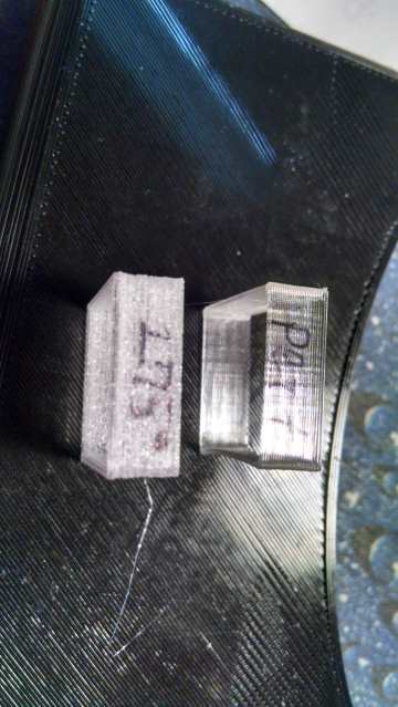

What I found surprising was that PetG adhesion (which seemed to be an issue) came out best at 235c, at the higher temps (255+) Pet+ was white like it was bubbling/boiling. I was surprised by this low temp. On the down-side, I did have 2 prints just stop extruding mid print, perhaps due to higher viscosity - but then I tightened the extruder. Perhaps one of the many other settings is not right.

One thing to remember is pet+ is totally different than petg. The plus is madesolids own pet formula. Their solid colors never layer bond real well. The same or a little less than abs. Petg should bond into a solid piece. On the bubbly note. I have white pet+ here and have never seen that. I print it at 265 to get it to layer bond better.

Thanks JIMC - I originally got Pet+ (Clear) as microcenter has the entire line and they are 15 min away (So I have a "what you can get local bias" but will order something if it is clearly better). I think it was Pet+ that was bubbly above 250, I get confused. I also didn't realize they were so different, so far they have seemed similar. After some frustration with Pet+ I got clear Pet-G (Also at MC, but only 1-2 colors) (because this was discussed on the forum more) and did the tower calibration test, and that came up better at 235 but I could still break a single layer with a medium finger-nail push. So, perhaps you could divulge all of your settings
and I could try that combo?
On a similar note I got Translucent purple with the M2 and found it not like the black at all. It seems more like pet - kind of stringy.
I am still VERY MUCH in the learning curve for the "dial it in" fun!
Would really love to see a full "process" for the dialing in a filament with all the steps and calibration thingies
Edit: Yup, just found my temp cube for Pet-G (Picture), it is not bubbly - that was Pet+ (Other picture)
WIll try 250-255 again based on these comments!

- Pet+ - Bubbly above about 250
- Bubbly.jpg (32.42 KiB) Viewed 15466 times
- Pet-G Temp Test
- TempCube.jpg (117 KiB) Viewed 15470 times

If ypur petg is breaking apart then your too low on the temp. 235 is a bit low. It prints good there but the bond sux. 245-255 should be the range you need to be in. The translucent pet+ layer bonds much better. Its the opaque colors that have trouble. I have really found no advantage to paying the super high price of pet+ when you can get petg that performs as good or better for about 1/3 the price.
Re: PETG calibration prints
Second this. I have yet to get a nice print out of the pet+ white filament. The solid red and translucent blue print just fine.jimc wrote:If ypur petg is breaking apart then your too low on the temp. 235 is a bit low. It prints good there but the bond sux. 245-255 should be the range you need to be in. The translucent pet+ layer bonds much better. Its the opaque colors that have trouble. I have really found no advantage to paying the super high price of pet+ when you can get petg that performs as good or better for about 1/3 the price.
