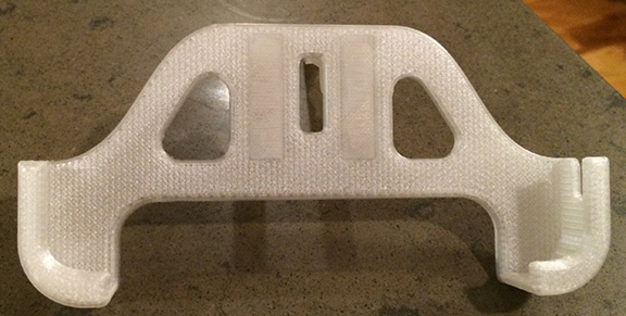

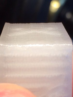

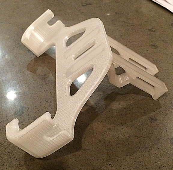

well i have done some printing with this stuff. its fantastic. ive been printing quite a bit with it. its super strong and rigid. regular polycarb is almost impossible to print with because it warps so bad but with this formula the warp really isnt that bad at all. i found it prints as low as 235-240 or so but to really get it to layer bond well run it at 255-260 or better. temp resistance is fantastic. its prints really clean, no stringing and easy to control blobs and ooze. if you need strength or a higher temp material then this is perfect. so far i cant say enough good things about it. i have done some testing and shrink rate is 0.85%. for dimensional accuracy scale up your parts in x and y that amount. for comparison petg is 0.4% and abs is 0.8-1.2% depending on brand. if this stuff came in a bunch of opaque colors like abs i would never use abs again. this stuff would be great for printer parts. if anyone else gives it a go post up some results. i have a couple spools here and ill update as i print more of it.this stuff is really easy to dial in setting for. about as easy as pla.

im not sure what esun's plans are as for colors but i hear ya. i am all about opaque colors. these translucent ones don't do anything for me at all. this stuff isnt clear on the spool like petg. its a cloudy colorless filament. from a functionality point though this stuff is bad ass and easy to print and get a good surface finish as pla. just gotta deal with abs level of warp. it sticks really well to a hairspray bed. i have not tried glue stick since i haven't gotten that to work with anything.....EVER. if they would come out with this in basic solid colors it would be great. black, white, red, blue, yellow and green. this stuff really isn't for artsy trinkets. its for truly functional and high strength items.
as insta said it absorbs water BUT i have no info on esun's blend. it might not be that way. nylon for example suck up water like crazy and i cant even print that stuff without a few hrs in the oven first and it will still steam and crackle. this stuff was not like that. it extrudes clean as can be. if i leave it out for a few days and print again we will see what happens.
