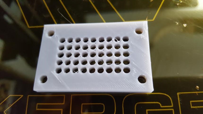

Thank you for the help. As you can see the print is much better with no pulling between layers. I have the temp at 242 for all layers now and increased the height of the first layer to 130%.
The filament is from Makergear.
I have been printing with eSun PETG successfully for a while.
Just bought a new build plate and recalibrate, now I ma getting a lot of stringy filament remnants.
Whats the best way to move the first layer away from the nozzle by adding +0.02 mm increments to the Z-Offset in the G-Code section of S3D, until it quits.
How should I do this exactly?
Do I change the settings in S3D, or just jog the controls of the Z-ofset?
thanks
thanks
