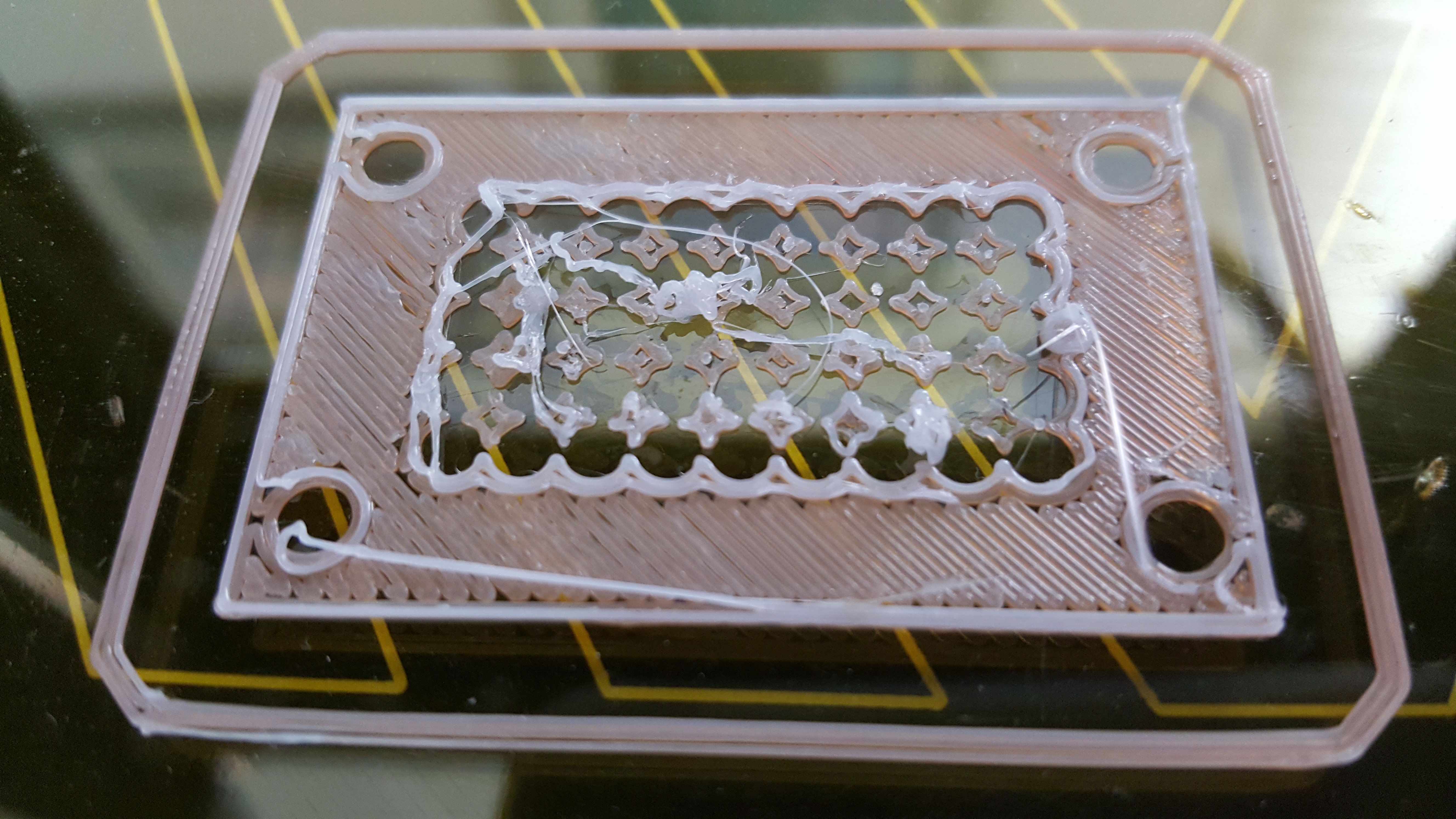

Hello all,
I just started trying to print PETG. I followed Jules configuration setting and began with not much luck. I have a new M2 and was hoping someone would recognize the issue and lead me down the right path.
This is my first print and as you can see the layers do not want to stick to each other.

Do i see 2 different filament colirs there? Brown and natural/white? It appears that your first layer is not sticking to the bed. Printing on kapton? Youll need some hairspray for petg

I am printing on Kapton but what you see is one filament color, grey. The first layer is printed at 247 and next layer is printed at 242, I guess the color change is due to that.
I tried a couple of more prints and it looks like the nozzle is dragging through the layer. The first layer is staying down but other layers eventually drag and collect on the nozzle. Is this a heat problem or do I have my nozzle too close to the bed?

Your Z-gap is too large - use the Z-Adjust app to close the gap just a little bit for your first layer.Kryfin wrote:Hello all,

Or increase the height of your first layer.
If you used the posted Rev.E dual profiles, you might have to tweak them a bit - they're just a starting point. (For instance: Increasing your extrusion temps slightly will help the filament to bond better if you are printing in a cold basement.) But mostly I think it's just that first layer gap.

The filament is the same. The first layer is printed at 247 and the others at 242, following Jules configuration. I tried a couple of more times and noticed that the nozzle is getting stringy and it seems to drag across the print causing the print to glob onto the nozzle.
Is this a nozzle setting problem, I have calibrated the bed very nicely and other filaments come out great? Could this be a heating problem?

Take the first layer temp down (242° for all layers) - it should not be creating that much of a difference in color between the first layer and the second. (What's the bed temp? What kind of PETG are you trying to print?)
When it gets stringy - it's generally too hot. (Causes oozing.)
Additionally, while the gap might be just fine for other filaments, (which are more forgiving of errors in the setting), if you are going to print PETG, you have to be a little more careful with it. And your gap is just a little bit too large.
I can tell by looking at the shape of the threads that you laid down in the first layer. (And if you don't adjust it, you are not going to successfully print PETG.)
