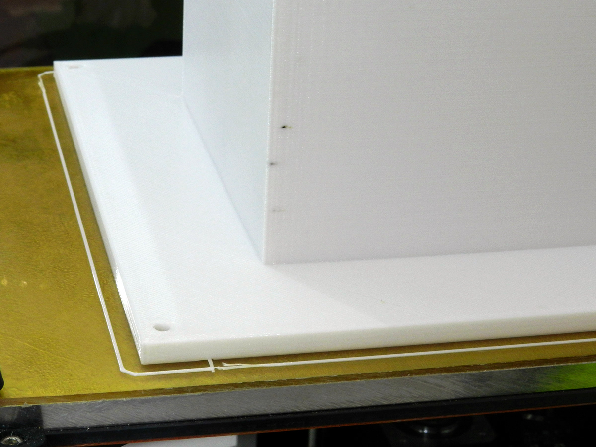

Thanks so much for this thread. I've been printing with some eSUN PETG based on the FFF file posted here. I'm really digging the results. Good surface finish, great strength, good dimensional accuracy and good flexibility. However, I'm frustrated with one aspect. I can't seem to get rid of the burnt pieces that end up in the print. I would appreciate any advice to minimize this. Here is a 24 hour print done in white which shows what I'm getting.
Posts: 1170
Post by ednisley » Sat Nov 26, 2016 6:21 pm
steve220 wrote: I would appreciate any advice to minimize this.
Use black PETG, then paint it white to perk up the somber appearance. [grin]
Obsessive retraction tweaking helps, but nothing prevents PETG hairs from collecting on the nozzle, oxidizing (?), then oozing onto the growing object.
Post by Jules » Sat Nov 26, 2016 7:54 pm
You're not gonna like the answer.....
1. Don't print in white.
The problem is exactly what Ed was saying - it's just about impossible to completely eliminate the little hairs that get picked up when printing PETG....those hairs char on the nozzle and when they get big enough, they fall off into your print.
You can remove the buildup from the nozzle while the machine is printing with the tweezers - takes practice, a steady hand, and a willingness to wreck a print or two.
You can decrease the extrusion multiplier by 0.1. (Use 0.89 instead of 0.90 for example) If you under-extrude a little, it makes less threads. You can also increase your gap by just a hair, about 0.02 mm. Causes less brushing of the previous layer.
But that print looks really good - you don't have many buildup deposits in it. You're not going to get it much better than that on a 24 hour print. :D

What? No .. there is an easy way.
Turn on "ooze shield" if you're using Simplify 3D ... it creates a one-perimeter thick wall all around the object. The oozy blobs stick to that, and not to your print.
Same principle as two-color printing.
Post by Jules » Sun Dec 11, 2016 12:42 am
That's clever.....never thought of using it on a single. :D
