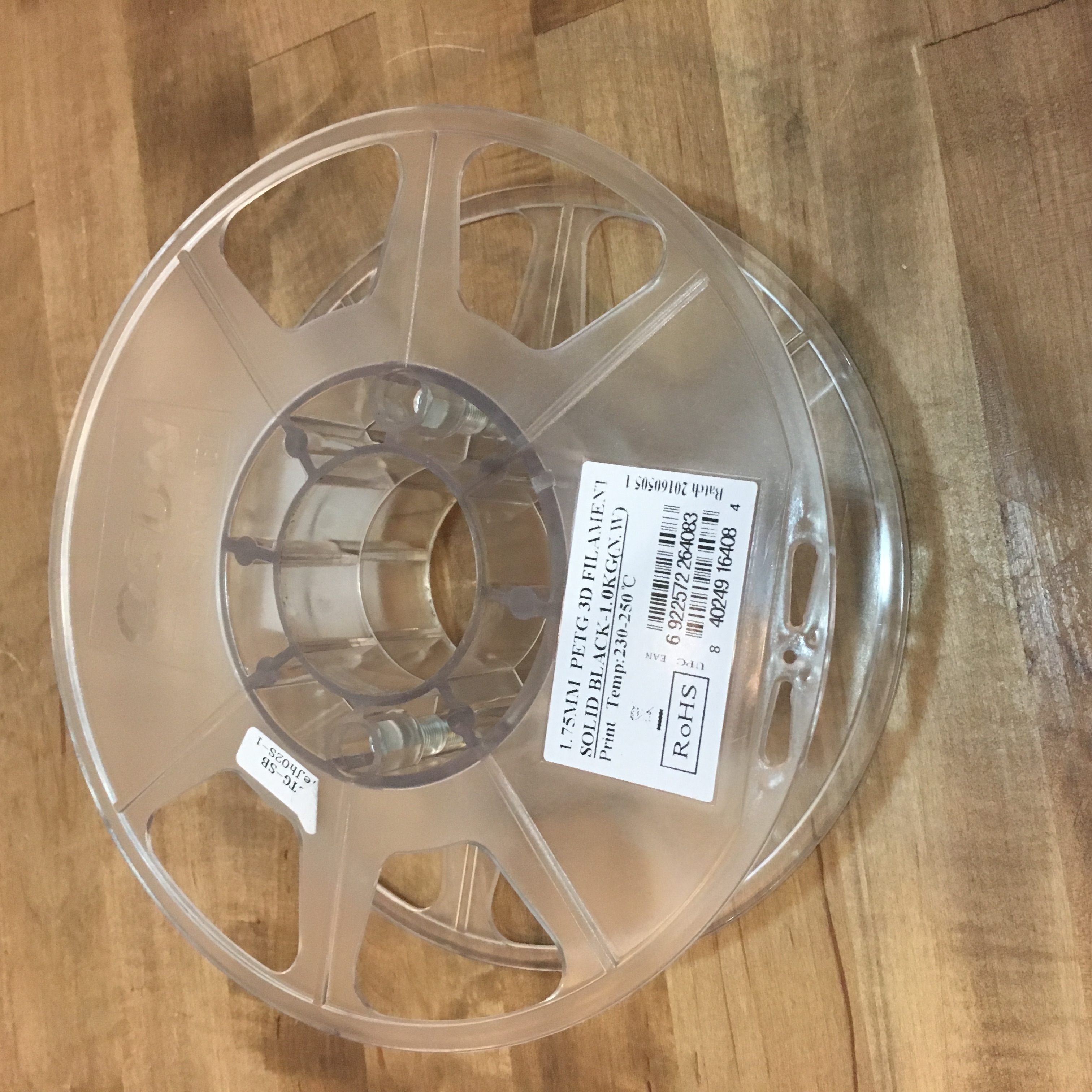

Does anybody have the following specs on the eSun PETG 1kg, 1.75mm diameter spools.
Empty Spool Weight = ?
Full Spool Weight = ?
Length of Filament on new spool = ?
Just checked and empty.
empty spool weight 218.7 g
assuming that full spool weight would be 1218.7
- Posts: 141
- Joined: Sun Dec 21, 2014 8:04 pm
Thank you. Is that spool clear? (spool color not filament color).
psd wrote:Just checked and empty.
yes clear spool, have linked photo
