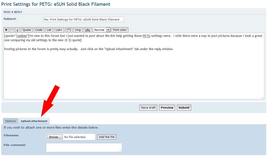

Ceebee wrote:I'm new to this forum but I just wanted to post about the BIG help getting those PETG settings were. I wish there were a way to post pictures because I took a great one comparing my old settings to the new :D !
Posting pictures to the forum is pretty easy actually. Just click on the "Upload Attachment" tab under the reply window. (see red arrow) Click "Browse" to find the picture on your hard drive, then click add file.
Then if you want you can use the "place inline" button and it will inset the picture into your type were ever your curser was. You can do this up to five times per post if doing several pictures and type. You can also just add type to the file comment section with out using the place inline button.
