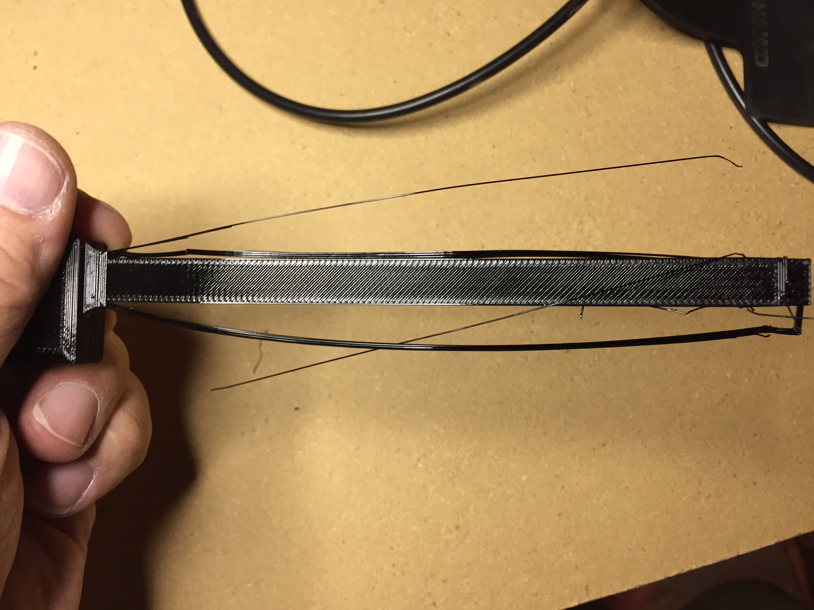

PETG strap Outline delaminations

My initial print - attempting to follow your recommendations for strong layer adhesion (e.g. Zero bed fan. Extruder = 242C. Bed = 85C.) - looked great... until I attempted to separate the (dense) strap support and the outline layers around the strap's infill completely delaminated (photo attached). I know your notes don't recommend using dense support, but I wanted to see if I could optimize the appearance of the underside of the strap (which faces the print bed).
Coupling your guidance with some layer adhesion recommendations in S3D's quality guide, I made the following changes to my S3D settings:
1. I measured/entered my filament diameter.
2. Increased Extrusion Multiplier from 0.88 to 0.93.
These changes helped quite a bit, but portions of the strap's outline layers were still not bonding to the infill or to each other. Encouraged, I made additional changes:
1. Increased the Extrusion Multiplier further from 0.93 to 0.95.
2. Increased Infill Outline Overlap from 10% to 15%.
3. Increased Infill Extrusion Width from 103% to 110%.
These changes made things worse... probably because I don't know what I'm doing. The outline delamination increased. The dense support material was stuck to the strap so strongly that the strap cracked when I attempted to separate it. Also, the print now had a bunch of fine hairs.
Any suggestions toward improving the bonding between the strap's outline and infill layers would be appreciated, and thank you so much for sharing your PETG guide with all of us.
