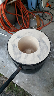

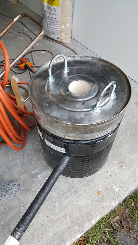

Been reading a lot and got my first furnace built.

I did DIY plaster of paris and playsand 50/50. I made some mistakes though so I'll be surprised if this doesn't crack. If it does, I plan to use commercial refractory for the next one. It's going to take a few weeks to dry this thing out though, it is really a lot thicker walled than it needs to be. Next time I'll put a drain hole in the bottom, use a fiber blanket around the perimeter, make the cavity larger to reduce the amount of refractory used and cast the thing in one pour instead of several. Plaster of paris just sets to fast to allow doing a single pour on something that large. Even with the 10 quart batches I was mixing it was still on the verge of setting by the time I was done mixing it, so I know there are air voids inside of it.Mach wrote:Looks good! Did you DIY refractory or buy commercial?

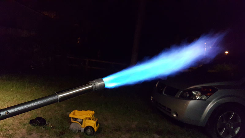

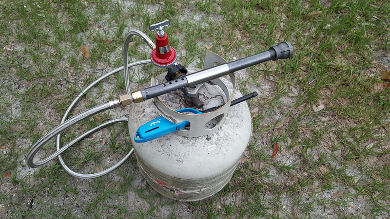

While waiting for the parts to get here for my Reil burner, I decided to design my own that could be made from cheaper parts that you can buy locally. The burner below can be made from $22 worth of parts from places Lowes or Home Depot. The regulator and braided hose I bought on Amazon, so that is not included in the price. That's a 40 psi regulator with a nice metal pressure adjustment knob that works really well. The pipe I'm using is 1/2" size, so the whole thing is pretty compact and would work well in smaller furnaces. The flame output is not small though, as you can see in the image, so it could also be used in larger furnaces. The venturi on the inside is a 1/4" compression cap, so it allows changing the cap to play with different hole diameters and the hole is perfectly centered so that you don't have to play around with trying to center it like you do those side mounted Reil burners.
