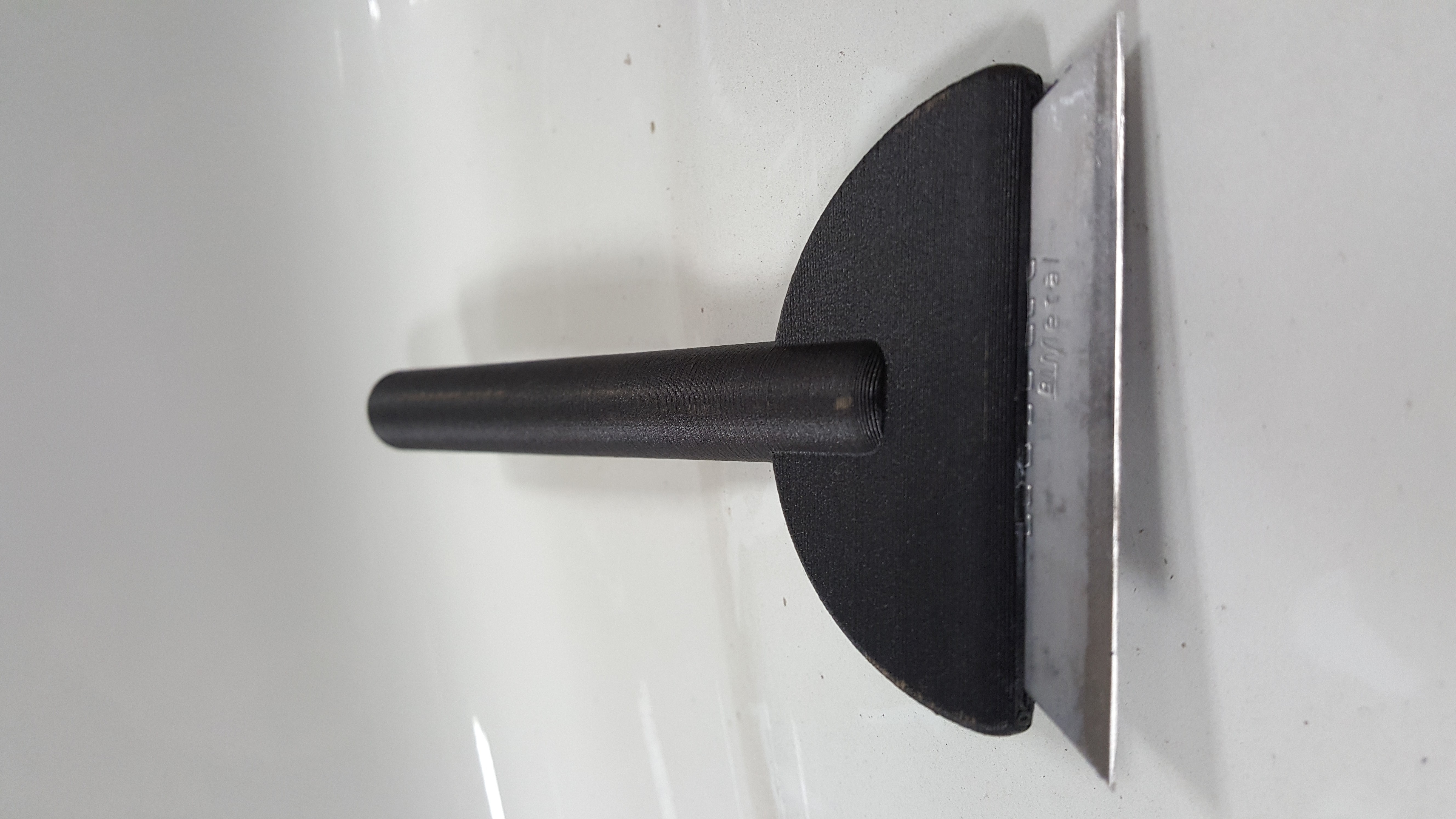

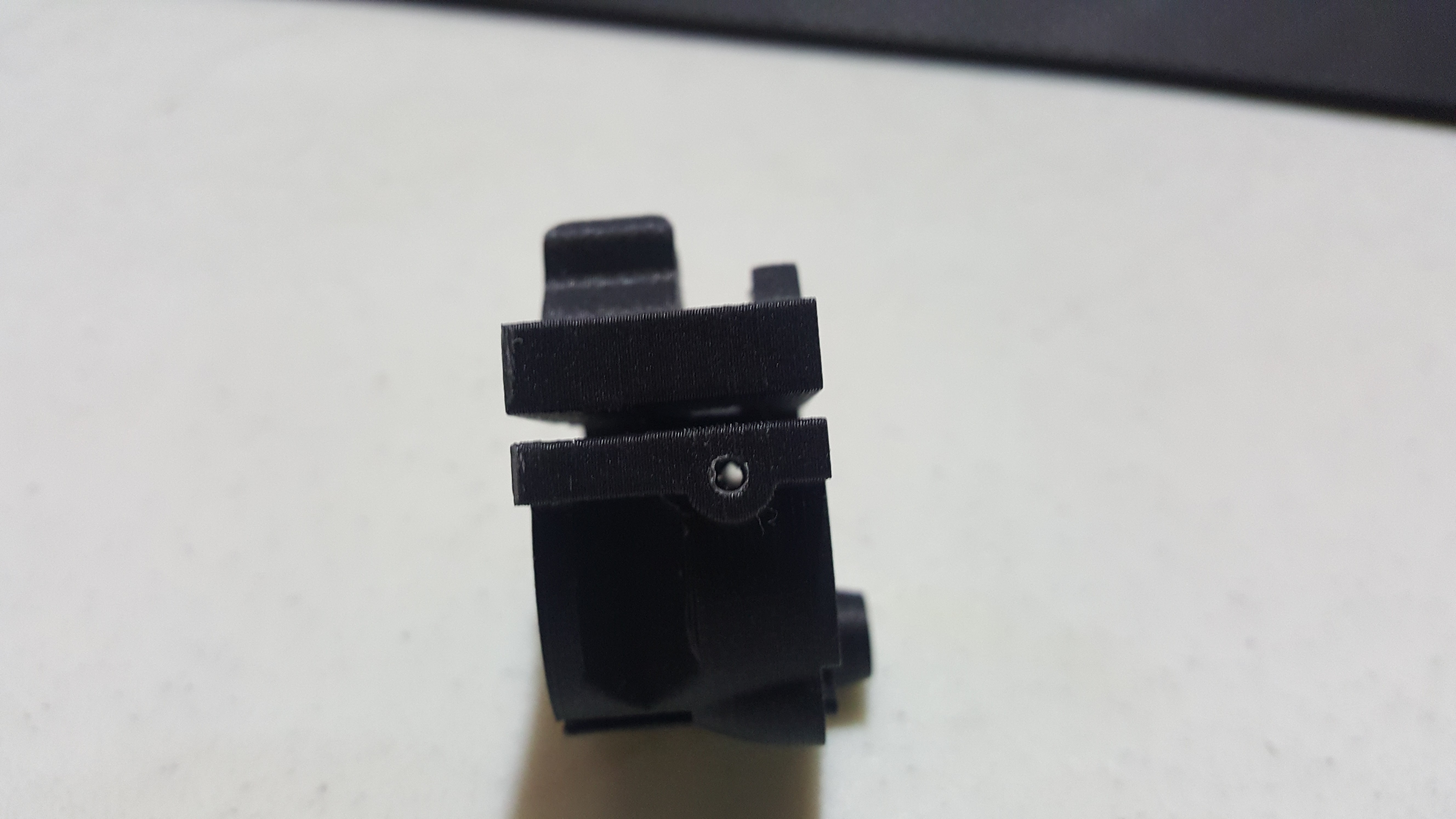

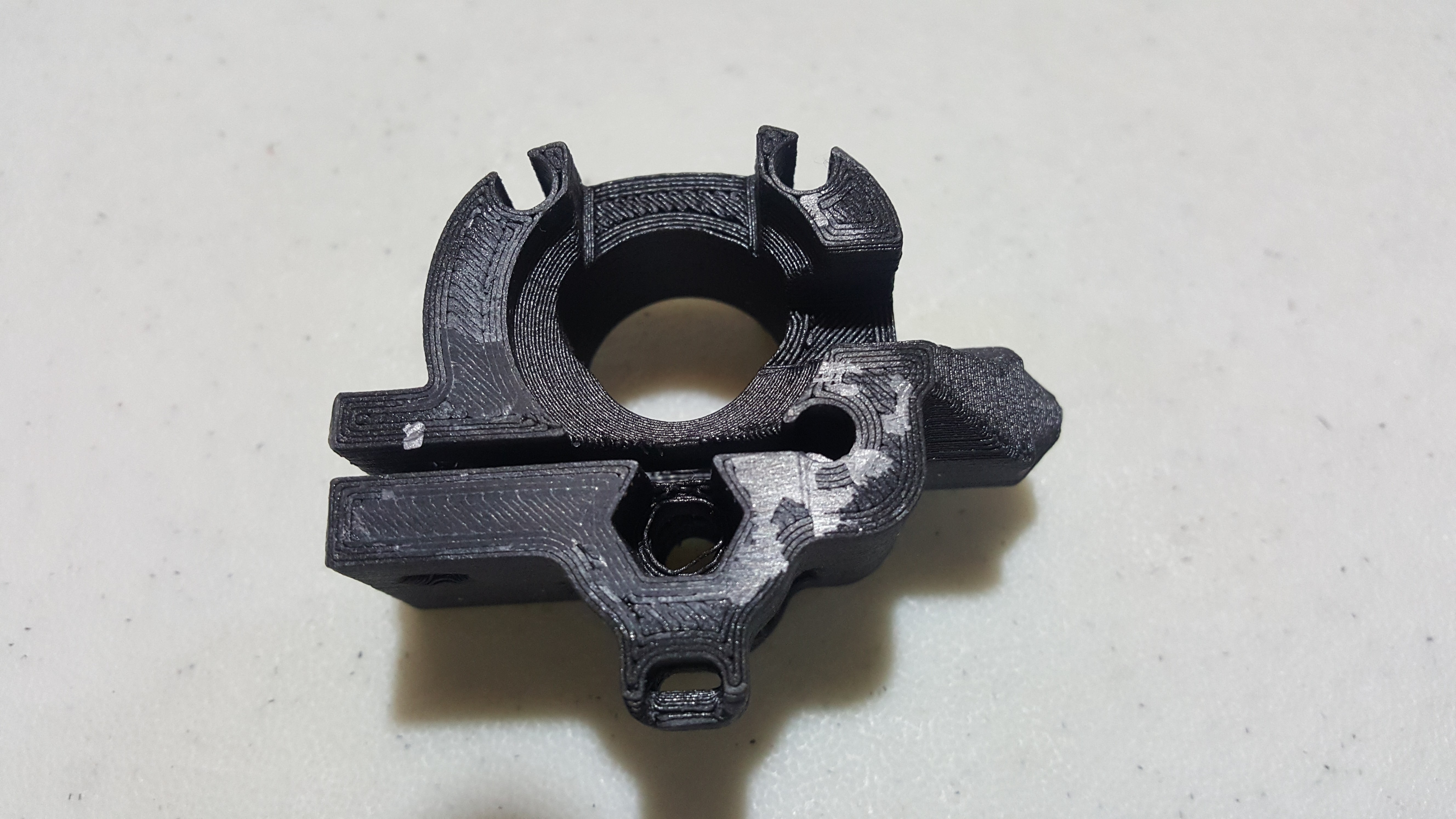

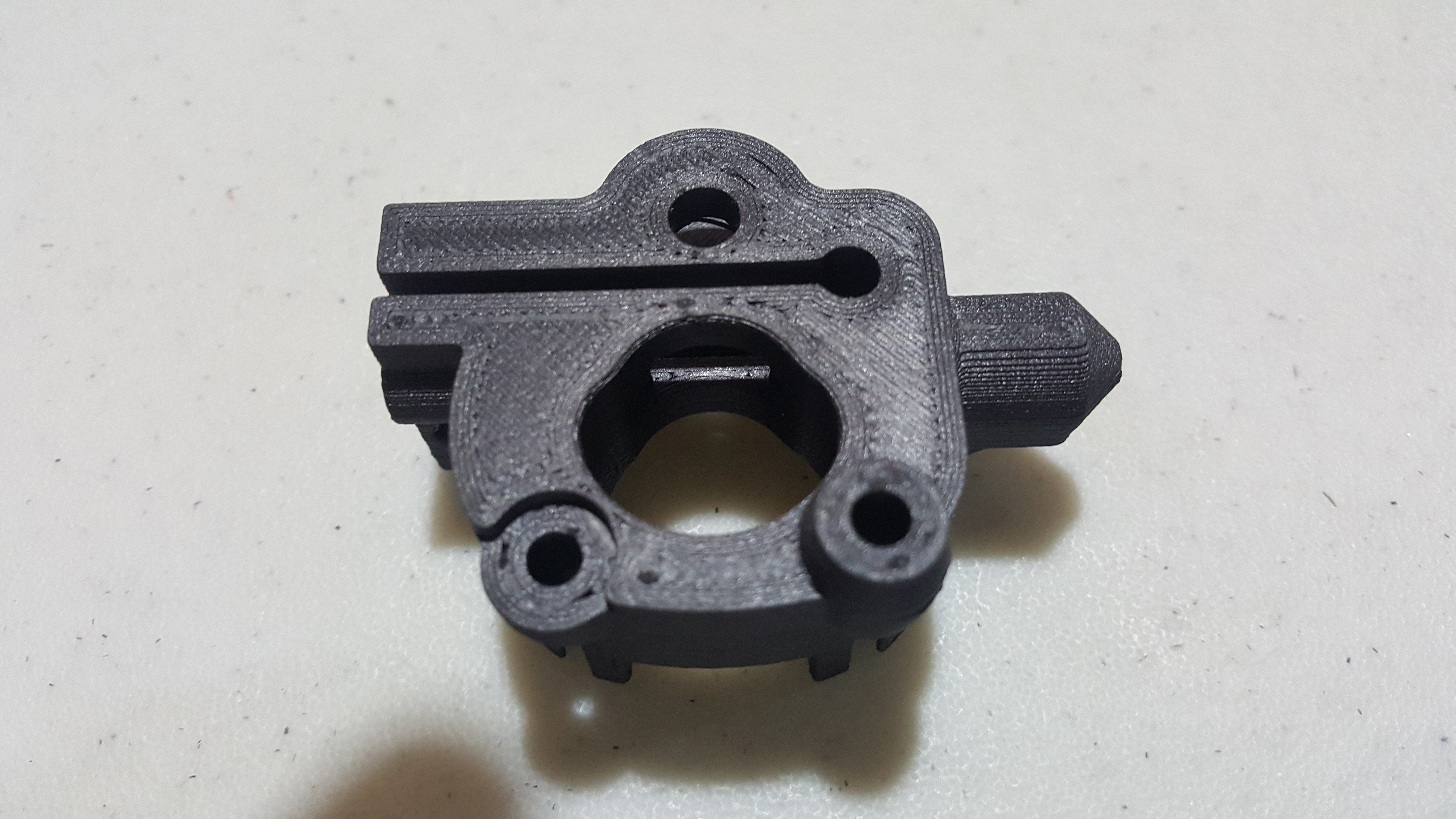

I purchased a couple of rolls of "Filament Innovations" carbon fiber ABS filament. Have printed many parts with most taking from 4 to 12 hours to print. Haven't had and breaks in the filament. Using a V4 with SS .35 nozzle on my M2 printer, no clogs either. I have printed over a roll and a half of this filament and have been very impressed with the results. I have even been switching back and forth between this and PLA filament with no issues, though I do run a piece of cleaner filament between the two. I found it on Amazon for about $40 per .8 Kg roll.

I'm using the Kapton tape for the ABS/Carbon fiber filament, and for any ABS filaments. 110 degrees on the bed, then let it cool down and the part pops right off. With the ABS/carbon fiber, I don't notice any warping. I do use a raft for the parts I am printing, and using Simplify3D, I am able to set the separation distance and parting the part from the raft once it cools down is easy.
