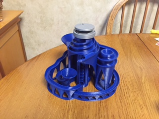

I think sometimes filament gets crossed or tangled coming off the spool. Not very often however. Jules or someone has posted a procedure for checking the drive gear teeth marks on the filament to make adjustments to the tension. I do that when I change spools. My last print ran about 22 hours, The 3D Marble machine as >http://www.thingiverse.com/thing:1340784
turned out pretty nice.
PETG for body the Gray is ABS

wmgeorge wrote:I think sometimes filament gets crossed or tangled coming off the spool. Not very often however. Jules or someone has posted a procedure for checking the drive gear teeth marks on the filament to make adjustments to the tension. I do that when I change spools. My last print ran about 22 hours, The 3D Marble machine as >http://www.thingiverse.com/thing:1340784
Very
nice! :D
