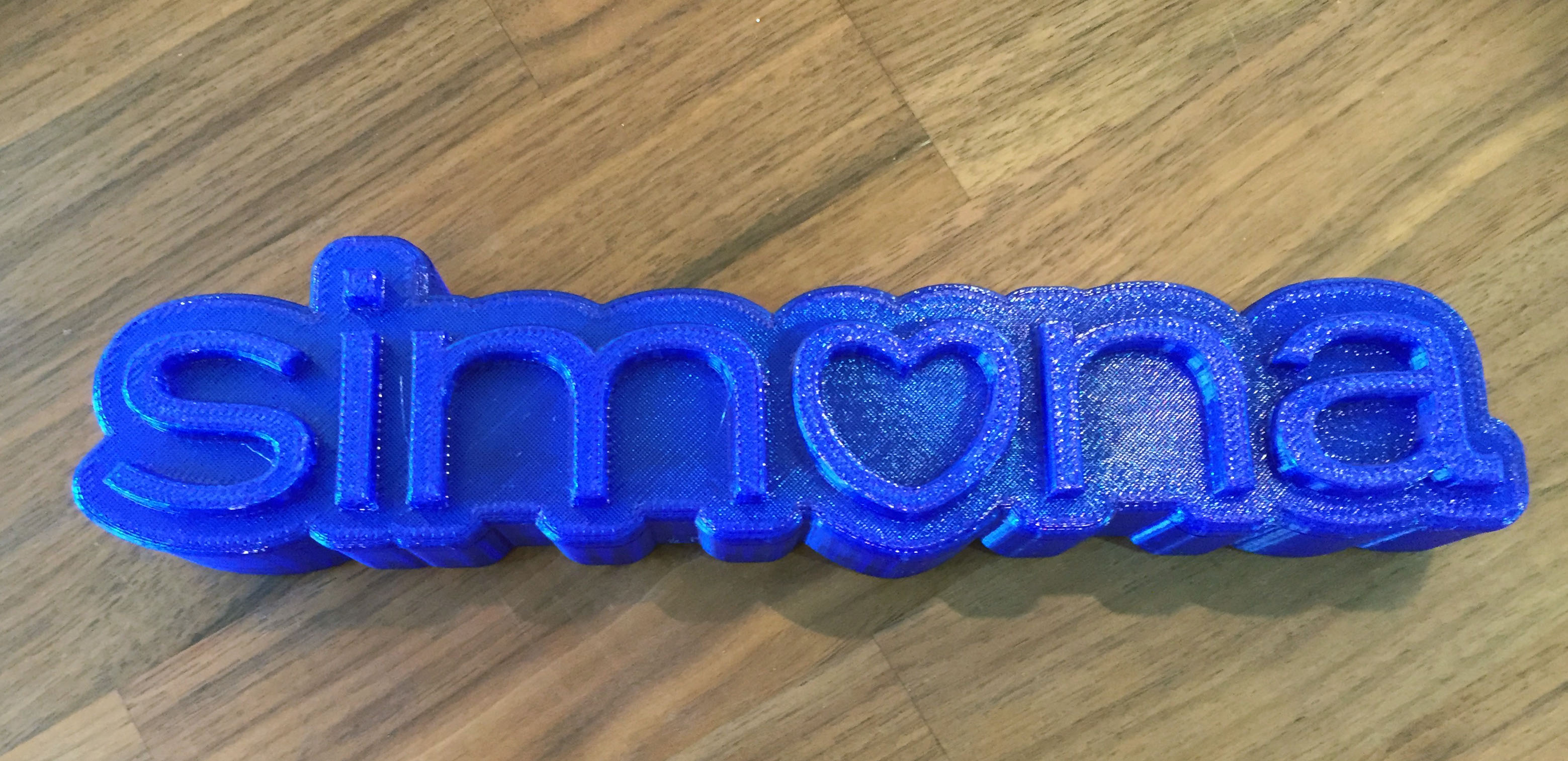

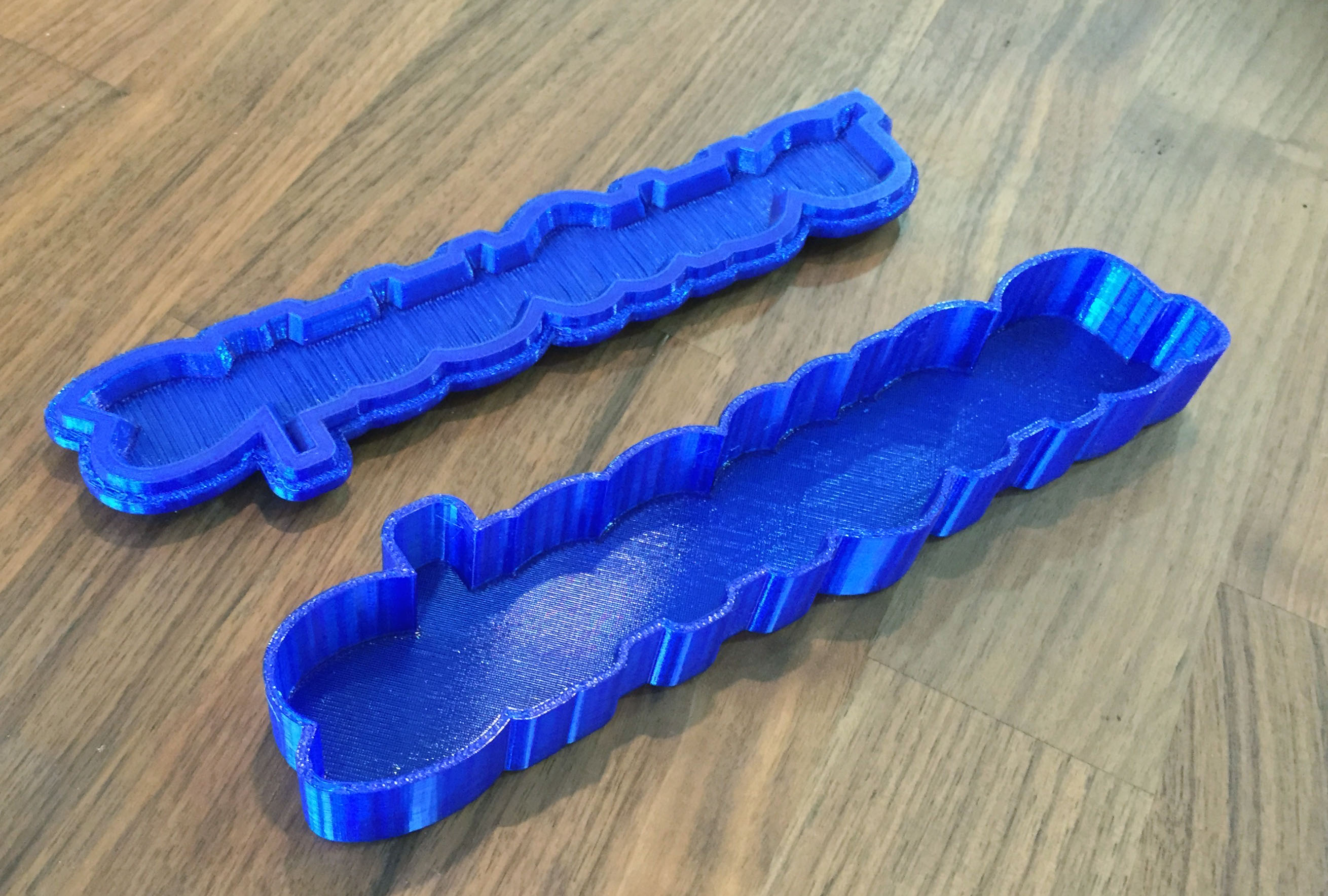

thanks to Jules' advice and settings I am now printing wonderful parts in PETG! I am never going back to PLA!
Here is a gift I made for my wife (can you guess her name?) blue translucent eSun PETG

Hmmmmnnnnn.......Alice?psd wrote:thanks to Jules' advice and settings I am now printing wonderful parts in PETG! I am never going back to PLA!
Here is a gift I made for my wife (can you guess her name?) blue translucent eSun PETG.....
Bet it's a HUGE hit!
Re: ABS or PETG
Bet it's a HUGE hit! [/quote]
LolJules, we have the same sense of humor!
