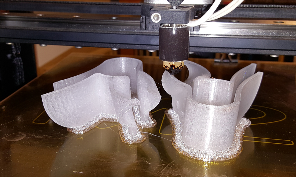

The picture below shows a print in progress using the Maker Filalment clear PETG. It's a pretty organic object with lots of curves, but can be printed without any support without a problem. Note how smooth the walls look, the layer lines just sort of melt together and you can barely see them. This print is dialed in for speed to, not for high definition. I'm printing it at 6000 mm/min with a .2 layer height and 265 extruder temp, yet there is very little stringing, no blobing and no warts. The eSun strings a lot with these settings, and has slight warts too. This is only about 30% of the object height in the image. These are two piece gussets for connecting carbon fiber tubes together at angles.

i have tried the maker petg as well. your getting the stringing with esun due to the temp. drop that the 240-245 and the stringing goes away and you still have great layer bonding. 265 for esun is waaay too high. your temp for the maker filament sounds right though. i was about 260-265 with that. other than the temp though i saw no difference between the two. i use the same settings for both and prints come out identical. i have only used black. i have a spool of that bright green also but have not tried that. i do like that the maker filament comes in more opaque colors. i hate translucents. esun only has a few opaque colors.

The stringing doesn't really bother me much since one brief hit with a blow torch eliminates them all instantly. But if the higher temp doesn't result in any additional strength on the eSun then I might as well lower it. I still haven't done any strength comparison tests using accurate methods between these various materials yet, mainly because I'm having to ship these parts off as fast as I can make them. I've had a few failed prints I've been able to do simple destruction tests with though, and in general the clear PET seems to be slightly stronger than colored regardless of manufacturer. I like that this material fractures along random lines that seem to have no relation to layer direction, giving it a more isotropic load handling ability that is not effected by layer boundaries. The same can't be said for ABS.jimc wrote:i have tried the maker petg as well. your getting the stringing with esun due to the temp. drop that the 240-245 and the stringing goes away and you still have great layer bonding. 265 for esun is waaay too high. your temp for the maker filament sounds right though. i was about 260-265 with that. other than the temp though i saw no difference between the two. i use the same settings for both and prints come out identical. i have only used black. i have a spool of that bright green also but have not tried that. i do like that the maker filament comes in more opaque colors. i hate translucents. esun only has a few opaque colors.
