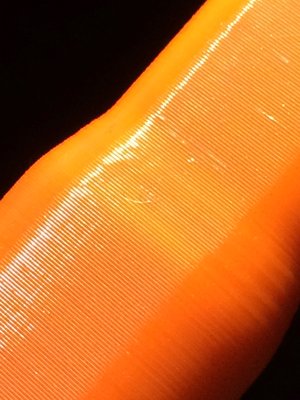

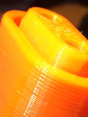

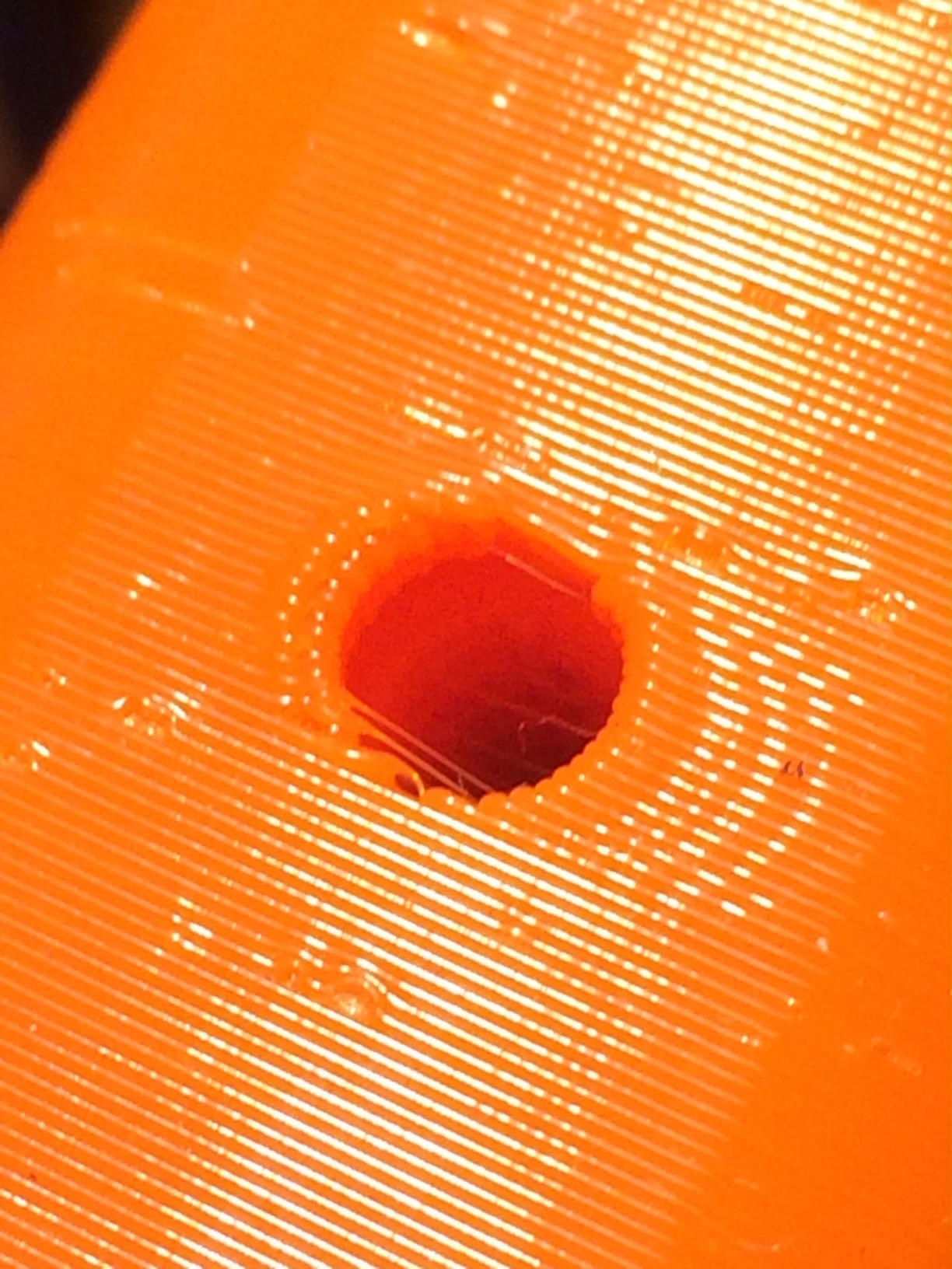

It's run well. Lately I've been running PETG with the .5mm nozzle and .3-.35mm layers. Getting super clean prints and great part strength. Yes, the ridges are pretty easy to see, but they are very pretty ridges.
Printing at 3600 mm/min - these parts have Outline Underspeed set to 50%.
This first image is the top end of a 160mm tall piece with a 15mm x 29mm foot print - printed on glass/kapton at 85C.
