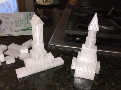

I've gone almost exclusively to PETG with blue tape and hair spray for anything complicated or Kapton cleaned with alcohol (for simple shapes with decent flat areas). Currently printing Einstein's toys with Kapton and turning out beautifully. The striations are due to transparency from 30% infill. The surface is very smooth.
https://all3dp.com/release-your-inner-e ... enius-toys
[img]Einsteins_toys.jpg[/img]
I started with PETG with the M2 and thanks to Jules setup suggestions I was able to get it to work and have been refining for a number of months. At this point it's pretty much start the printer and walk away, as long as there is enough base to stay stuck. :)
