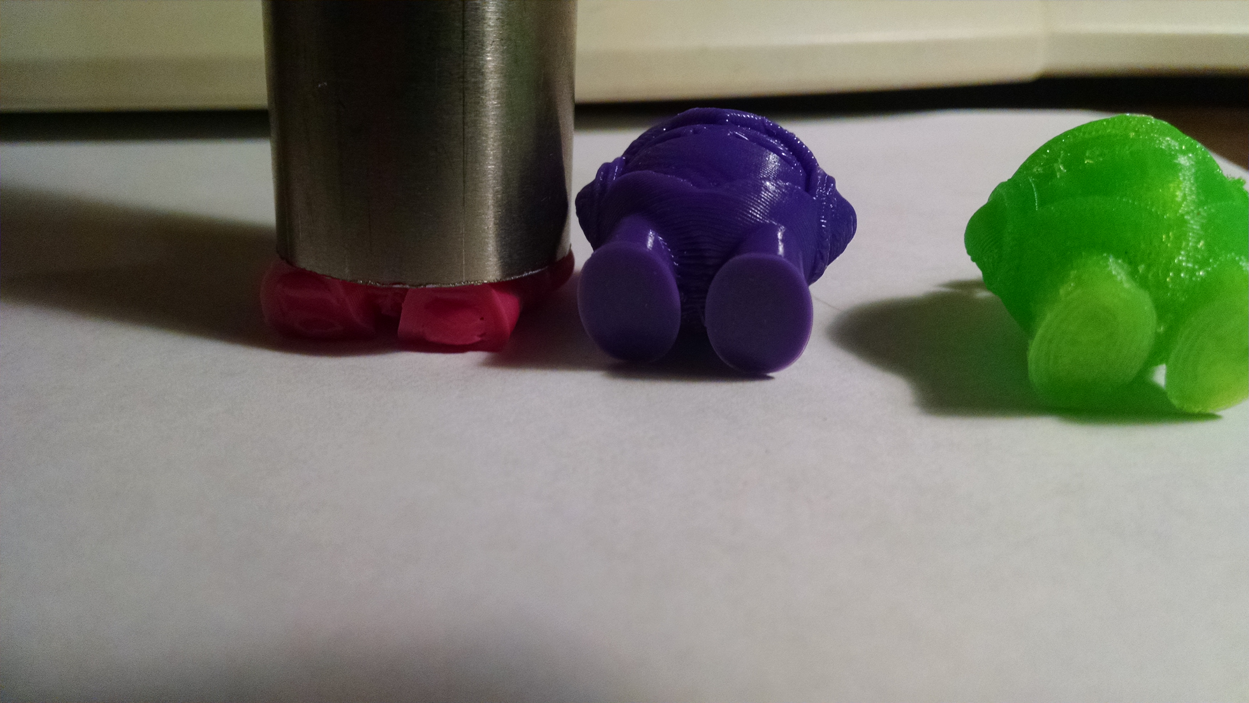

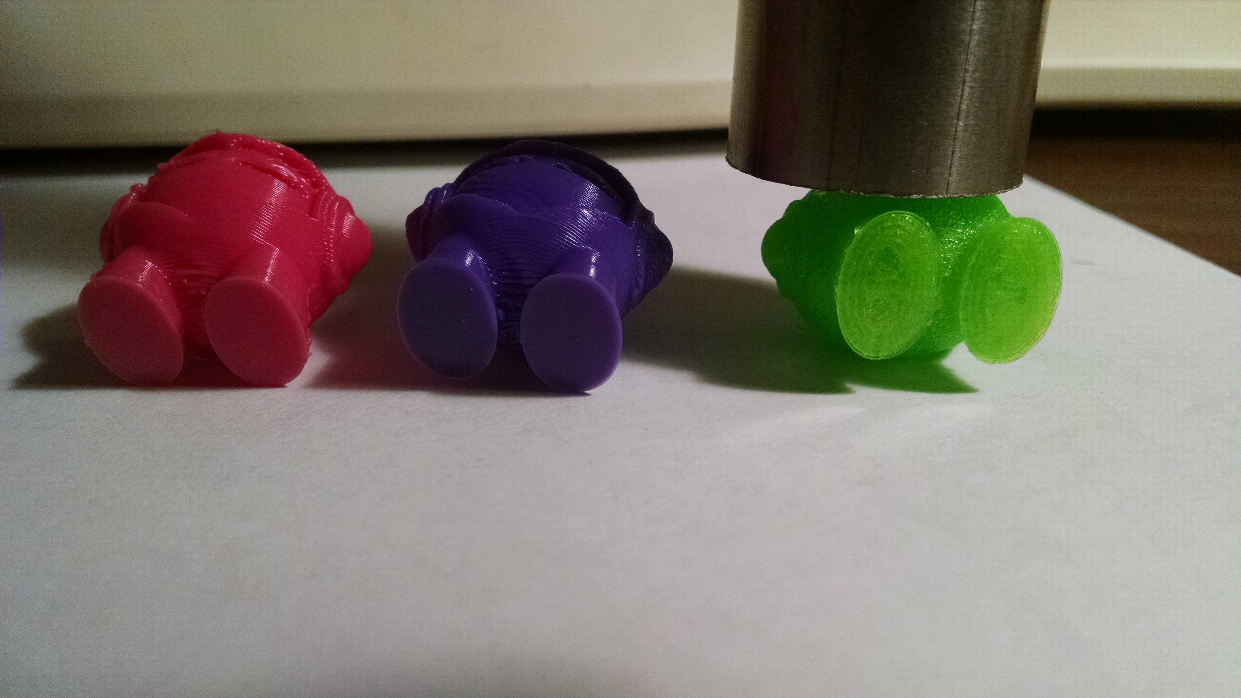

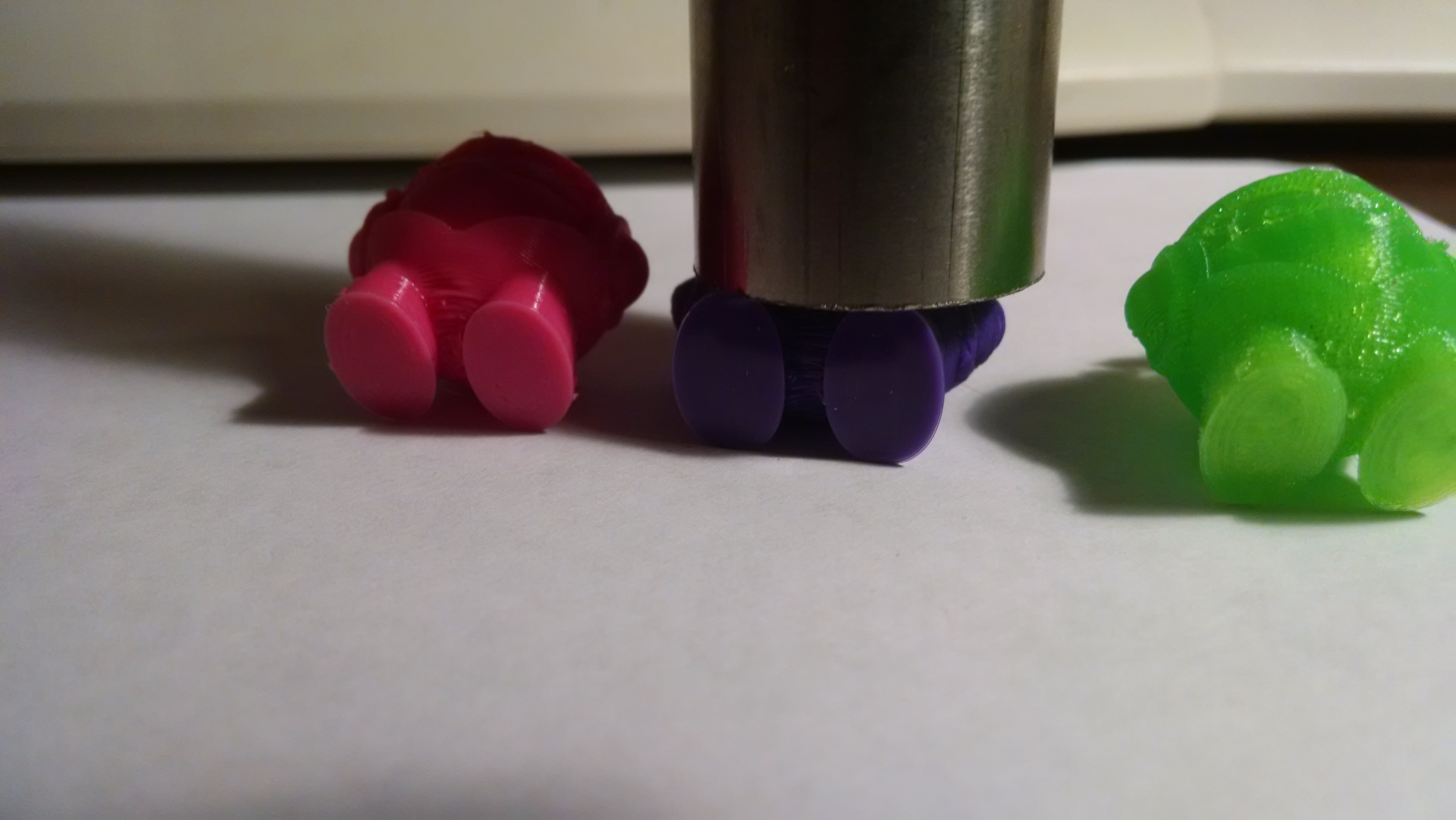

Post by Phil » Thu Nov 17, 2016 12:03 am
I just printed Ninjaflex Flamingo, (most dudes call it pink), Sain Smart TPU Green, and MakerFlex Purple. I printed them all with the same settings; the flexibility differences are huge, with the Ninjaflex being the most and the Sain Smart being least. I mean a REALLY HUGE difference! The Sain Smart TPU flexes slightly and did not print particularly well; the MakerFlex is much more flexible, but the Ninjaflex is like soft rubber. I used a 0.50mm nozzle for all.
