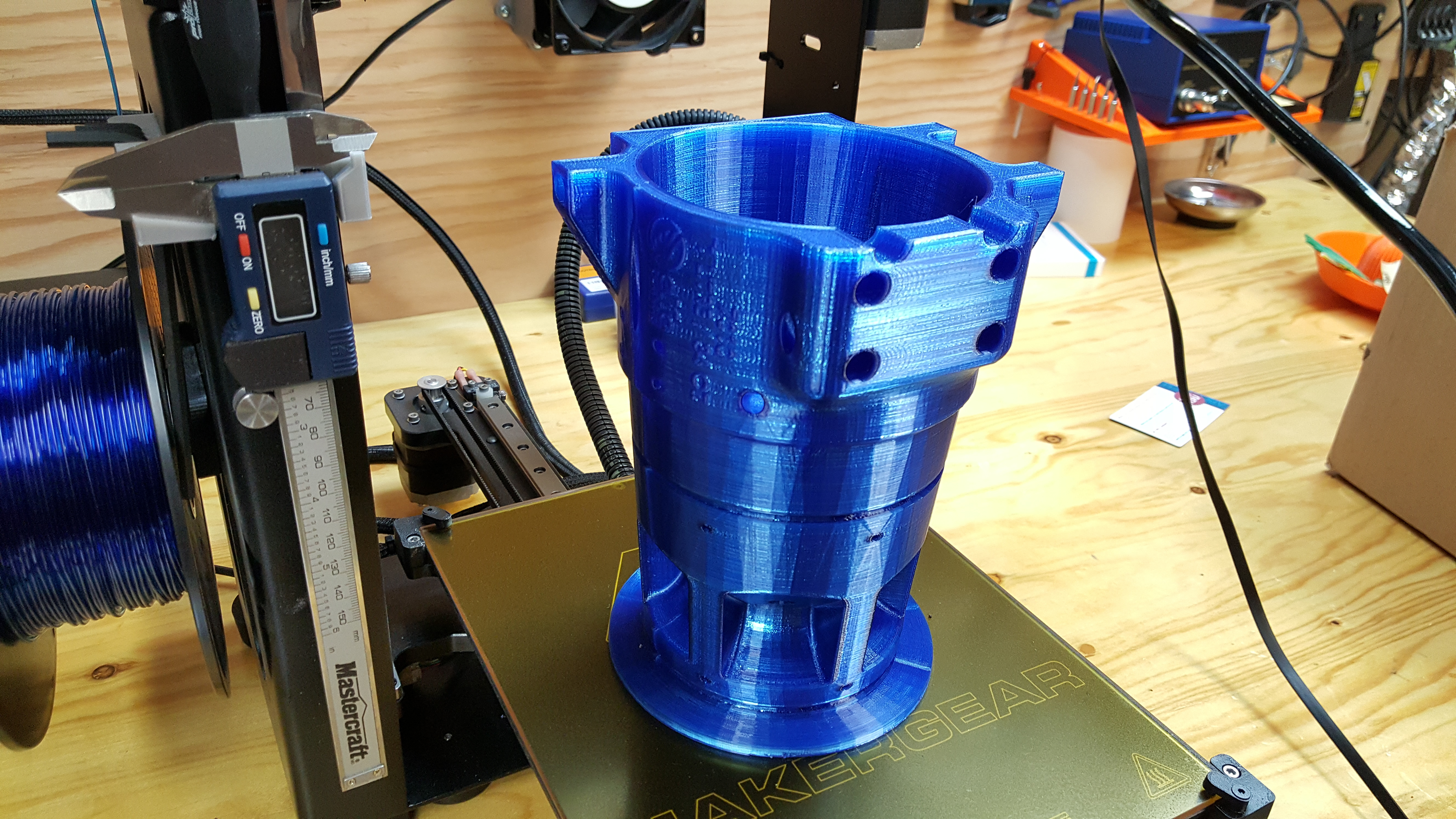

Here's my 70 hour print in PETG!
That thing reallys is filled with air channels. I am going to use it to insert labels into injection molding molds and then pick up parts.

I am running into some issues though. I was worried this could happened and should have run some trials first, but I was optimistic.
My air channels are sadly not air tight. I need to find a way to solve this.

Yeah, you're going to have to seal it somehow. 3D printing isn't air-tight.
XTC-3D maybe? Or spray varnish? Hmmmn......

yes 3d prints arent water or air tight. atleast not 100%. you could maybe dip it in epoxy but that would be really expensive, messy and a pia to make sure the epoxy doesnt run, collect and end up blocking one of you air channels.

I have some EASY CAST 2-part epoxy I got at Michael's craft store. It's low viscosity and paints on pretty easily. The down side is the long cure time. I have used that to seal up some areas of PETG parts. It's thin enough you could probably pour/syringe it into your part and then pour it out if areas are inaccessible. An air-blast through the ports would probably work to clean out excess.
