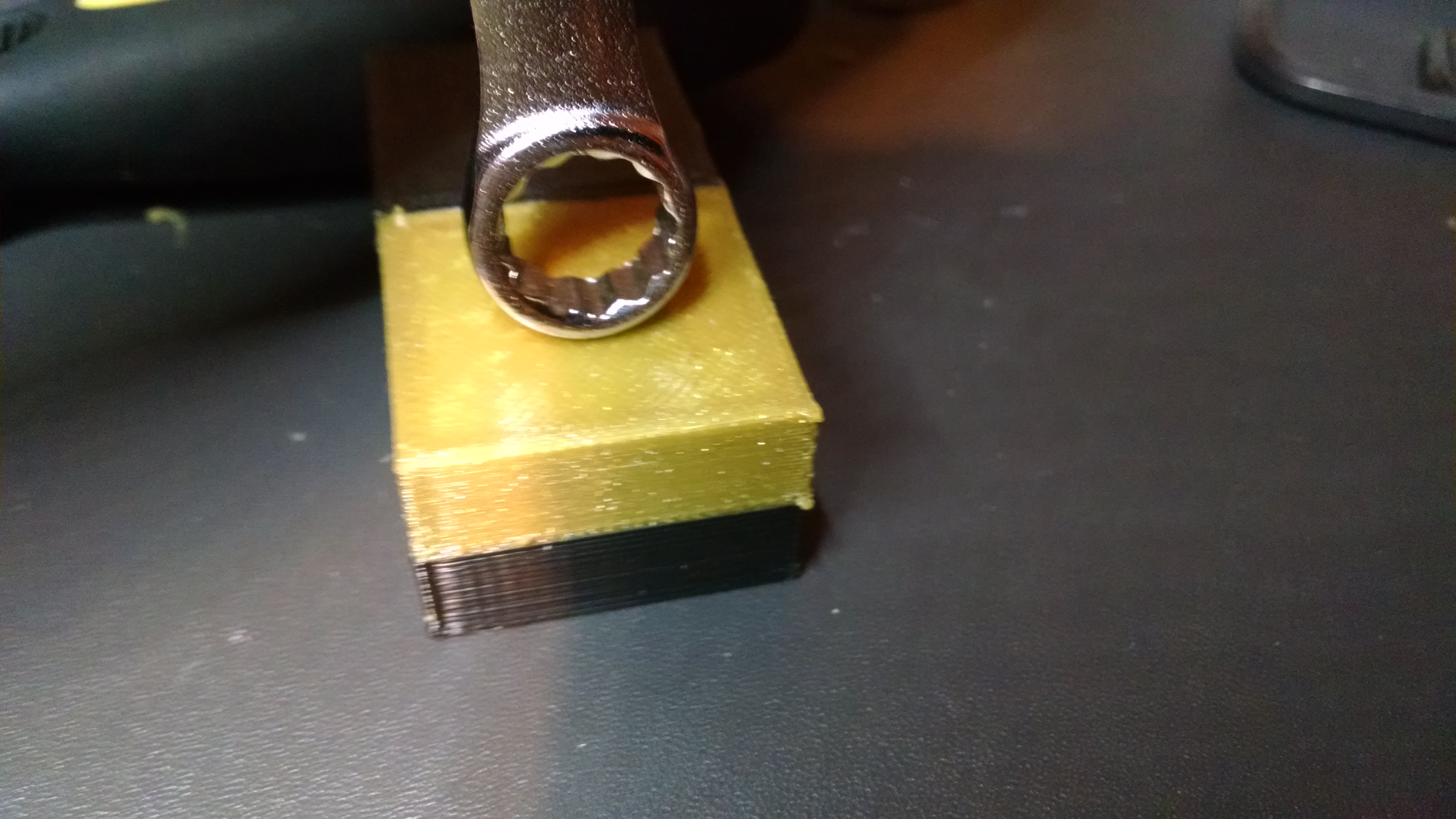

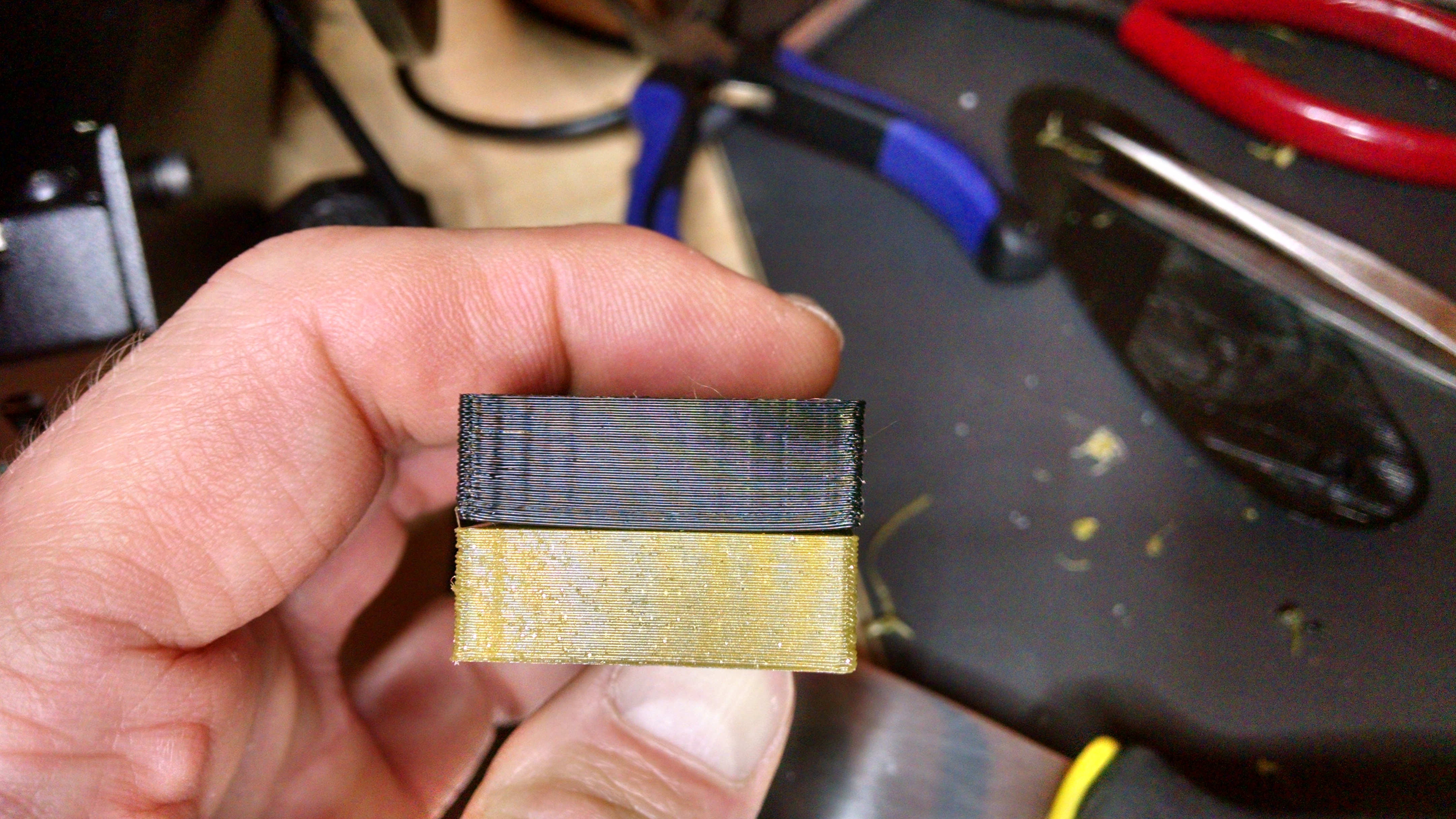

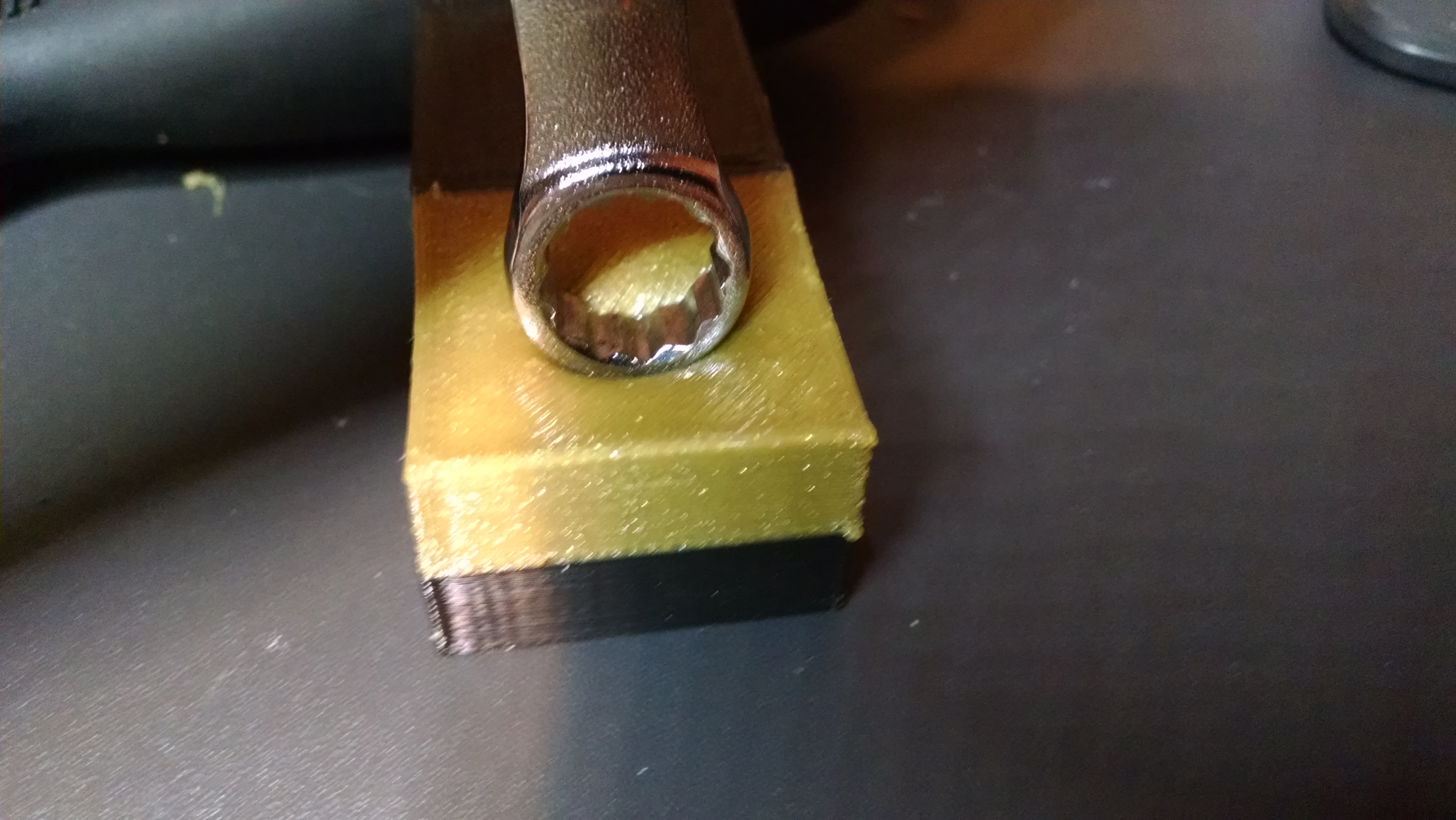

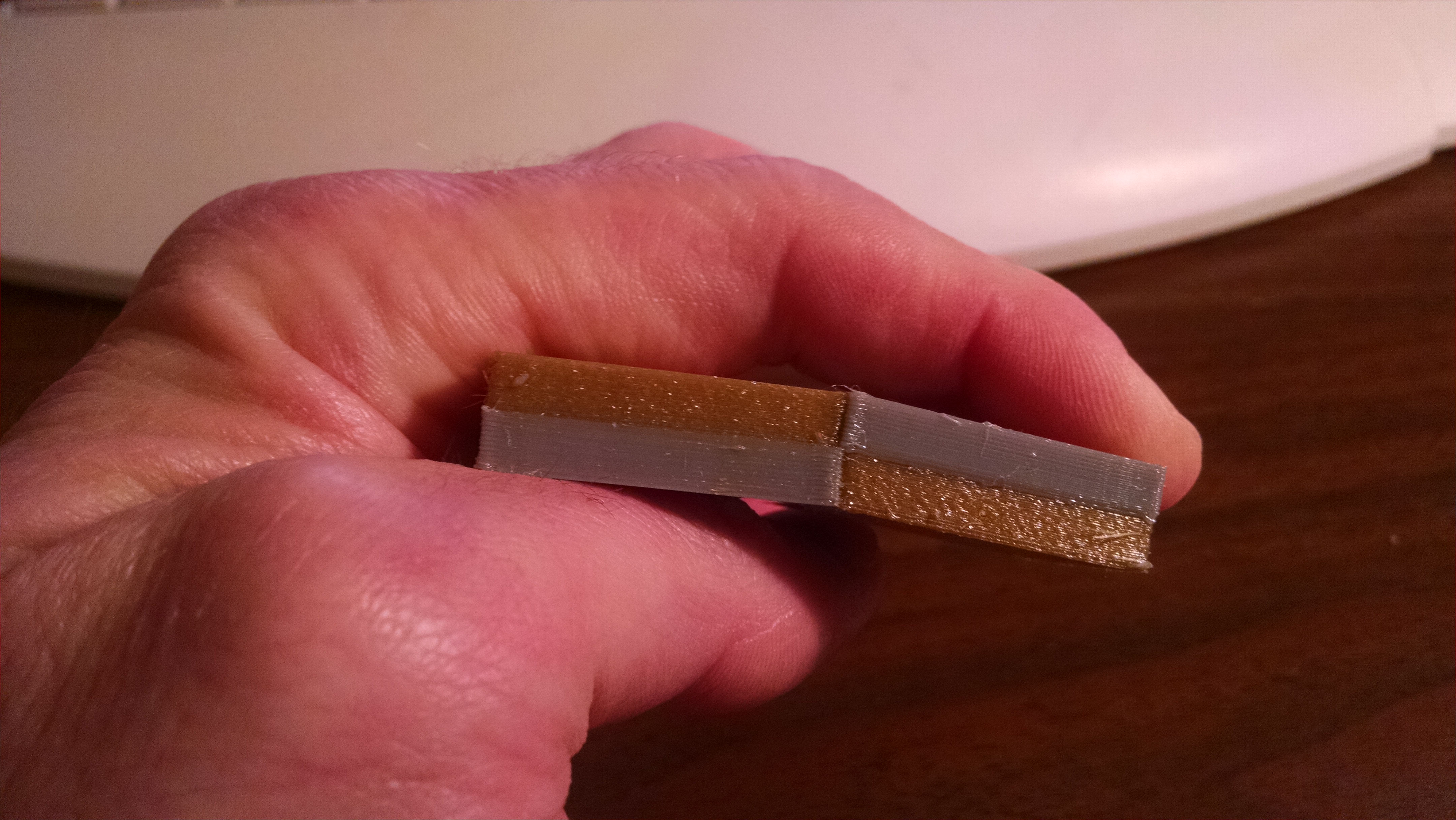

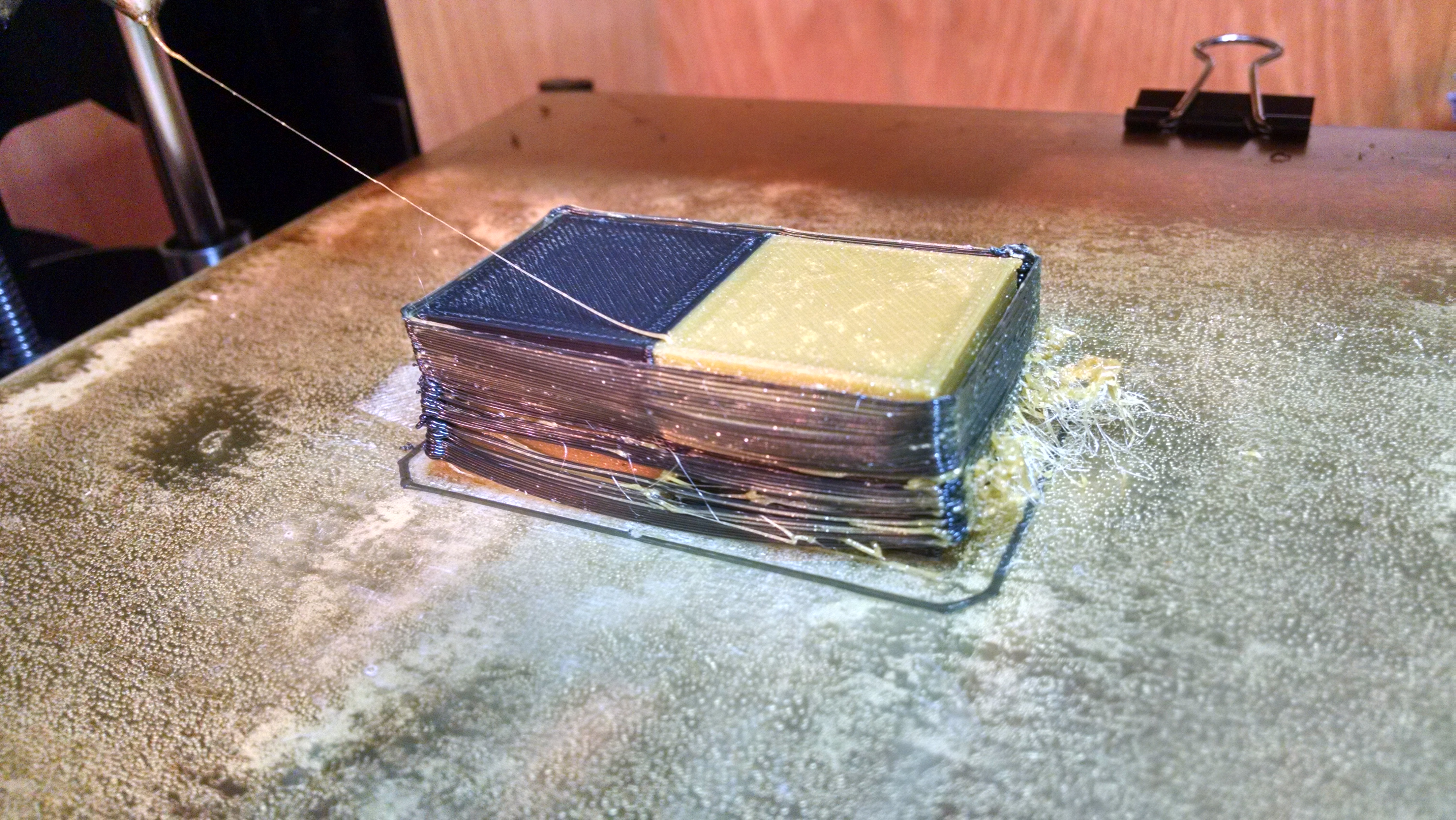

I wrote earlier about "What sticks to Ninjaflex?" I can definitely now say ABS is one. Notice in the following pictures that you can build Ninjaflex on ABS, but you cannot build ABS on Ninjaflex; it warps away from the bond. I used a rectilinear fill on this one; I think the hex fill will actually be better, since I could see flaws in the infill during the build due to the stringiness of the Ninjaflex. You can see how stringy the Ninjaflex is, as the gold build up on that side of the ooze shield. The blocks are 30mm X 30mm X 10mm. BTW, I always use a 0.50mm nozzle for flexibles.
No separation here.
Good cushioning.
Notice the separation.
Ooze shield scrapes off the strings.

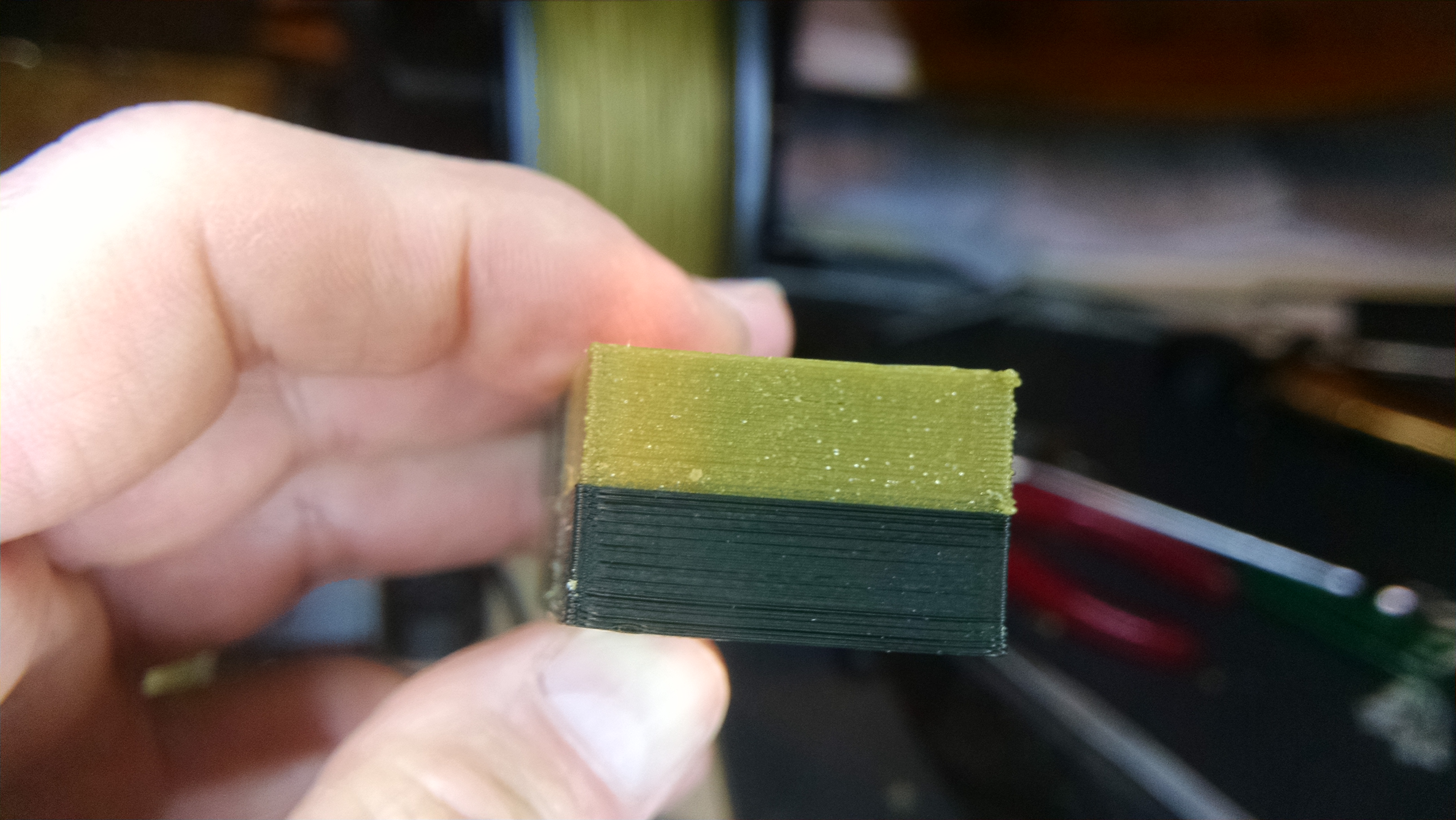

Ninjaflex sticks very well to PETG. I made this with 15% hexagonal fill, which makes it comfortably spongy. You can also see how well it sticks together under tension. Sizes are the same as last, except heights are 1/2.

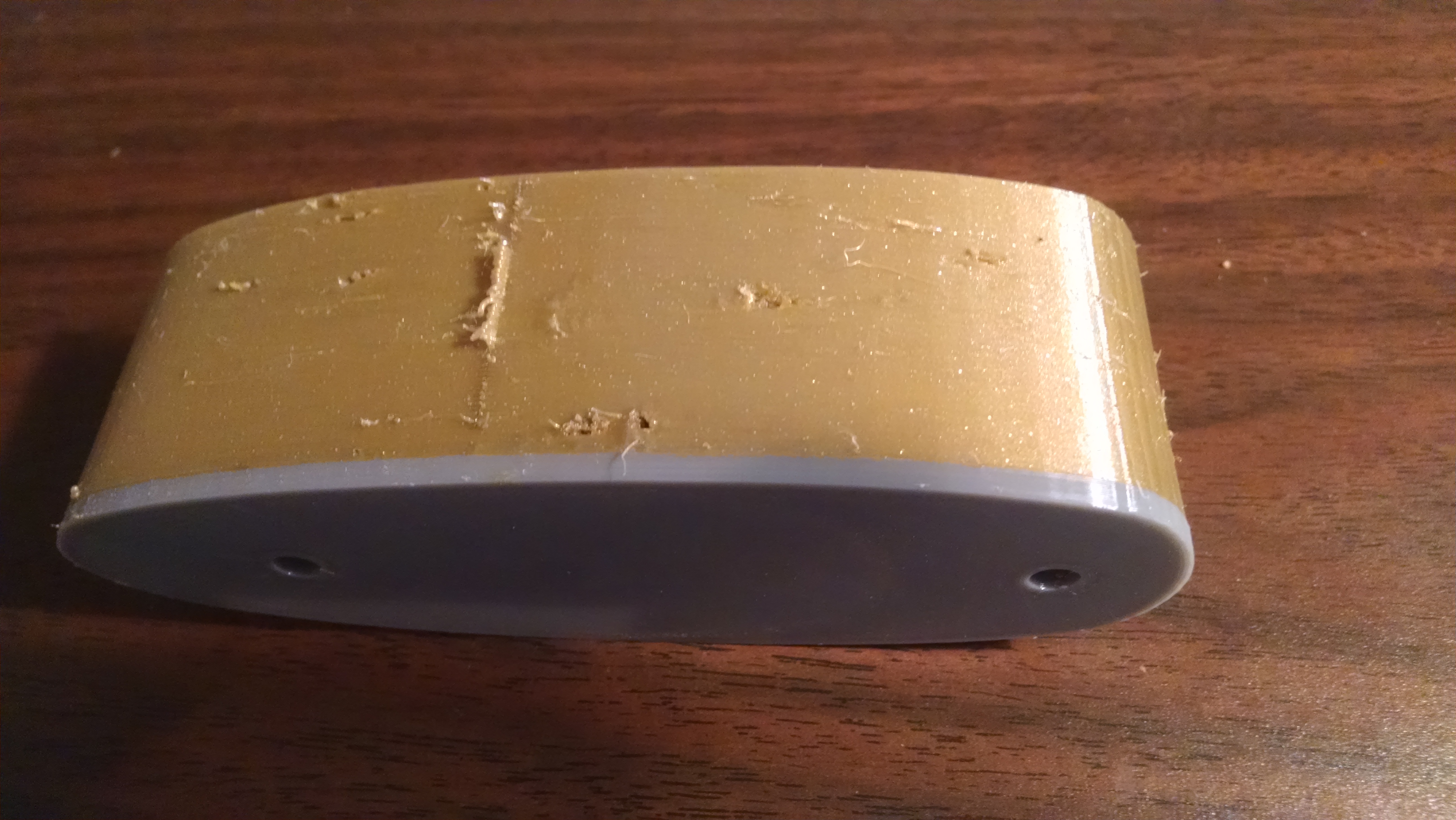

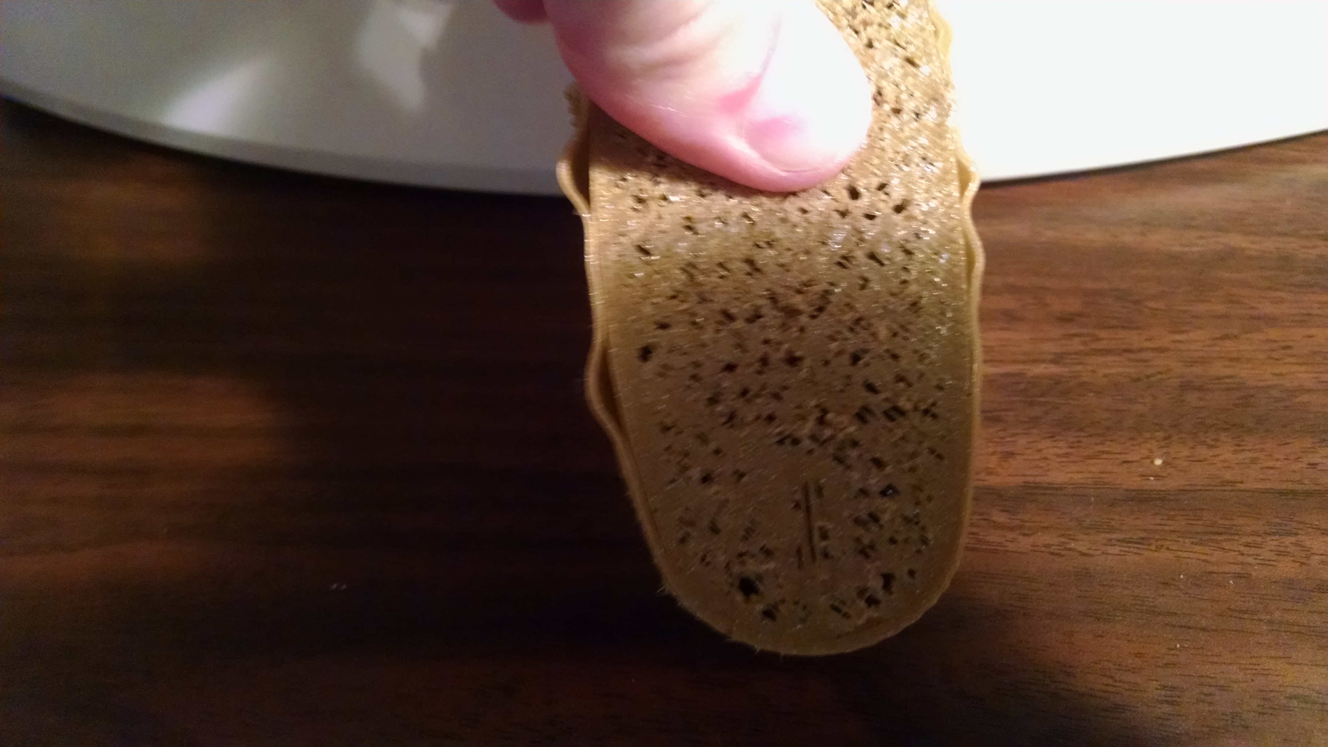

This large piece of Ninjaflex did not come out as well as I would have liked. I might have it a little too hot, 245C, so maybe that is why I get so much ooze. I had the top layers set for 4, so I do not know why the crappy top. (BTW, I should have remembered to put a chamfer on the edge.) I was also disappointed with the delamination of the sides when bent. The piece is not very soft, and I can stand on it without squishing it much, even at 15% infill.
The good side is that the sides feel very durable and suitable for the intended purpose, a shotgun butt-pad. I will have to redesign it not relying on low-percentage infill for the absorption, but specifically making structures to do so.
