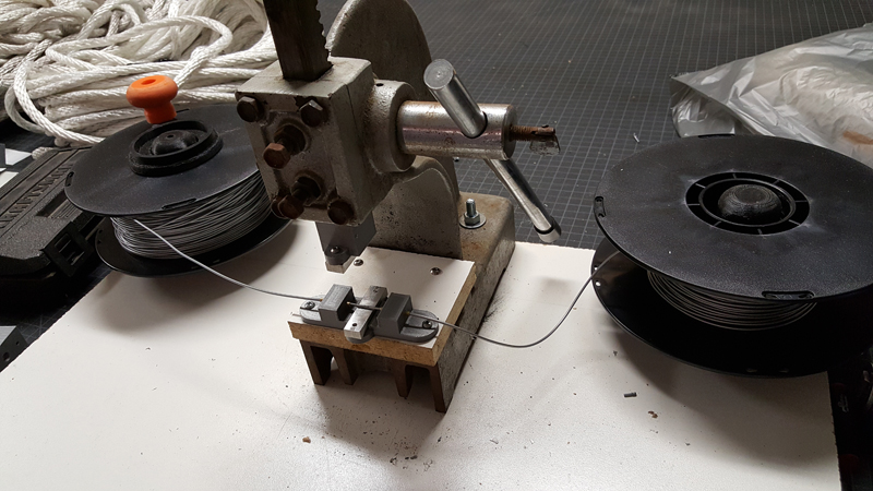

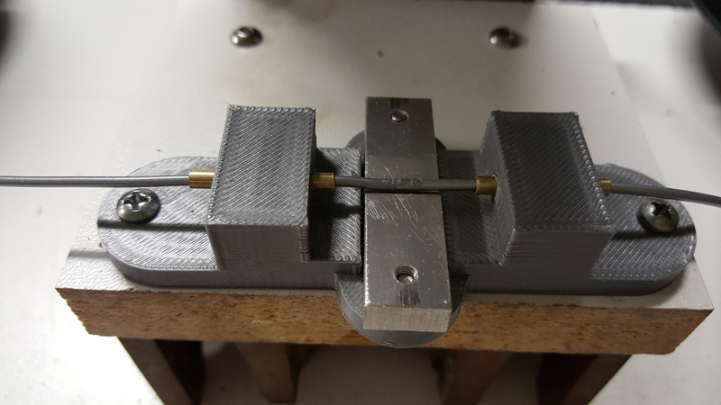

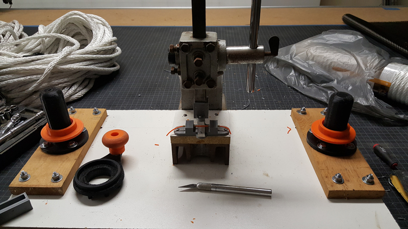

So I FINALLY got around to figuring out how to build one of these! It was harder than you would think it would be. The two issues here is that 1) heat has to only be applied at the two ends to be connected and nowhere else and 2) how to get rid of the excess plastic that mushrooms out when pushing the ends together. What finally worked is compressing the joint immediately after melting them together in a precisely aligned mold that has an exact 1.75mm channel in it that perfectly fits the filament and squeezes out the excess plastic into a thin set of wings that are easily trimmed away with an exacto knife. Note that this is a good use for Mic6 plate scraps if you ever made a mic6 plate, as the super smooth, flat surface is ideal for the molds parting surface.
The next step is to motorize the spool winding, as hand winding thousands of feet of filament from one spool to the other is time consuming and tedious.

How are you melting the ends together? I bought a heater cartridge and thermistor with the intentions of making a heated mold block like yours but am now wondering if that is overkill?
pyronaught
Posts: 684
Re: Filament Splicer
Post by pyronaught » Wed May 17, 2017 2:07 am
I just touch both ends to a soldering iron and then stick them together and quickly press them in the block. The block needs to be cold so that it solidifies quickly. The strands can be moved through the brass tubes and the ends will be pretty aligned so all you have to do is slide one piece while holding the soldering iron with the other hand. The joined filament is then pulled through the tube, so you will know if you messed up the joint right away rather than finding out when it jams in the exturder. I use the same brass tubes as entry and exist sleeves on my extruder to prevent erosion of the plastic.
