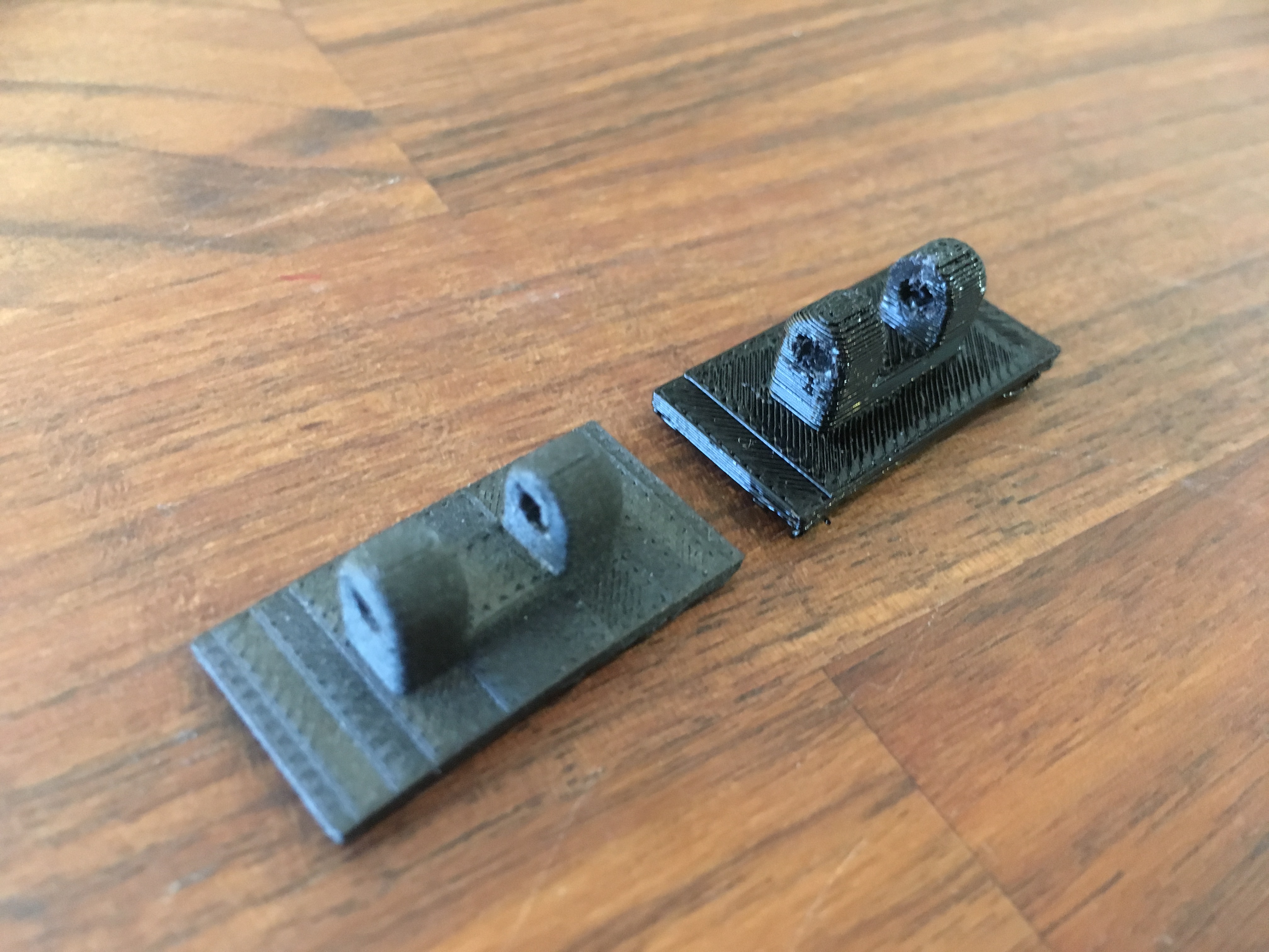

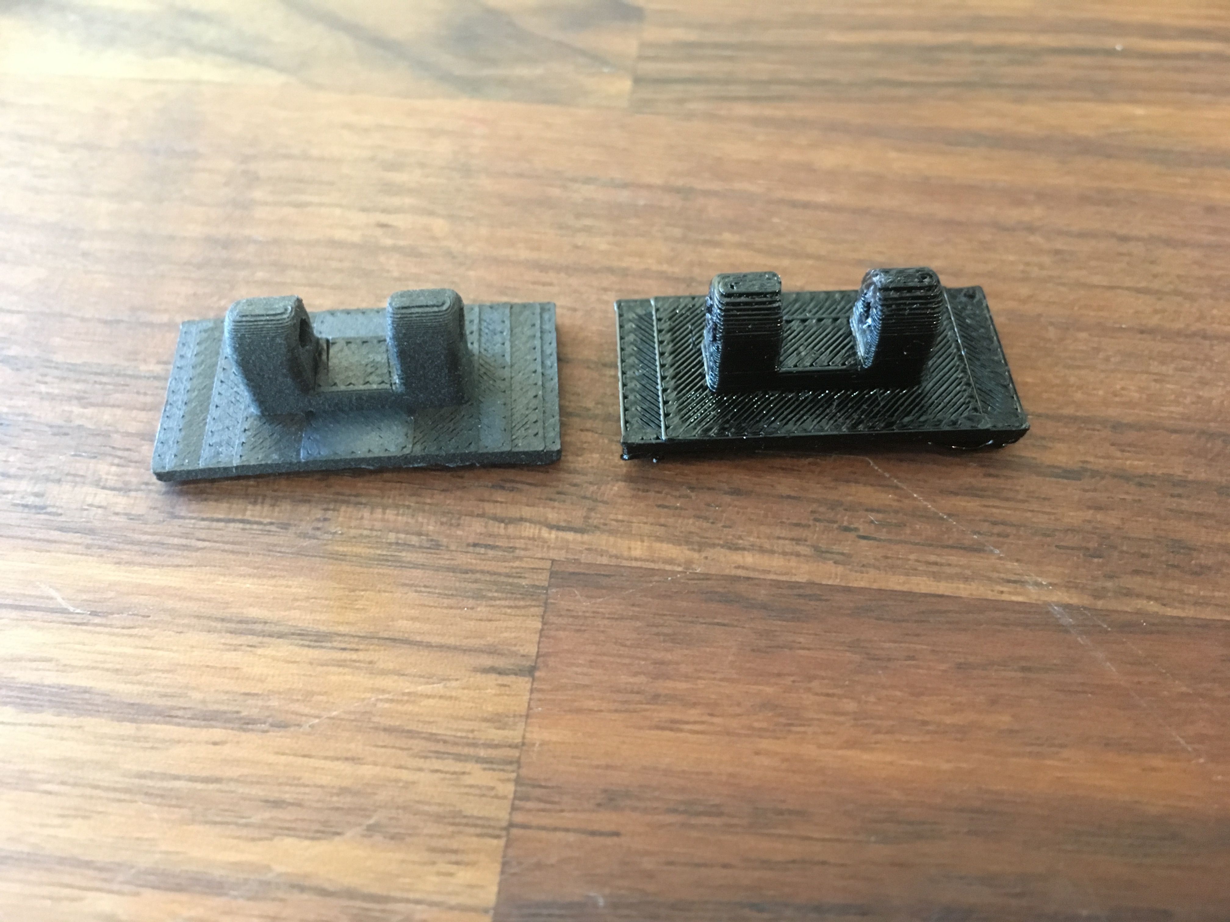

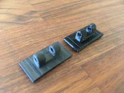

I am attaching images of test prints, in the first it is a part of a very small hinge element, and with PETG (right side and very shiny) I had surface defects, the holes were filled with support that I had to drill out and eventually ruined the precision of the part. The CF PETG (left side matte finish) gave great dimensional accuracy and supports removed cleanly.

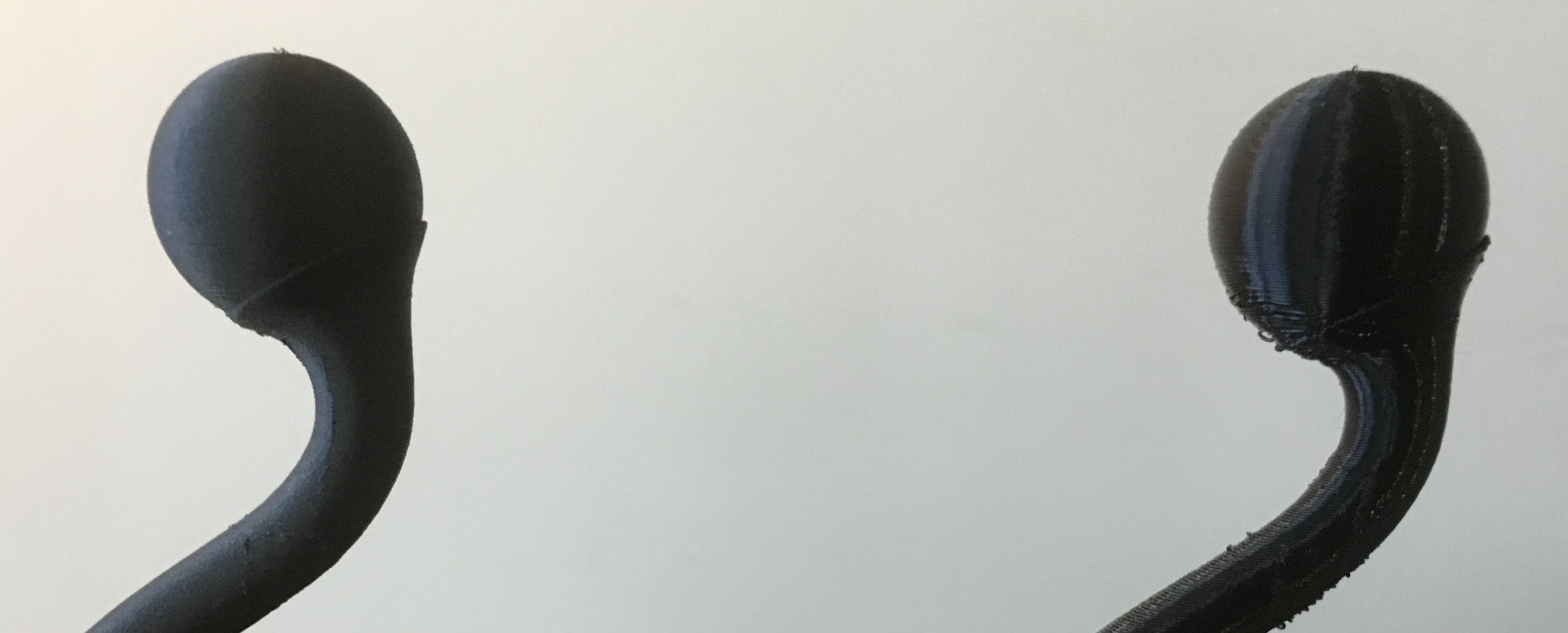

I also tried some prints of objects which needed a great surface finish and blasted the pure PETG print out of the water (sorry I cropped this image but the product is in development now, will publish full images once the client goes public)
