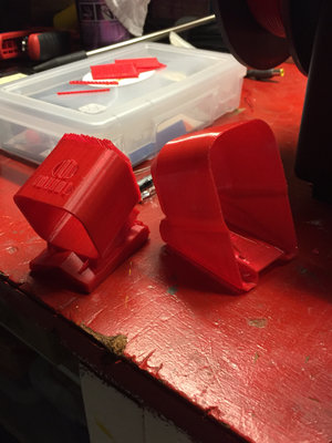

I did my first print with Cheetah last night. I used my (Jules mostly) PETG settings with modifications indicated by Cheetah specs (temperature, etc).
I was very surprised to get a nice print - simple rectangle on the first try. I expected to have to make several attempts. I'm looking forward to doing something more complex this weekend - a drone housing for a GoPro. Anyone have advice for bridging success with Cheetah? Also on an M3
I added the picture. ragged edges are support that hasn't been pulled off. Support comes off nicely. Was necessary due to small height differences between the top and bottom parts that are connected. We aren't sure what the hood-like piece is... just came with the stl.

Cheetah bridges super easy. Really you dont need any special settings.
