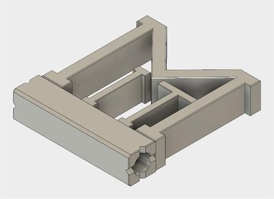

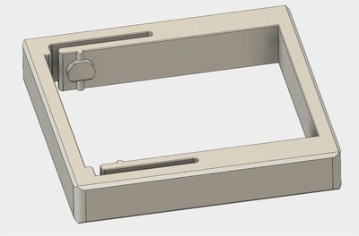

Tuning the snap feature is basically a matter of adjusting the length of a slot. Here are the two pieces involved:
There is an outer frame with two snap arms. Each arm has a stud that fits into holes on either side of the middle piece. There are detent features which should lock the middle part either laying down in the frame, or standing up.
I want the spring arms in the frame stiff enough to hold the middle piece securely, without fatiguing & breaking over time. PLA+ is more flexible than straight PLA, but it is also stronger & less brittle. I've got it dialed in pretty well for PLA+, but I'll have to start all over again for straight PLA. I can easily get it so it snaps into place OK, but how long it will hold up in use is another question... I'd prefer not to have to replace these very often.
