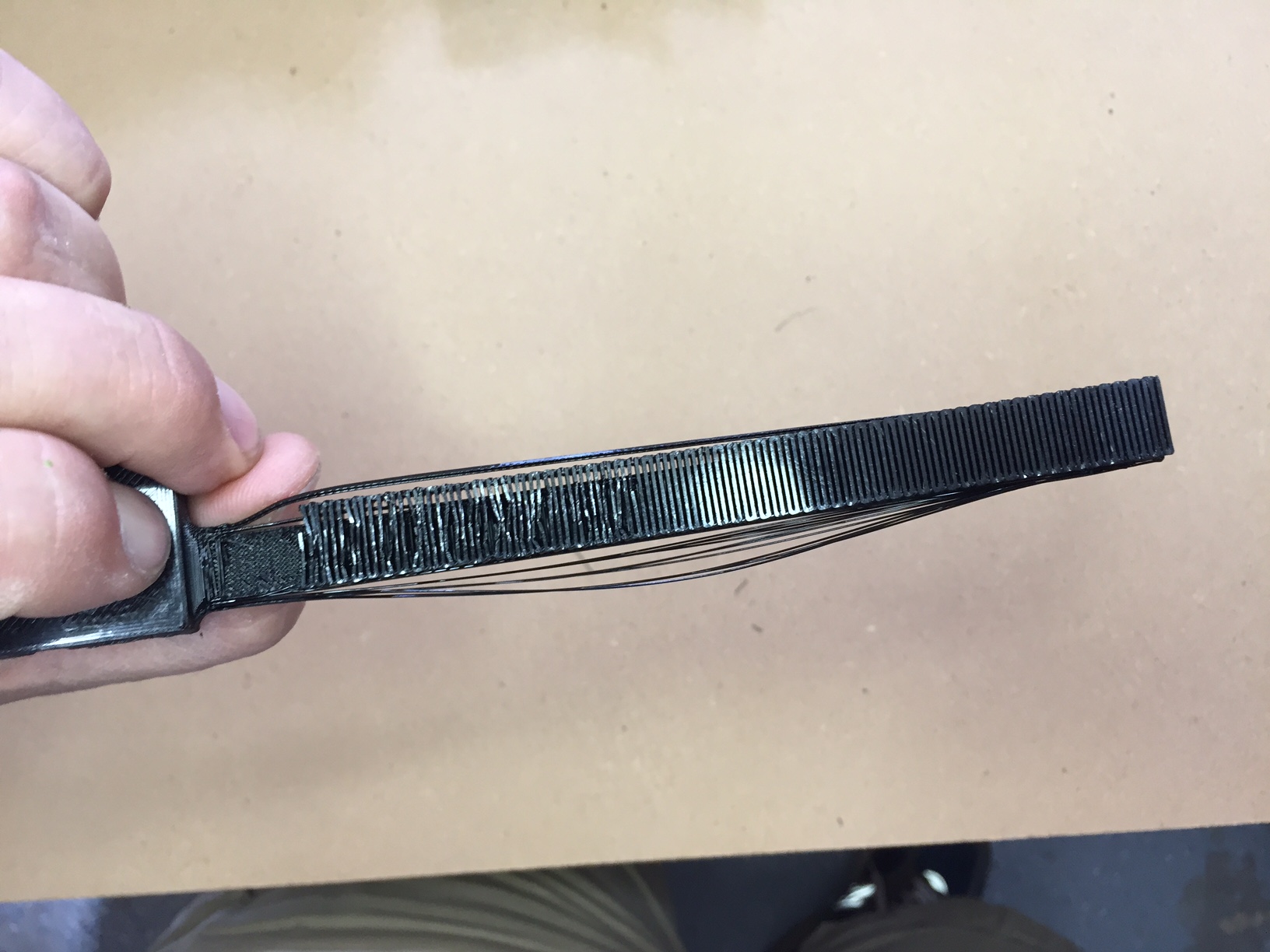

Strap bottom showing support material and delaminating shell layers

Still hard to see from that orientation. Does the bottom of the strap have a rounded edge? I expect the delamination occurs where the support doesn't reach as close to the strap as it does on the strap's bottom surface, so the outer perimeters are not as well supported. If they sag just a little bit, there will be a gap between the filament threads and they will pull apart easily.
S3D's support structures are great, but they aren't perfect, and you might need to do some serious tweaking of the support parameters including manual placement in just the right spots. It might work better to use sparser support structures, close up the gap between the support and the part completely, and then expect to cut away the support with a knife. Support that has to be chopped off is better than having the sides delaminate.
Still, the better option is to find an orientation that doesn't require support, printing in halves and gluing together if necessary. My observation is that when a part is complicated enough, there will be some part of it that doesn't print well. The trick is to think of all the different ways the part can be printed to either minimize the surfaces that don't print well, or to hide them where they can' t be seen. Sometimes that involves glue. Maybe it's just a lack of mechanical skills, but there seems to be a mindset among 3D enthusiasts (both designer and end-user) to do everything in one piece and being oblivious to the known inherent limitations of filament printers.

Tim wrote:Does the bottom of the strap have a rounded edge? I expect the delamination occurs where the support doesn't reach as close to the strap as it does on the strap's bottom surface, so the outer perimeters are not as well supported. If they sag just a little bit, there will be a gap between the filament threads and they will pull apart easily.
'Sorry about the photo. The bottom of my strap is flat vs. rounded, so I wouldn't expect a sagging problem. Assuming that the support material is flat against the bottom of the strap, the only reason I can think of why printing it directly on the build plate vs. on support material yielded such strong bonds is that the build plate is heated and the support material is not. That said, I may take your advice and try decreasing the support material infill percentage as well as the number of vertical support space layers from 2 to 1 and see if I can remove the support material without causing the strap's shell layers to delaminate.
I've noticed that the delaminated shell layer stacks have all bonded together well vertically, but the side-to-side bonds between these edge stacks are weak. Simplify3D Tech Support stated that in their experience bond strength generally increases with hot end temperature, but increasing this from 247C to 252C had no apparent effect. They also suggested further slowing the shell layer print speed, but I saw no improvement after making this change either.
A member of S3D's forum suggested that I make some extrusion width adjustments. I'll probably try this next.
If that doesn't fix my strap edge delamination problem, I may bite the bullet, take your advice, and redesign this part so the strap and the block are separate pieces to be glued together.
