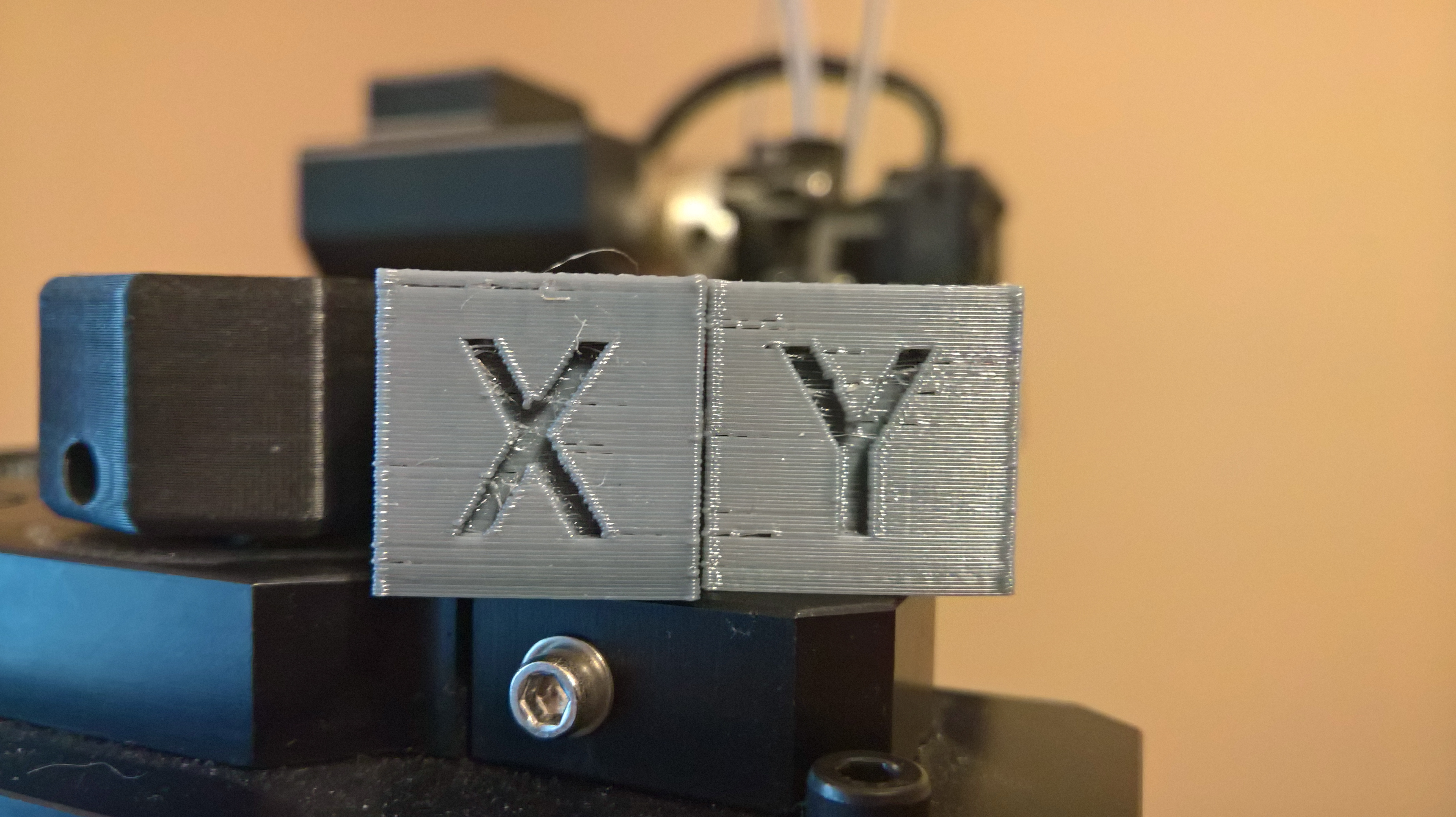

The second problem can be seen in the picture below. I have small gaps in certain areas between layers. I've been playing around with print speeds, temperature, and cooling but I've had no luck. I'm wondering if this may be retraction related? Or a symptom of only having a single perimeter?

Starting height is key, that old list of settings says to air print it.. NO, calibrate your nozzle with the a single walled square so the starting height is correct.. a 2mm tall wall should be 2mm when printed. I can post the method of altering the z offset in the firmware (really easy) if you are not already familiar with it. PETG needs no cooling.. turn off the fan if you are using it.
I have linked to a factory file for some hold downs I made for my garden, I am using the .35 nozzle and eSun white PETG on the M2 with S3D so should work for you. EM may need to be tweaked by .1+- assuming your filament diameter is the same as mine..
Another thing to look at is your filament tension.. the PET is harder than PLA. Extract the PETG and examine the marks the extruder gear made with a loop or magnifying glass.. PETG need a bit more tension than say Makergear PLA. If MG PLA is set correctly another 1/8 tighter for PETG..
